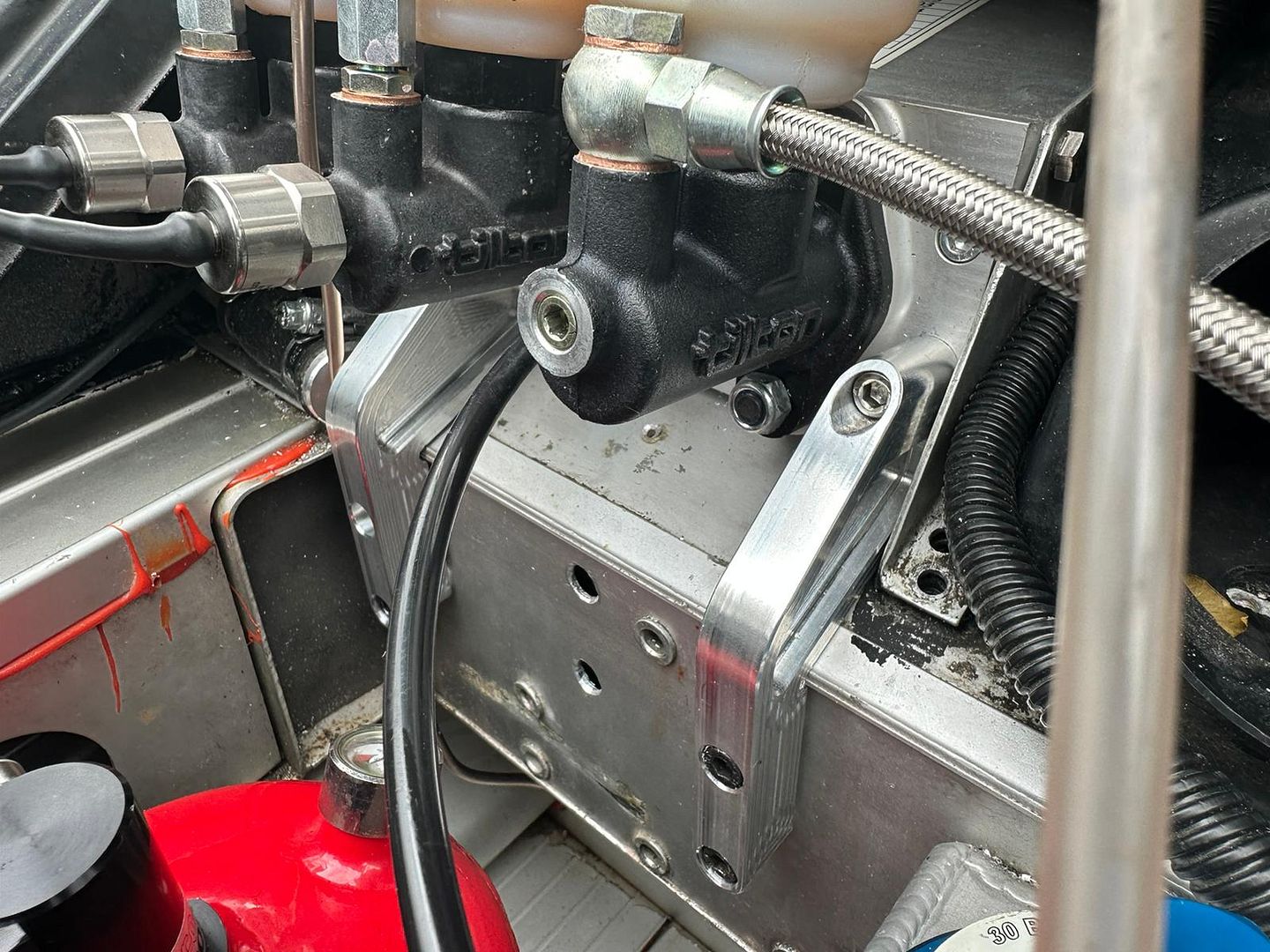

#So after removal and refit of the pedal box there was a surprising amount of flex when the brake pedal was pushed, not ideal! Darrens solution, add Billet! there are 3 braces, now removed to be anodised.

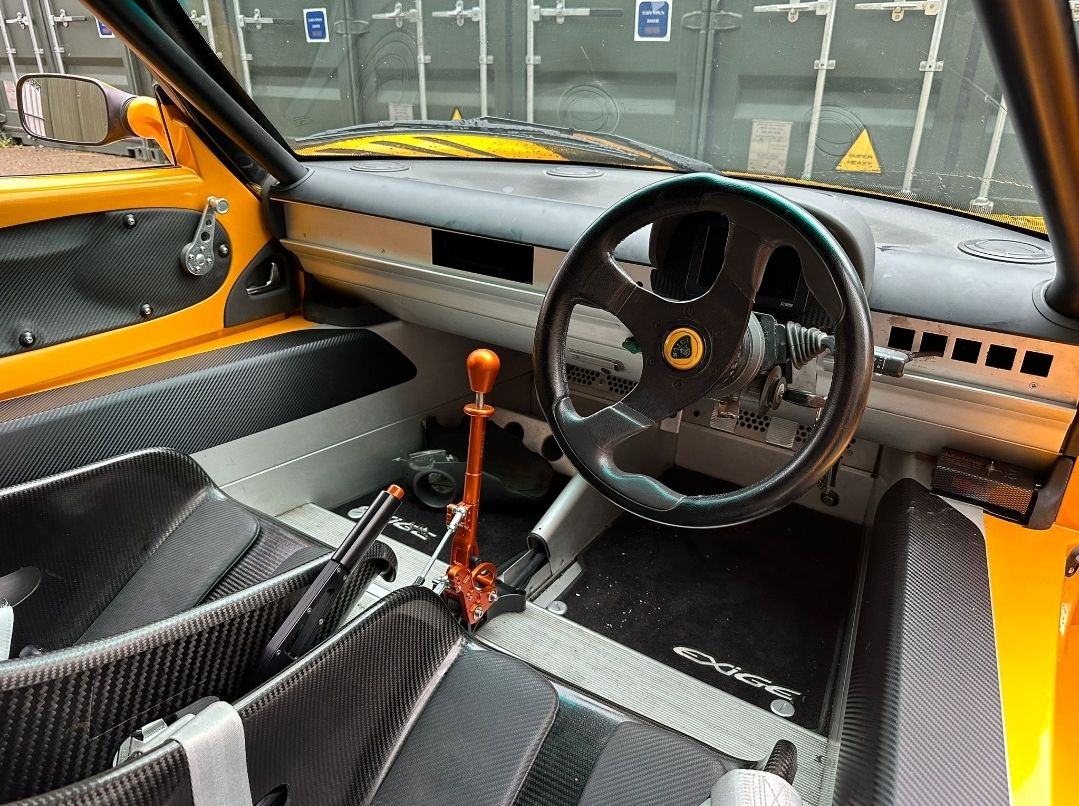

Dash brackets glued in, dash back in, will be fitting carbon pieces instead of the oe panels, cill protection stickers fitted along with no step stickers, couple of pics outside Silverstone :slight_smile:

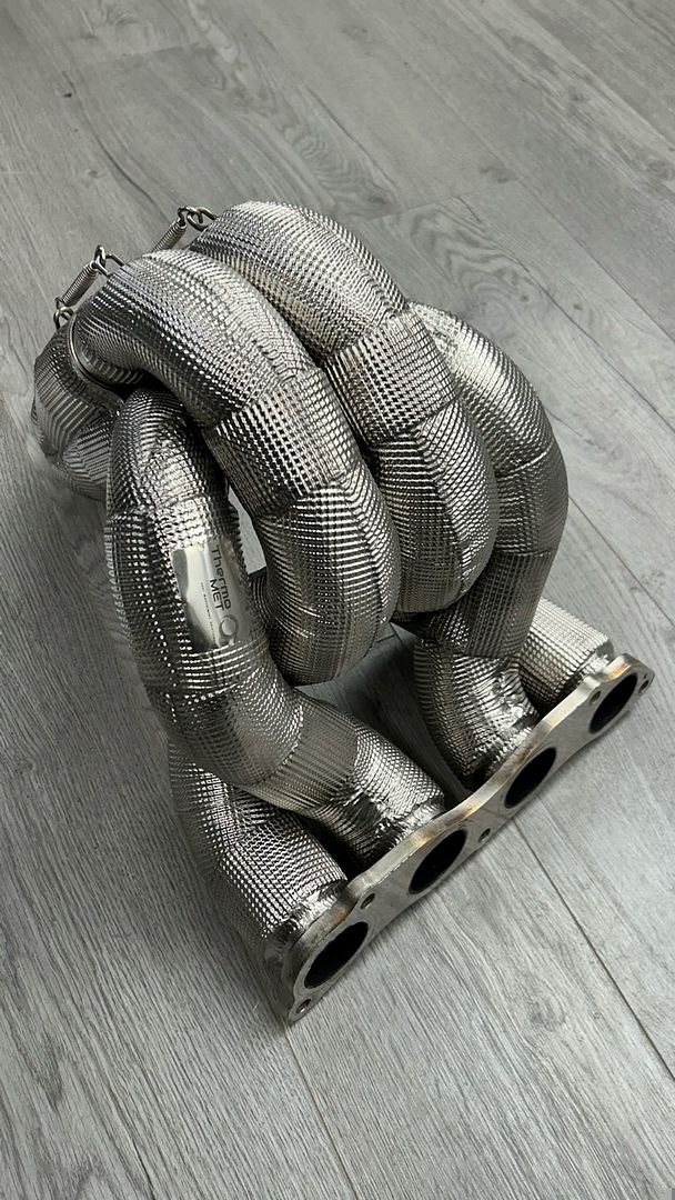

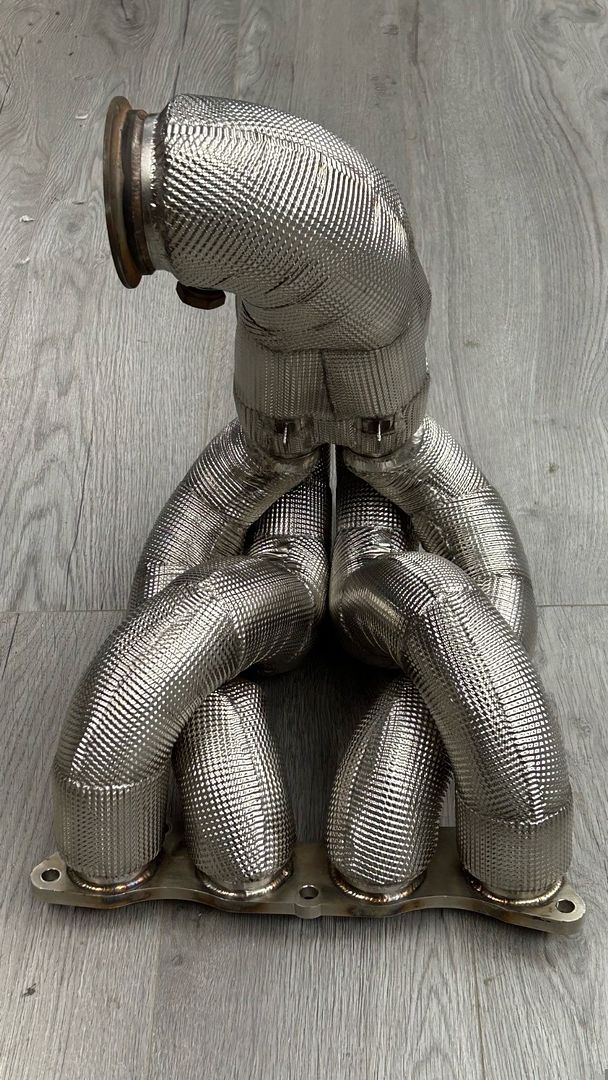

There’s always another piece of the puzzle, Darren is sorting the billet bits (of course) Pro Alloy will make the tank and put it all together, plus had the manifold heat proofed…
Look at that manifold!
Can’t take my eyes off it. More updates and info, please

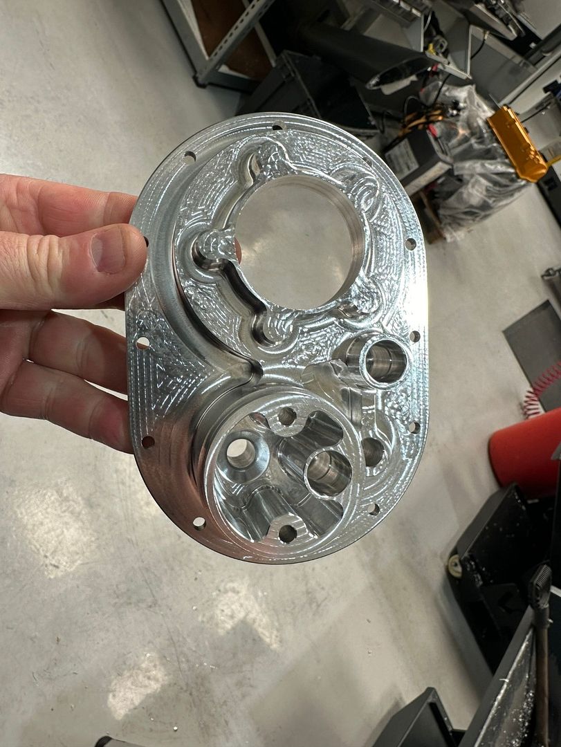

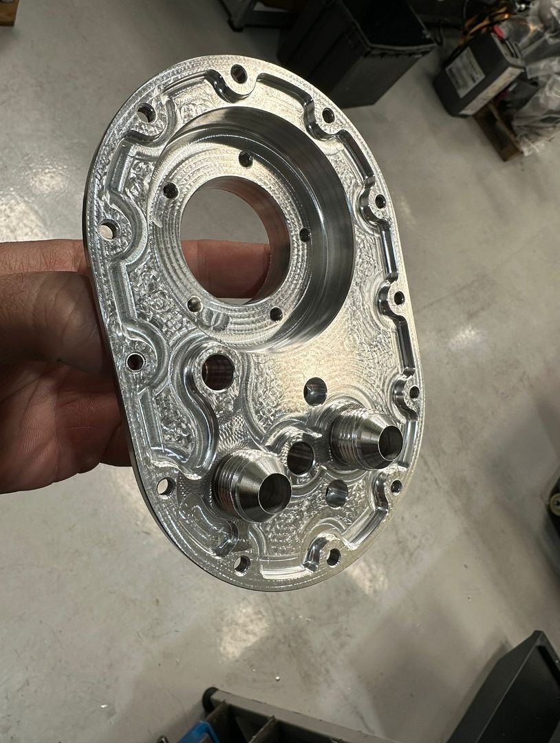

Top plate done…
Some proper work going in here.
