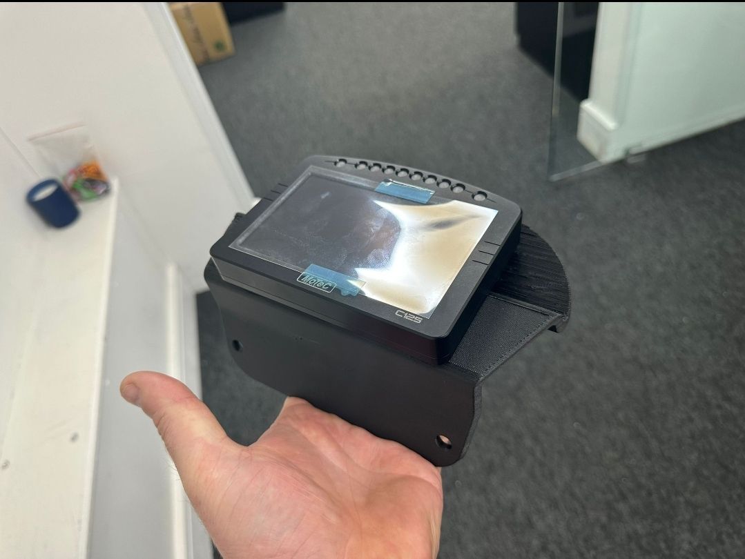

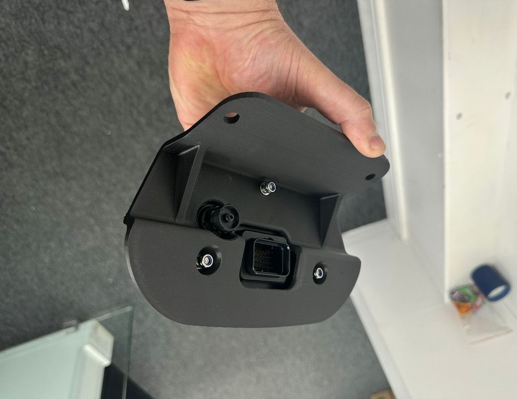

3D printed surround for the motec dash…
Top job there!

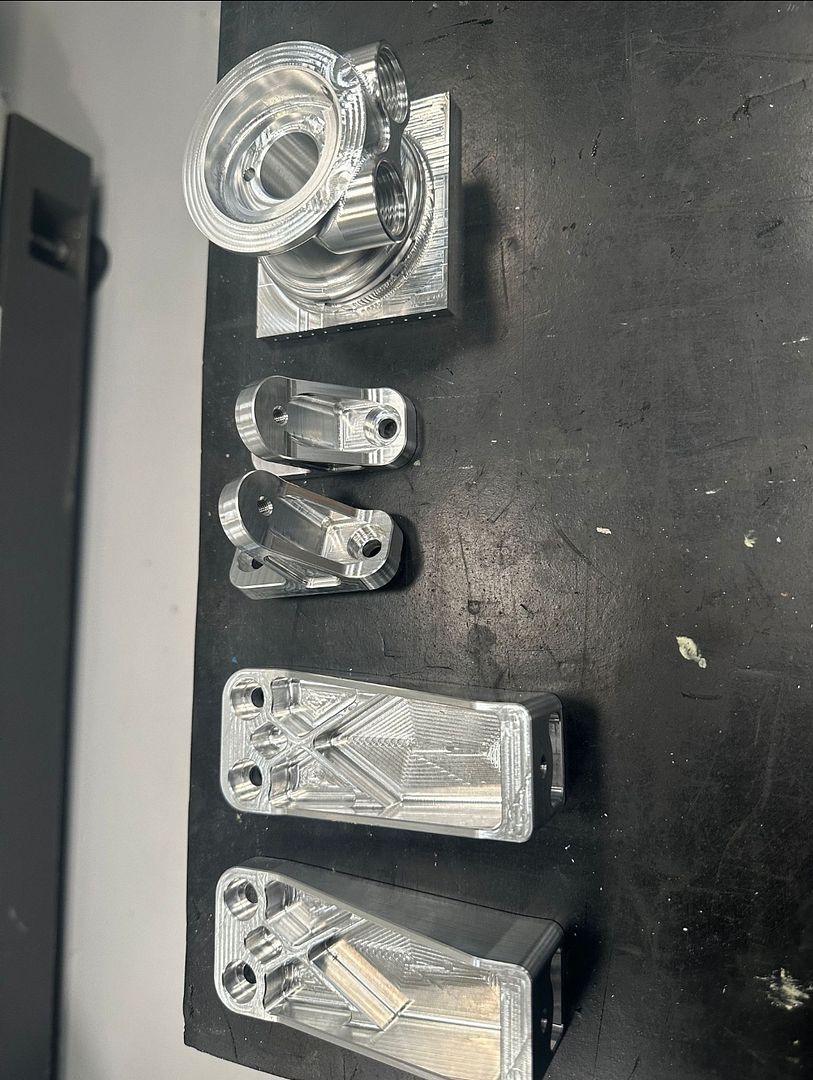

Darren just casually knocking uo billet exhaust hangers and a new oil filter take off, plus the striker pins on the toll cage have never worked properly never aligned very well so a new design for those…
