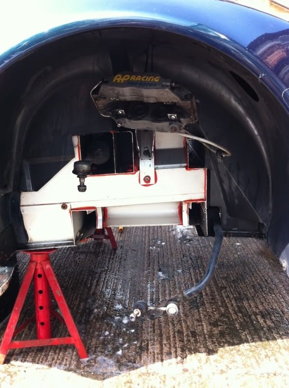

Stripped the car down…
And get some S2k wishbones and bearing packs…
New driveshafts…
The uprights are with Ollie at Phoenix having 5 mm machines off the fronts and some brackets made for the AP 4 pots.
I have new AP 308 discs and a couple of sets of team dynamics on the way too. Wishbones are currently at the powder coaters, not being done black :wink:
Once it’s all bolted back together it’s off to TTS fir a significant power increase :wink:
Marc.

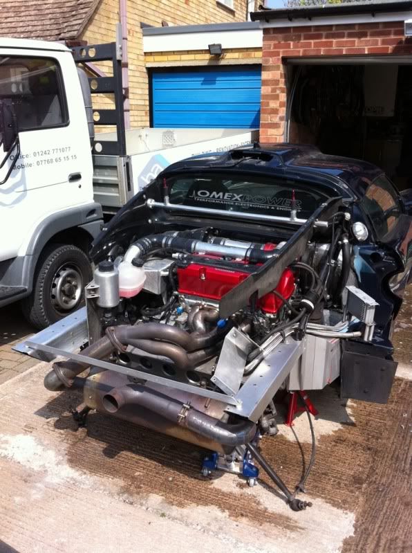

Clam off…
Clean up the chassis…
looks good…
definitely does - did you use anything special to clean the chassis?
I used some degreaser, and some autosol with very fine wet and dry paper. Will spray some acf-50 on it all too before reassembly.

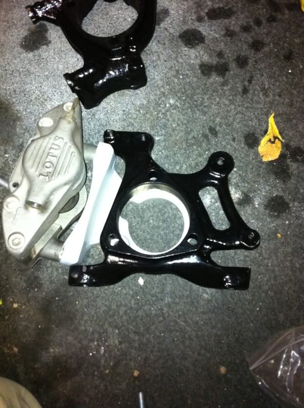

thanks to ollie at phoenix i now have my s2 K modified uprights back complete with brackets to take 2 pot brakes on the rear…
What is your plan for the handbrake?
Retain the original calipers.
Not an “elegant” solution, if you don’t mind me saying, Marc. Seen it on another car…
Nope not elegant, the standard rears are ugly buggers already!!
Handbrakes are for girls!!!
This is my plan until I can find a suitable small reliable handbrake caliper and get a bracket fabricated for it.
I realise it is not very attractive and you still have the weight of the caliper there but having an S2 with ABS means I can’t run easily run hydrolic handbrake
get some carbon wheel chocks made instead? No? ah well
Nice idea just a bit awkward at traffic lights :wink:
Hydraulic handbrake wont affect the ABS matey.
