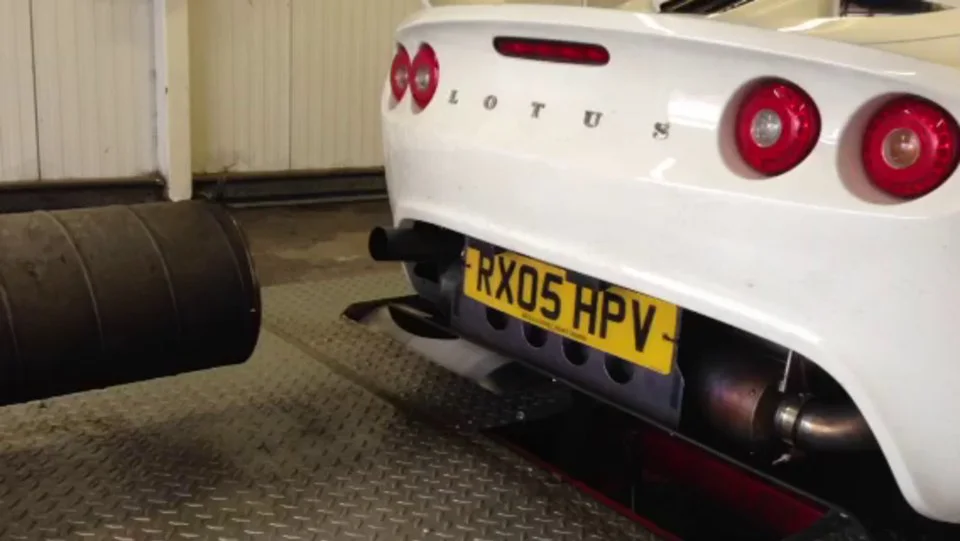

Quick video from earlier today.
Mapping the flat shift and blip down shift for the Quaife QKE9E sequential gearbox.
Manual change but the S6 syvecs is controlling the cut and blip stuff.
This was halfway through the mapping
We finished at about 4.30 pm and only got the open loop gear control finished, Will be back on the rollers soon to sort the closed loop sidw of things.
Many many other things to look at inc high lift cam control, we think there may be more to come from that area.
