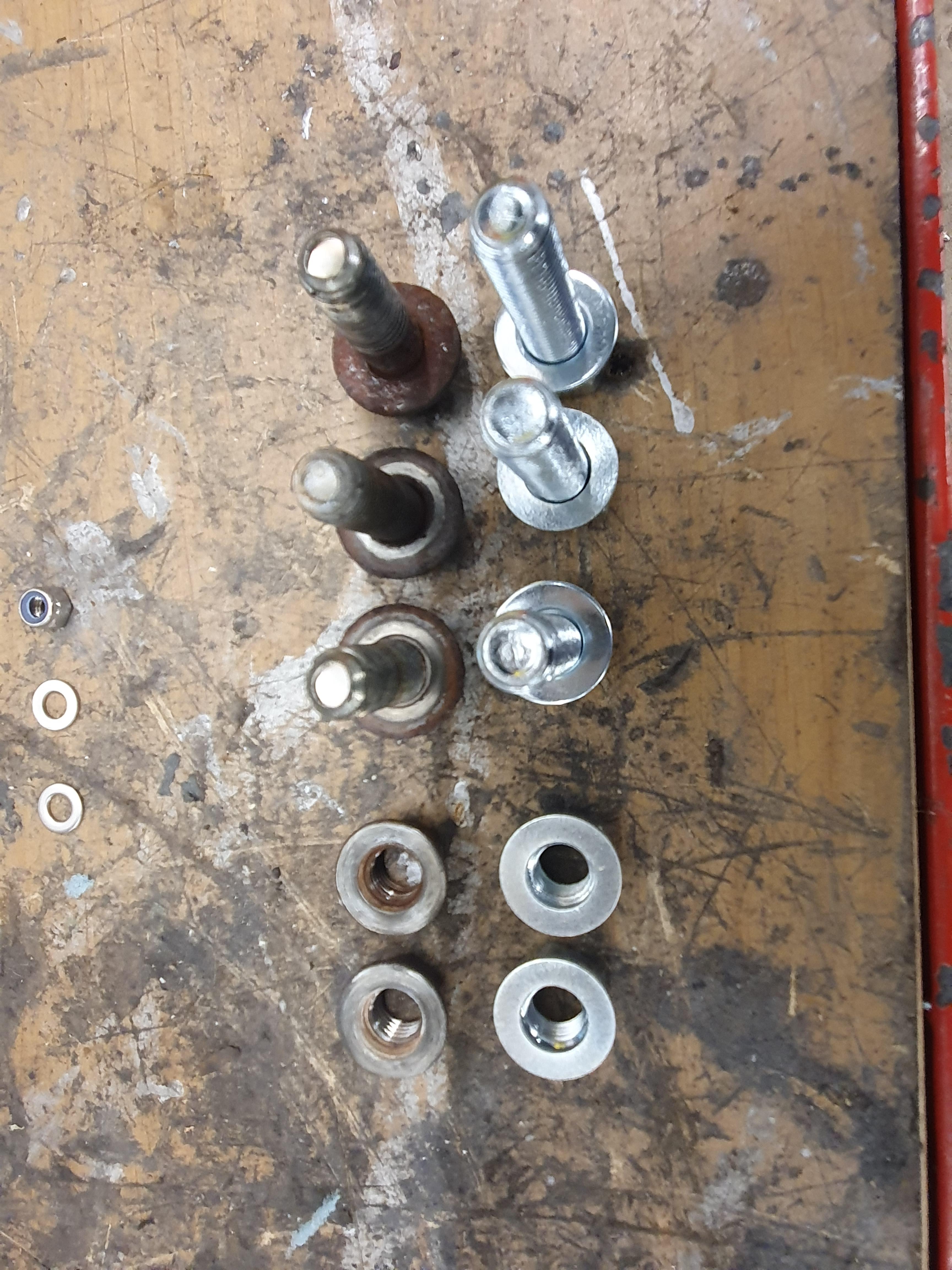

Old Vs new lift bolts, not much wear on them but best to replace with new.

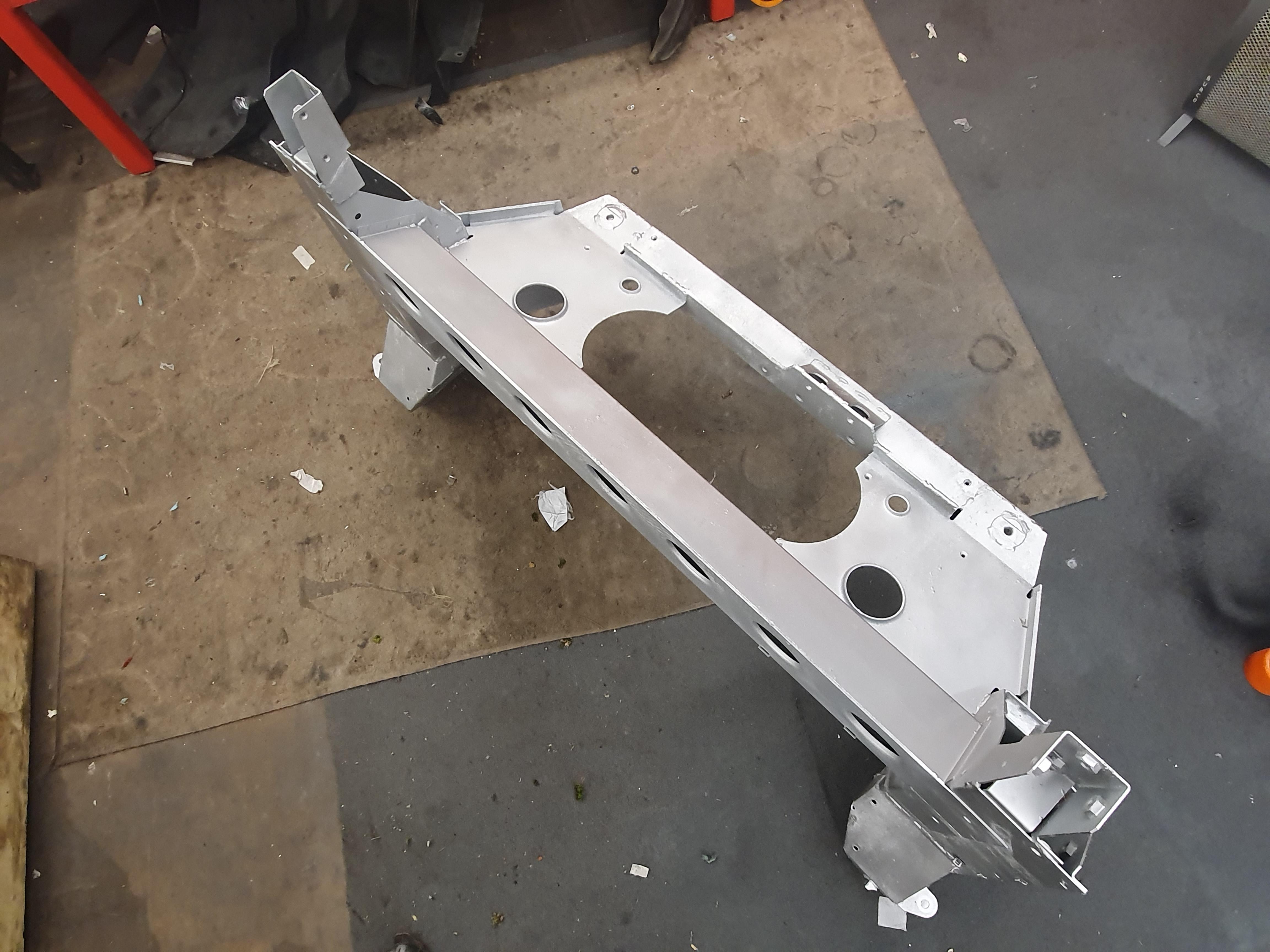

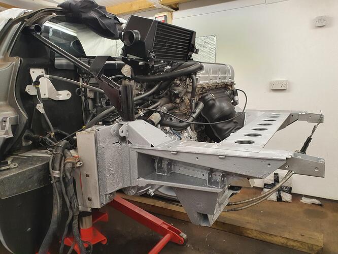

The subframe has been chemically cleaned, the 2 coats of zinc galv stray and top coat rustuleim
Both chassis and shims has been coated with anti seize compound to keep the chassis corrosion free
Brand new bolts have been used, to fix the subrame to the chassis.

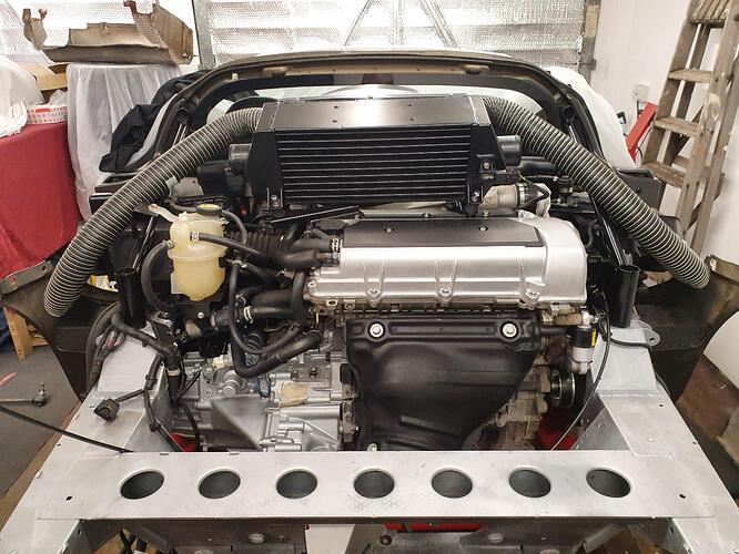

The pro alloy cold air intake shroud fitted to the intercooler, it fits really well as the car came with the larger cooler already.

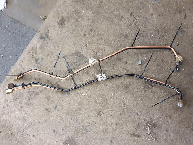

I manufactured new rear brake pipes made, flared and with new contectors. Pre bent to original shape.

What tool did you use to cut the holes for the cold air intake slots?
Cheers Mike, i bought the full pro alloy intake kit it comes with the shroud.

Dry fit of the pro alloy cold air intercooler feed and i think it looks really good. I do like pro alloy products
