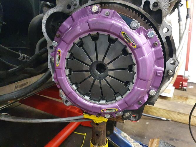

Going to put my existing one back on, after taking advice and looking at all options i dont want to takeaway any of the road characteristics. I just hope i have not gone too far with the ceramic clutch and i am told this type will be fine for road use and not squeal. However i can just get the a organic plate separately if so desired and swop.
Yeah fair enough. I had a ‘segmented’ clutch (or whatever they’re called) on my Subaru and it was a bit grabby at first but I soon got used to it.
The Extreme clutch went on pretty straightforward and even came with the alignment too.

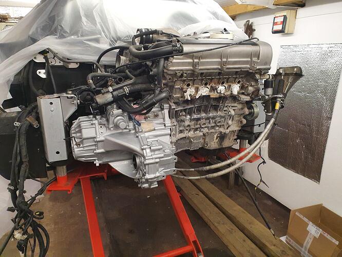

Now the box is in i can lift the car up in the air
