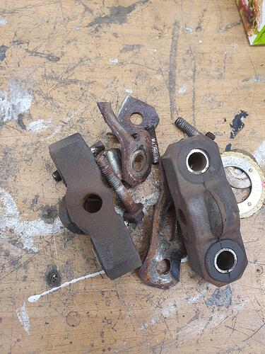

Small update, made these for the front suspension shock top mounts out of a nice piece of alloy shaft, it will be months to i need them but had time to kill while at my dad’s :rofl::rofl::rofl:

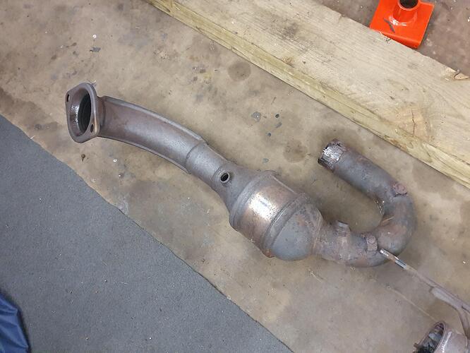

Finally i got the exhaust off, again im sure its never been off since new, cut, grind and fight on with all of the bolts, not one came off as it should :imp:

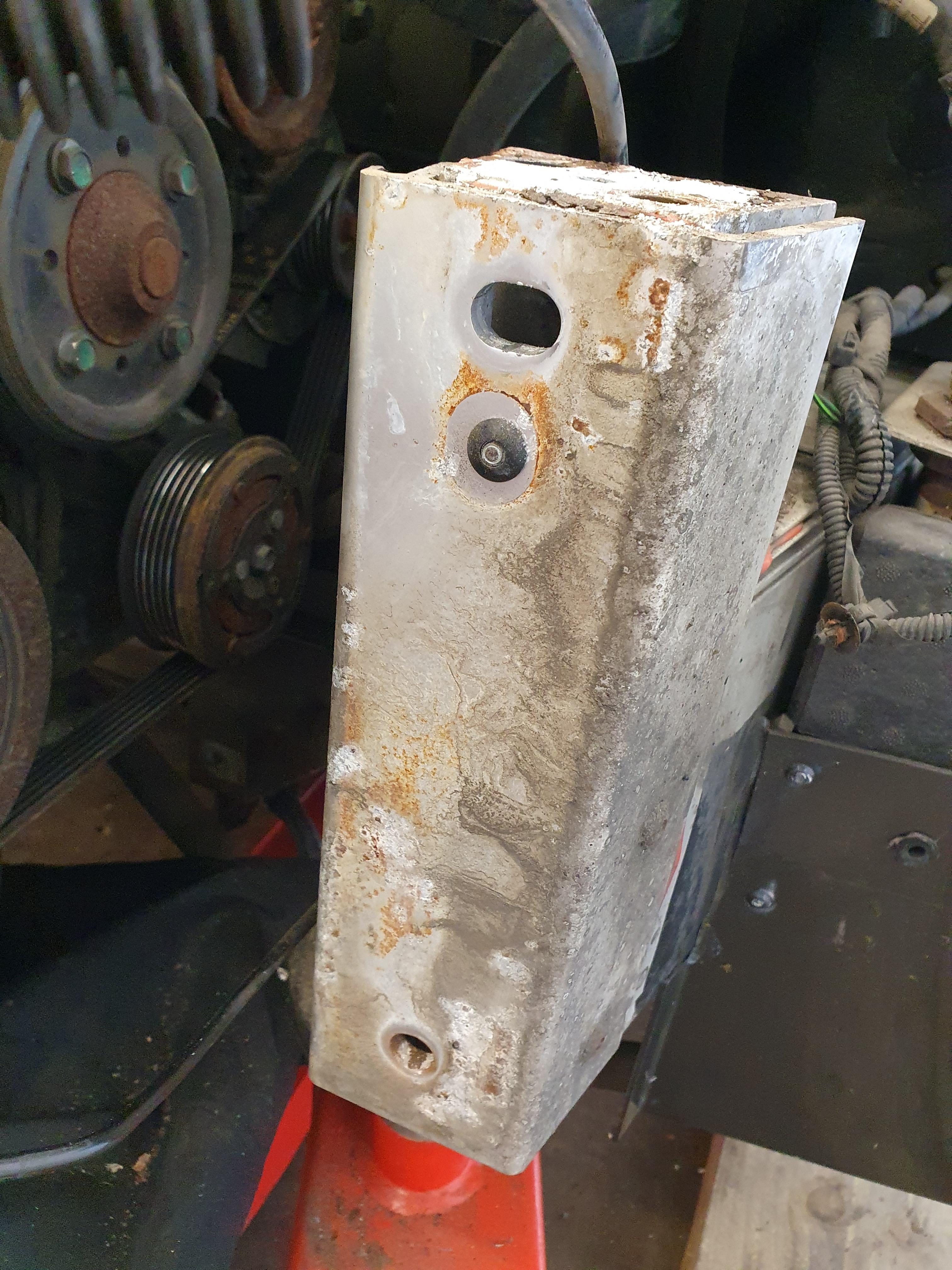

Pretty straightforward to remove the subframe, getting this cleaned up and looking new again will really transform the build.
The chassis to subframe mounting points are in pretty good condition too, this is always a worrying area as the chassis can corrode quite badly.
