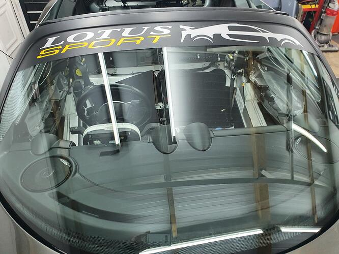

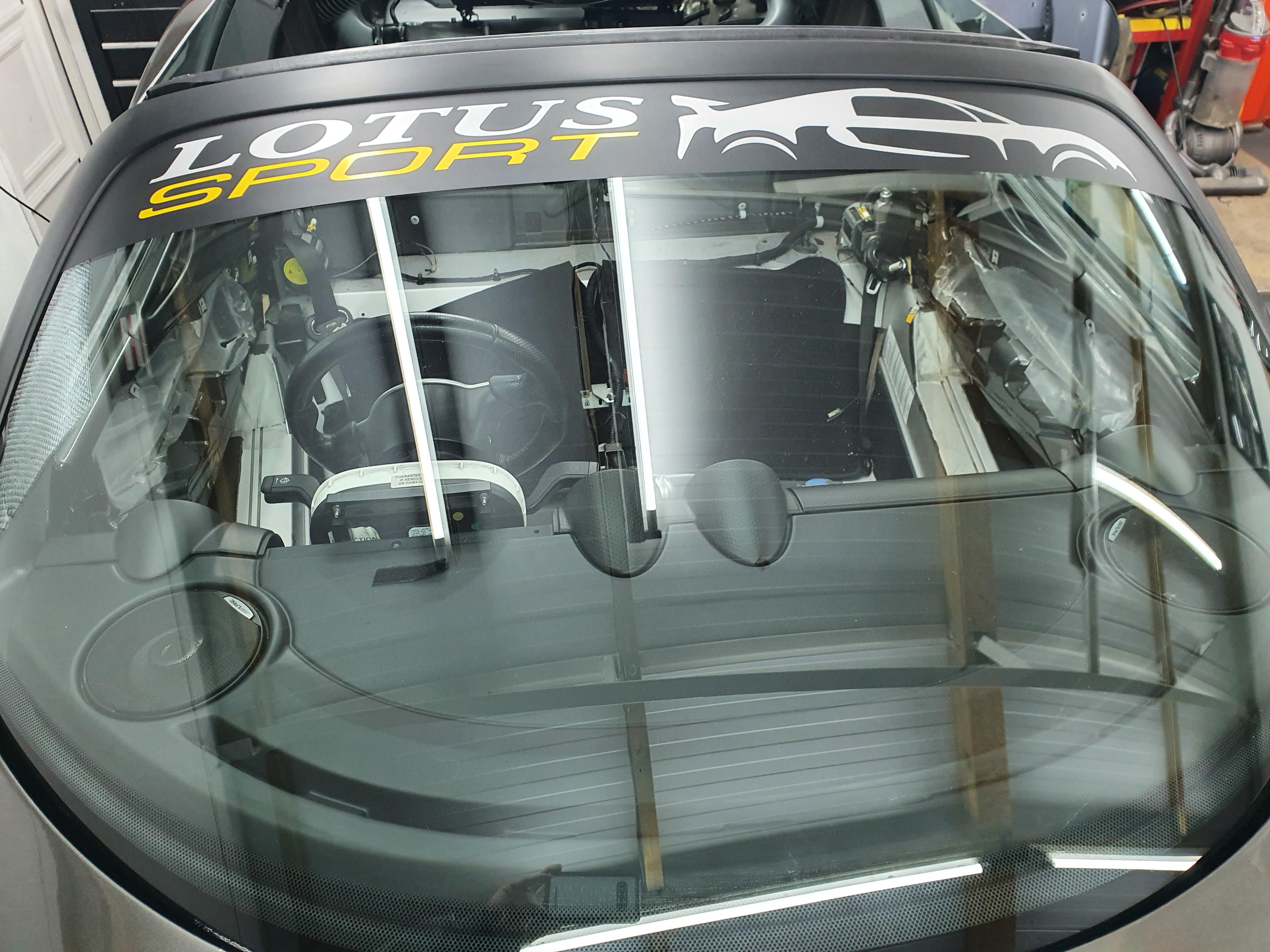

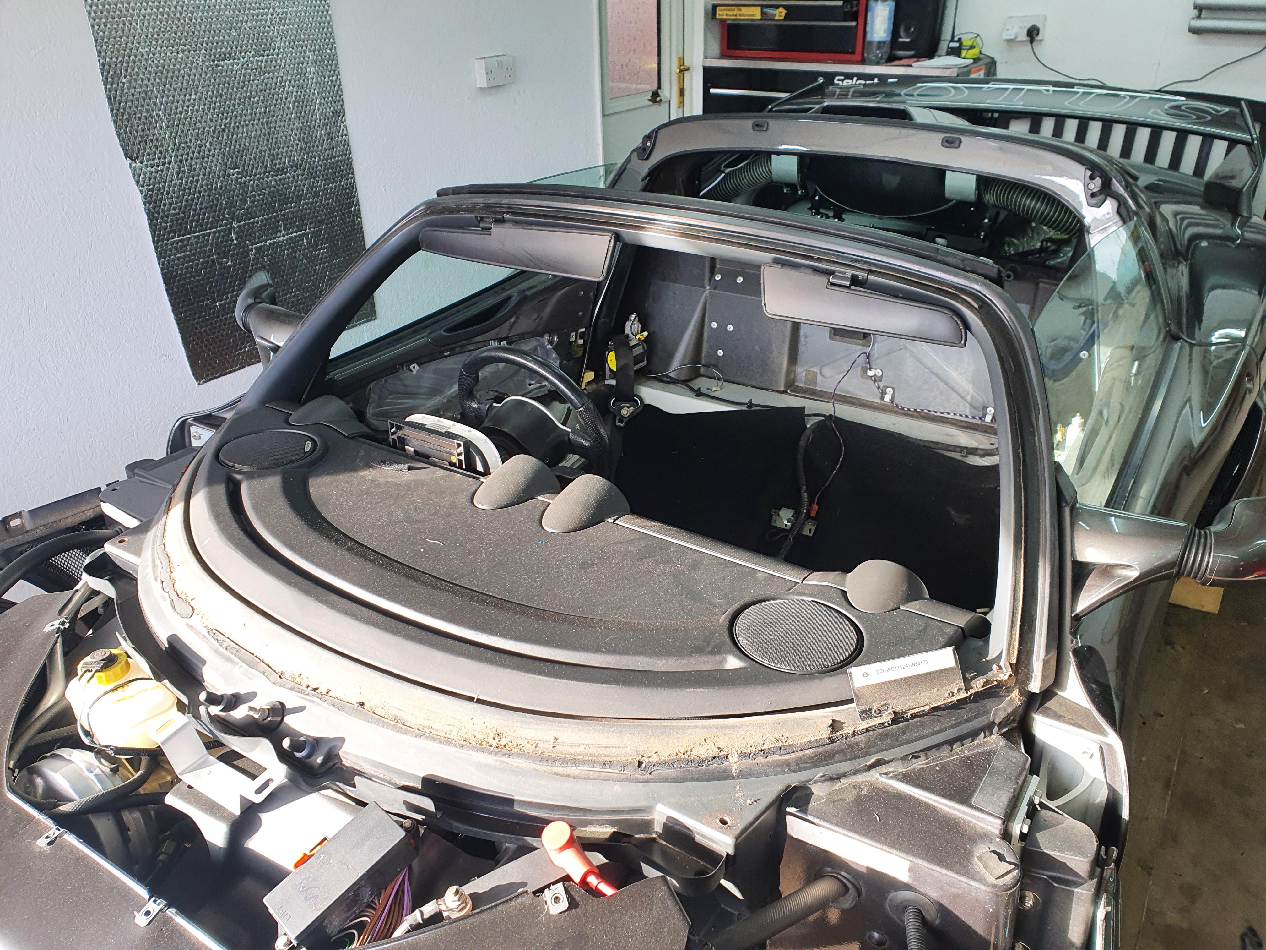

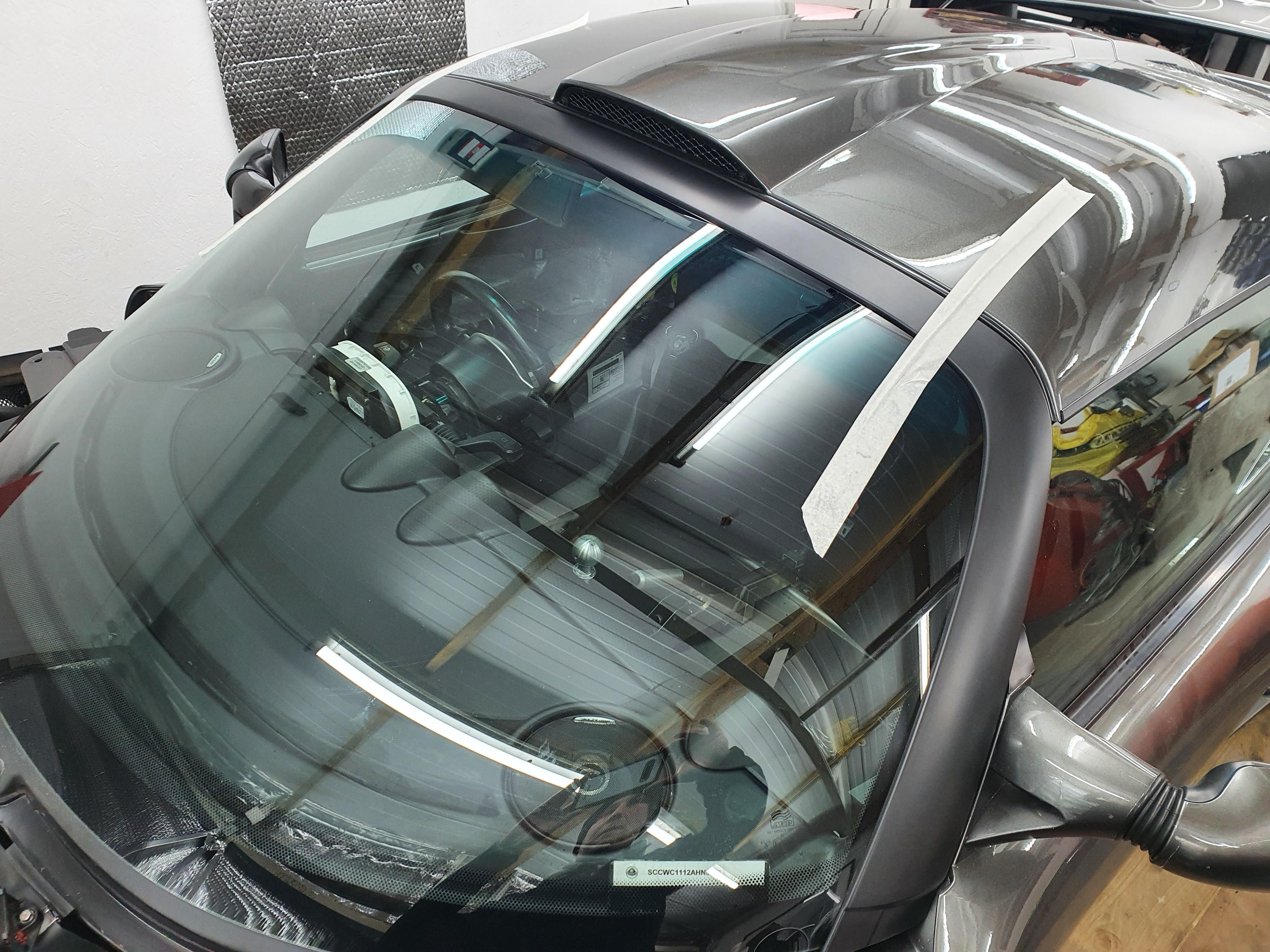

Finally new windscreen day, the chap from Auto windscreens did an amazing job. Cant beleive how scruffy the old screen was, it really gives a new car feel.
Now on with the front clam :grimacing:

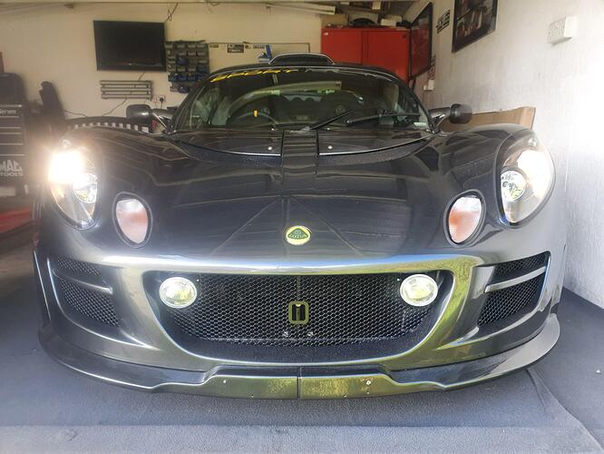

Pretty good weekend in the garage, clam fitted and i am happy with the shut line gaps, nothing worse than poorly aligned panels.

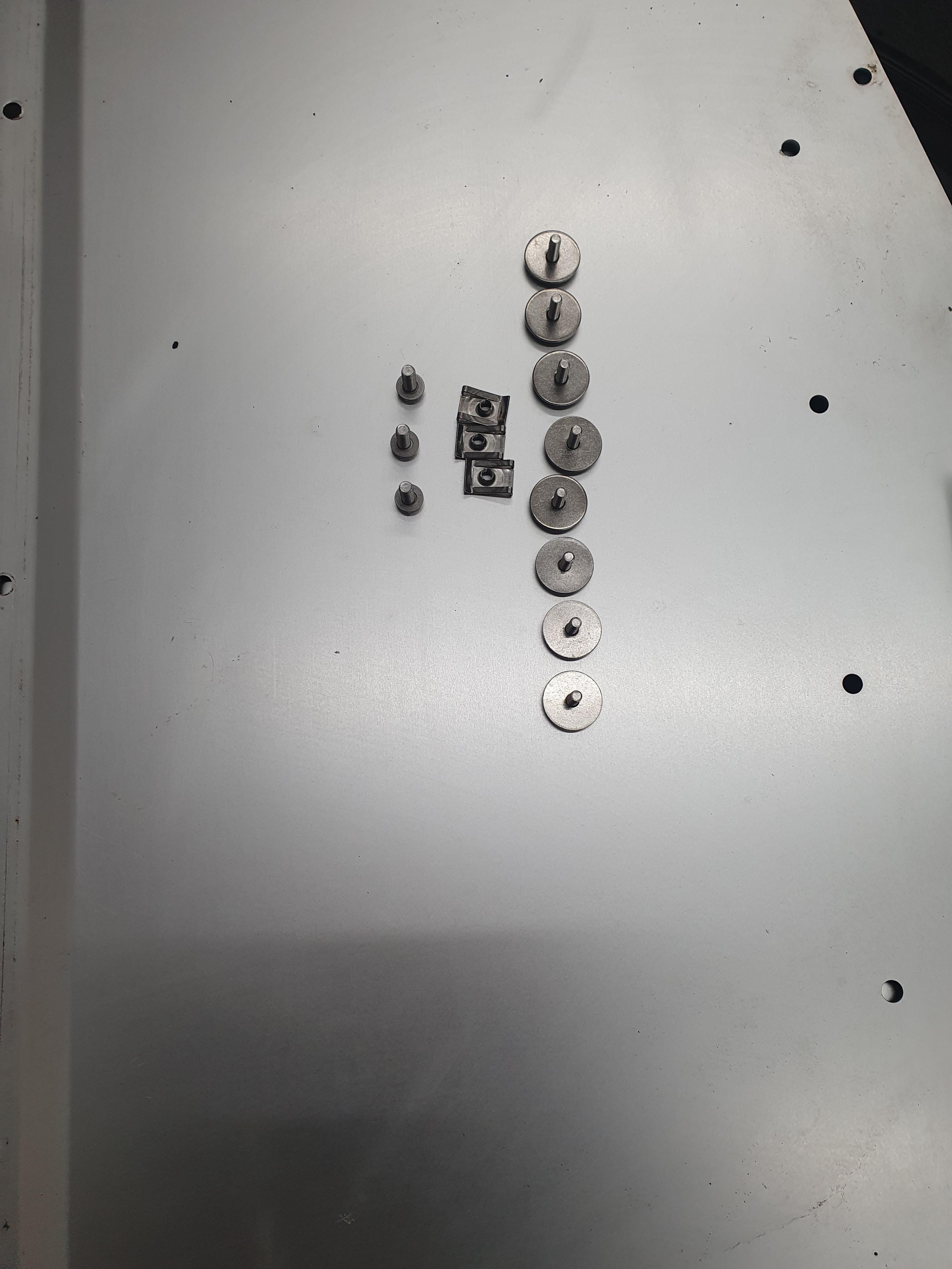

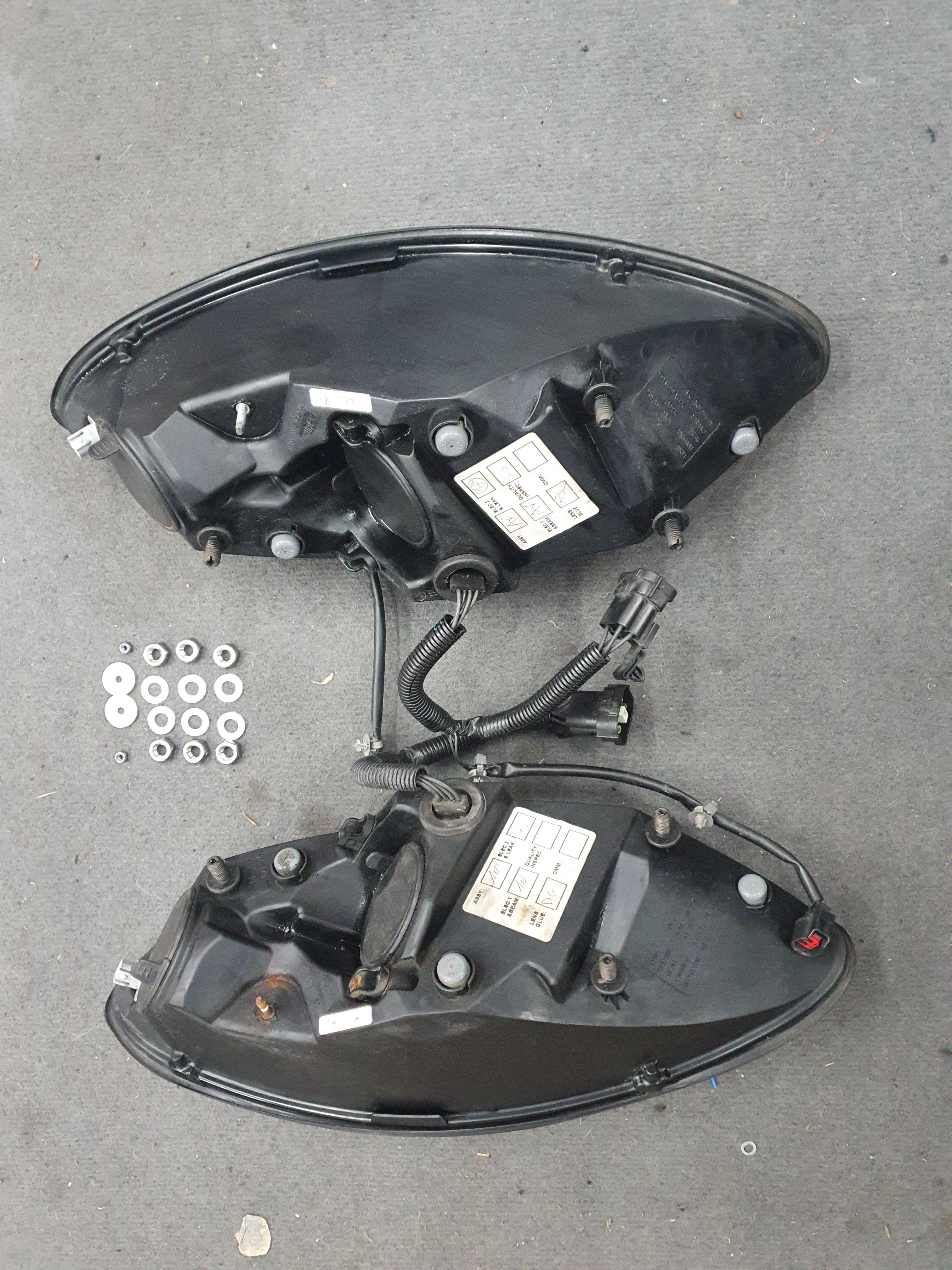

Headlights cleaned up and sourced original stainless half nuts and washers.

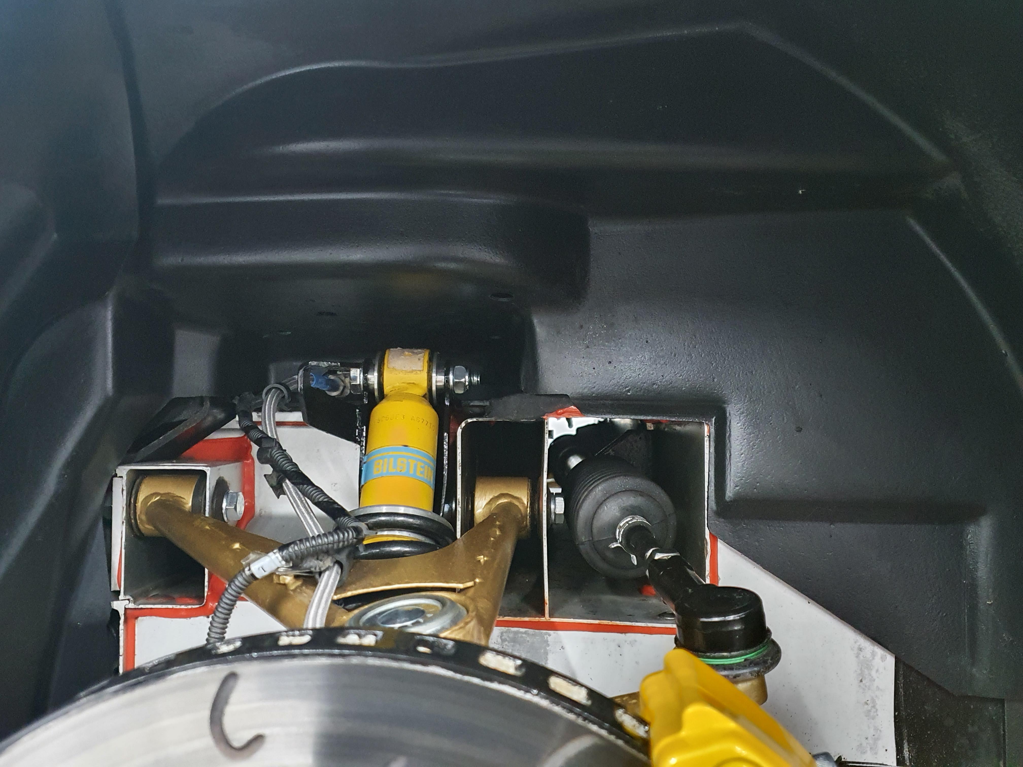

All wires and fixing nicely clipped up before the arch liners go in.

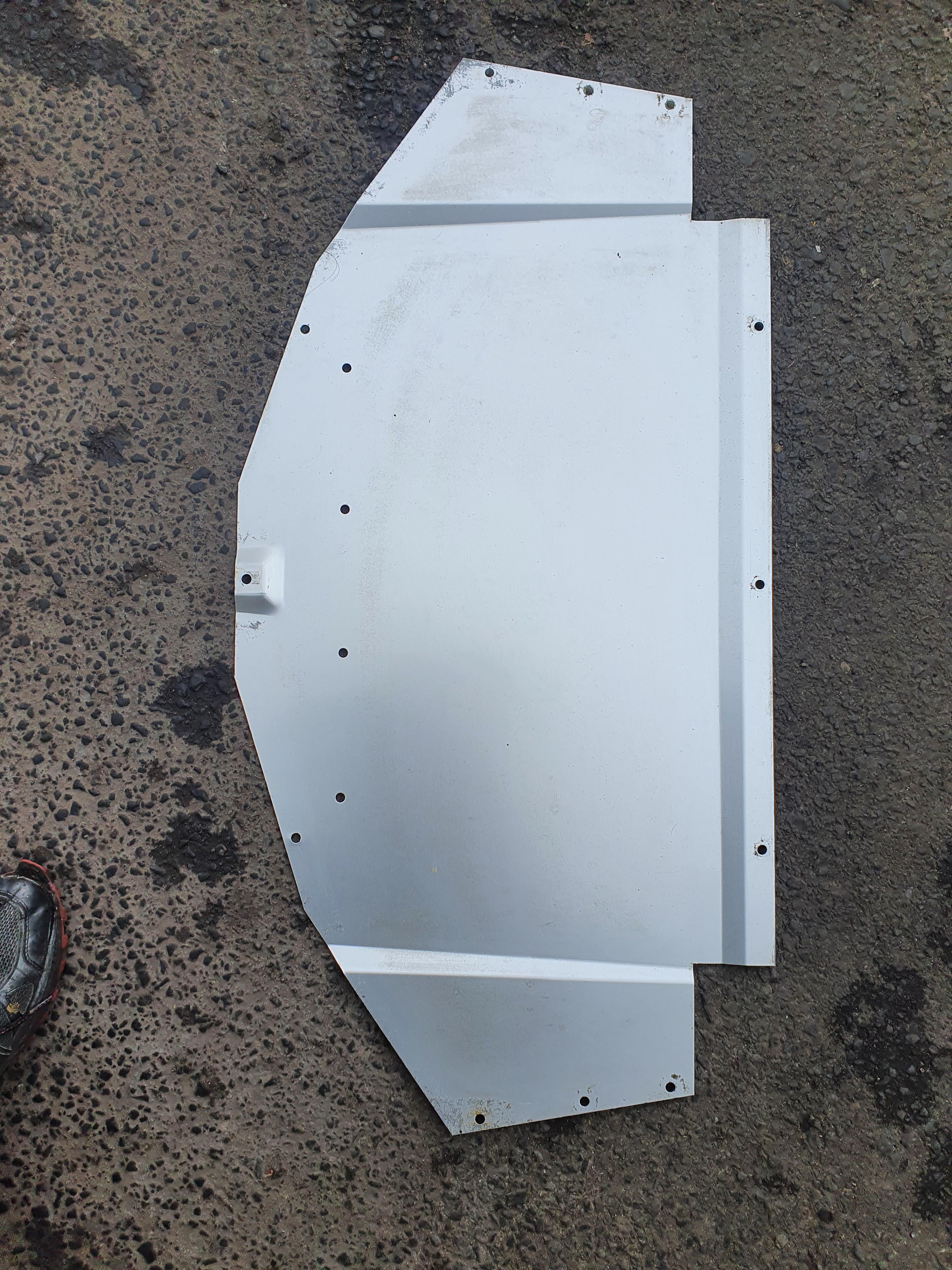

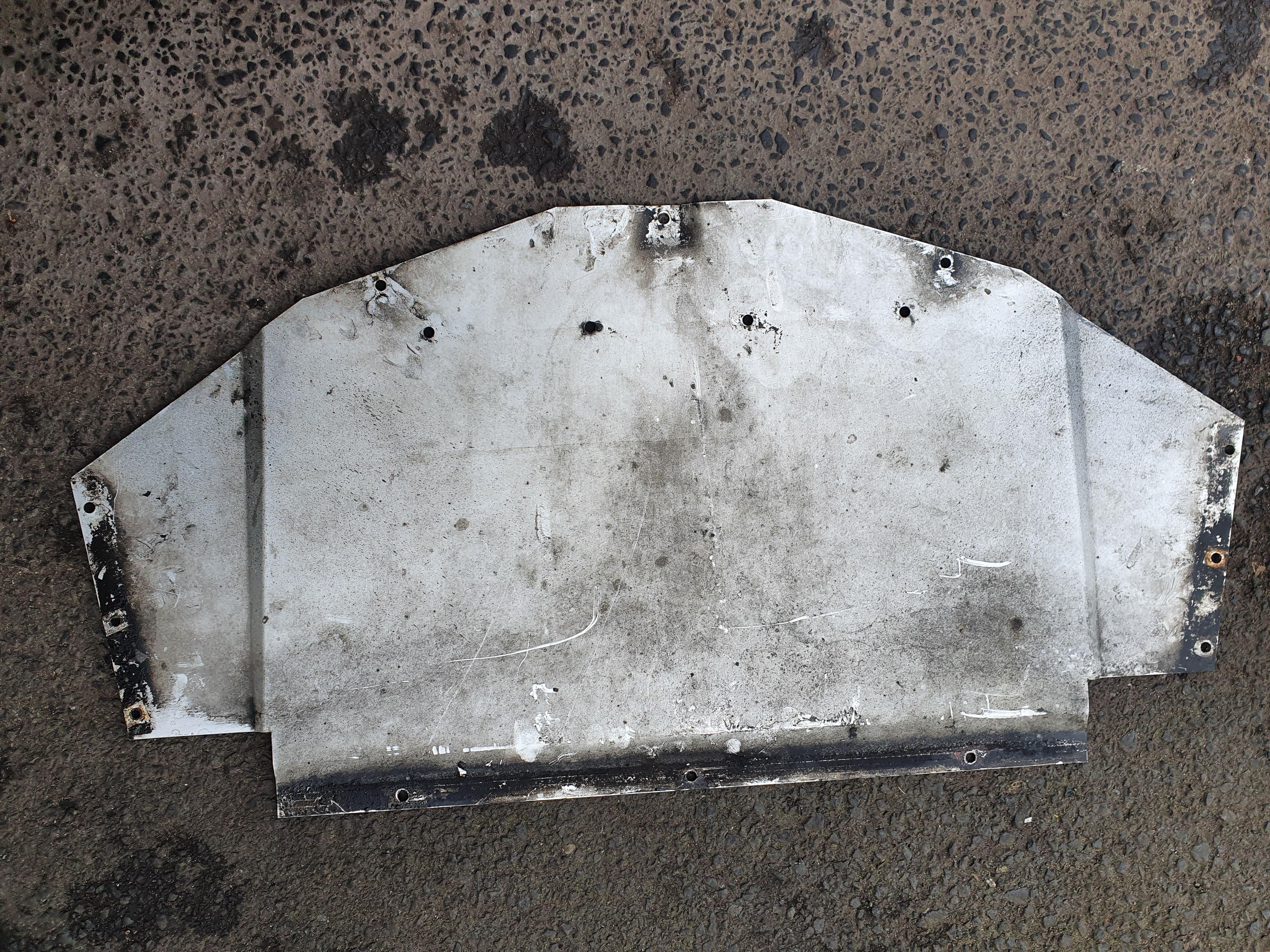

Front undertray before, looking rather tired.
Nothing a bit of elbow grease wont cure

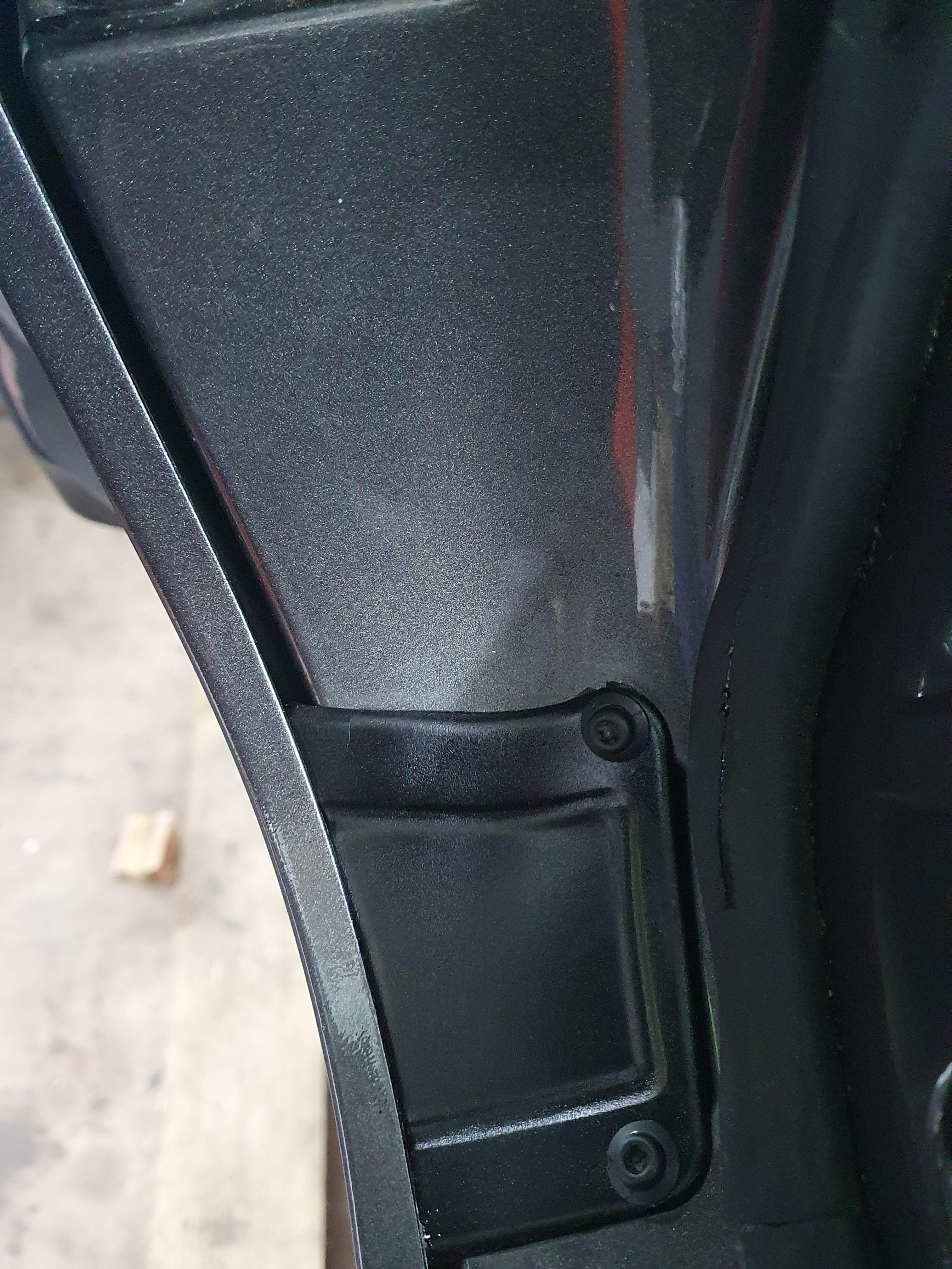

Stainless bolts, washers and also stainless chimney nuts to finish the job.

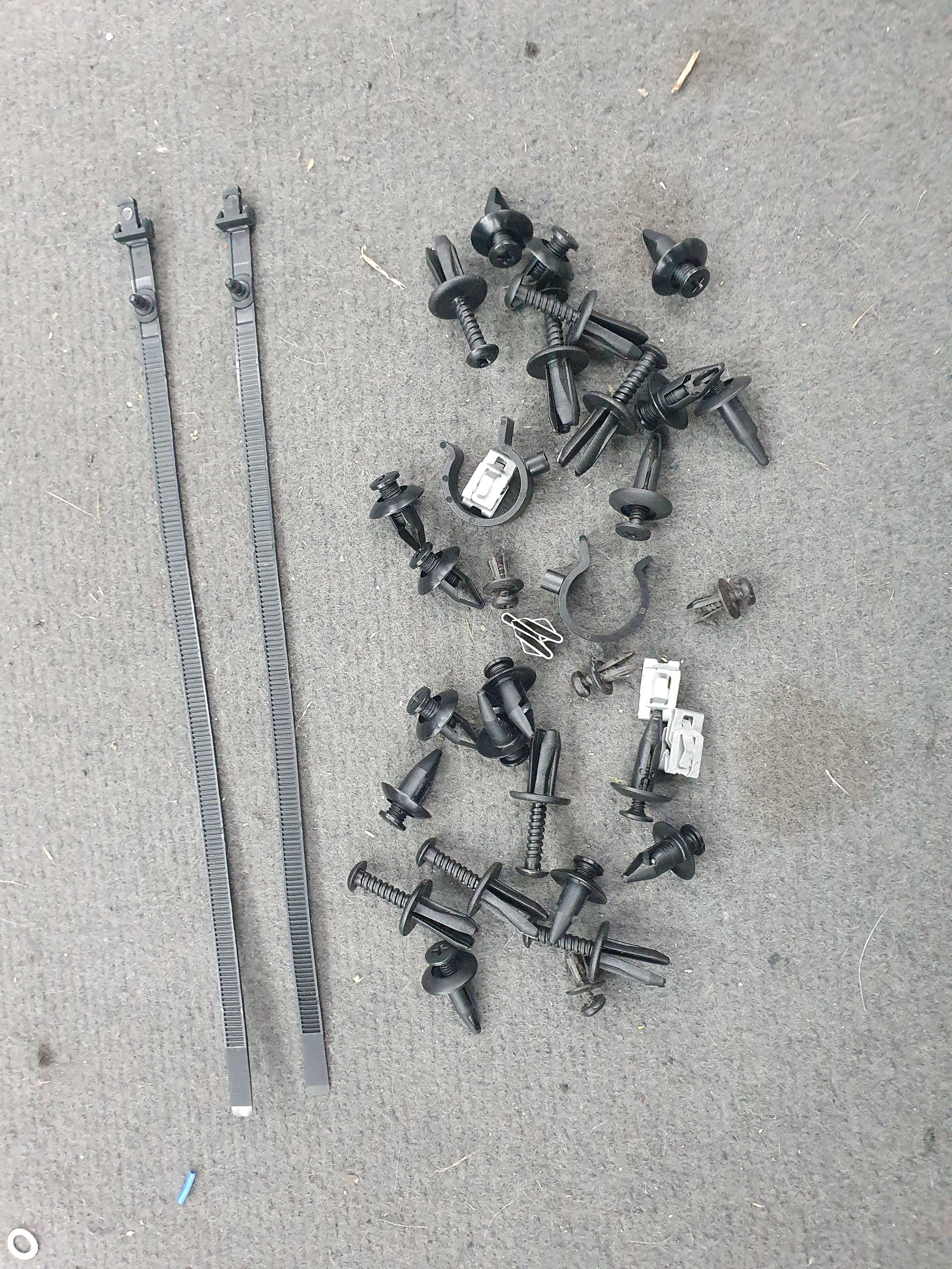

Worth the expense to buy all new plastic clips and fastenings.
Just finishes the job and gives a factory look.

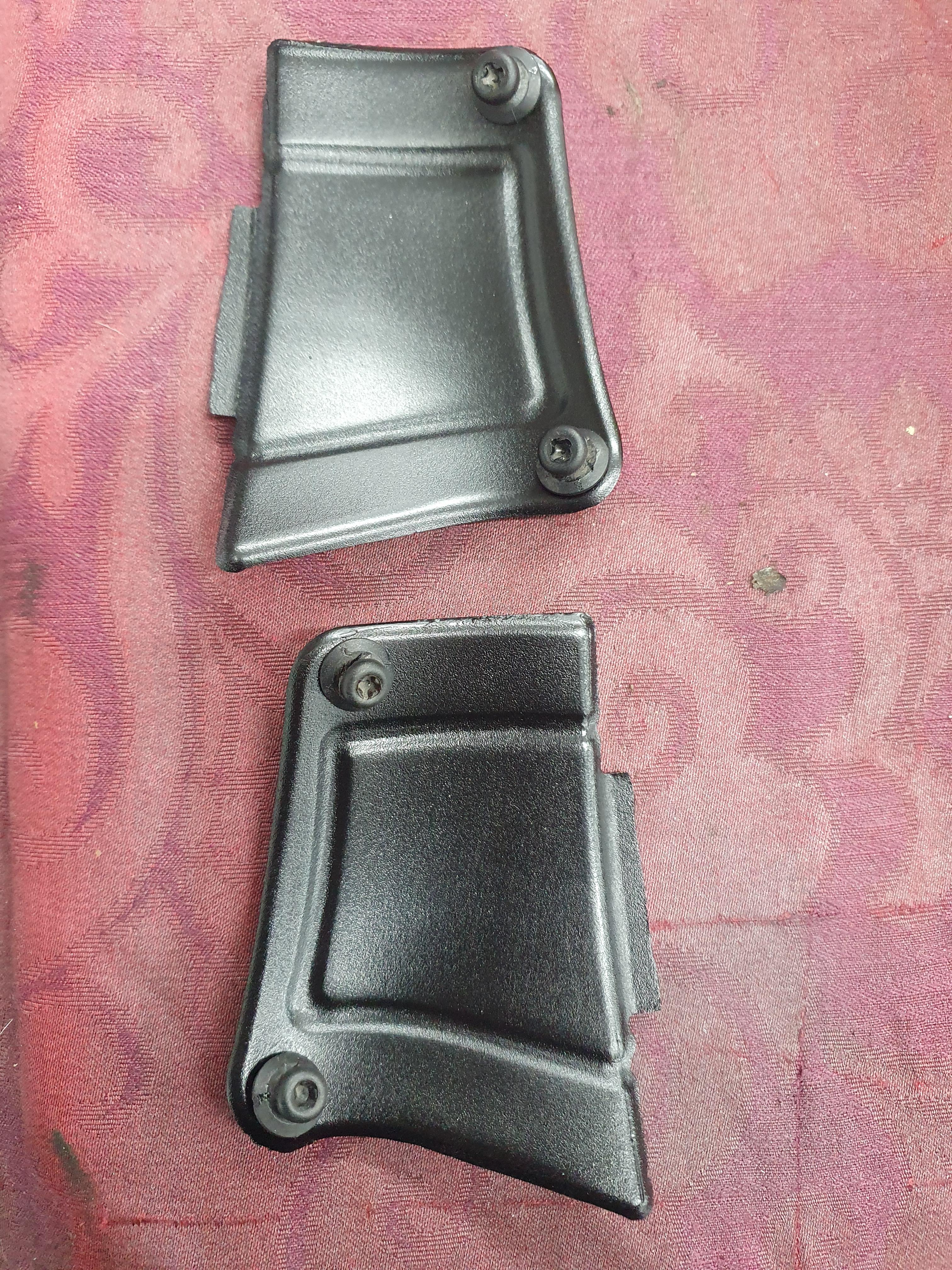

Clam side panels covers and fixings nicely freshened up with some plastic black spray.

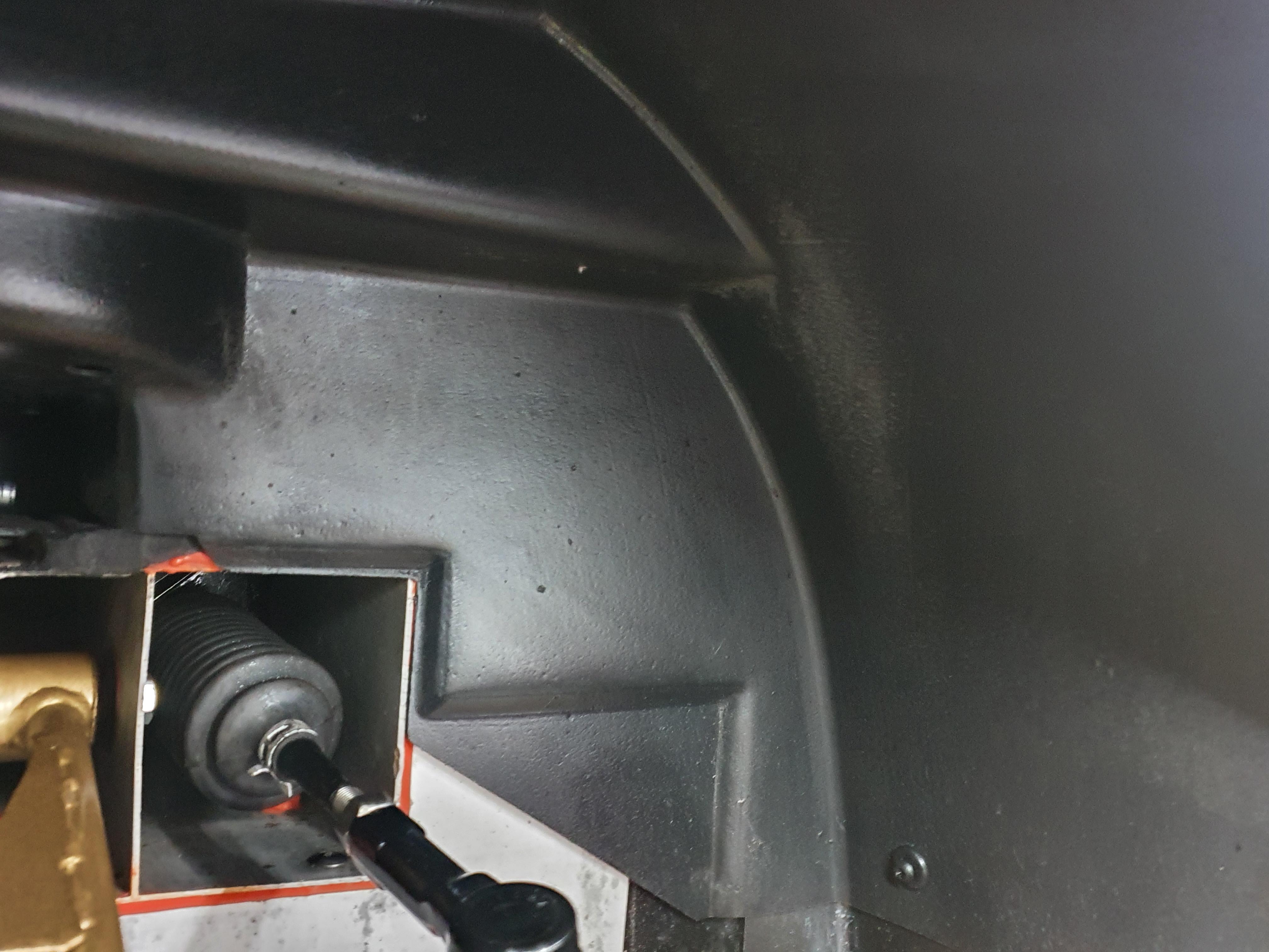

Arch liners in and polished up again with new fixings.
To complete the new windscreen i thought a nice geniune sun strip would finish the look.

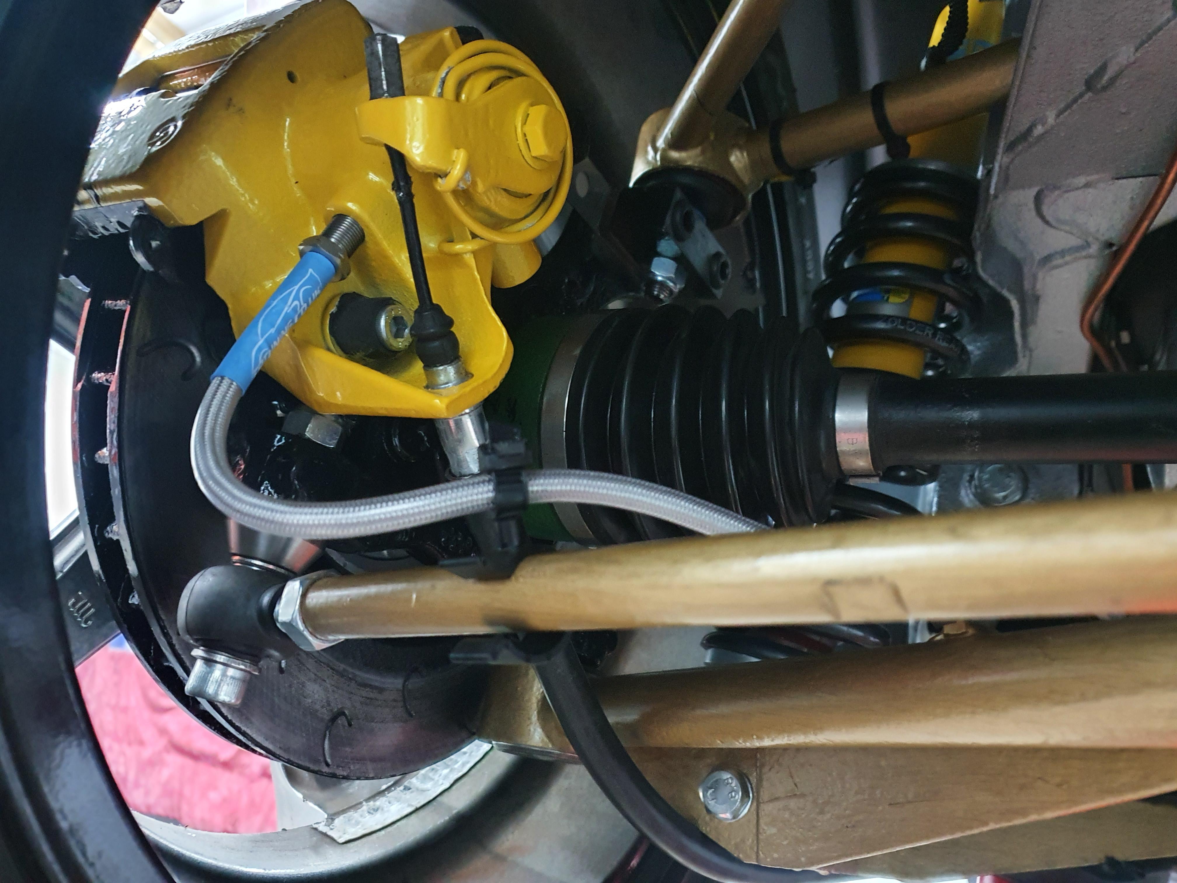

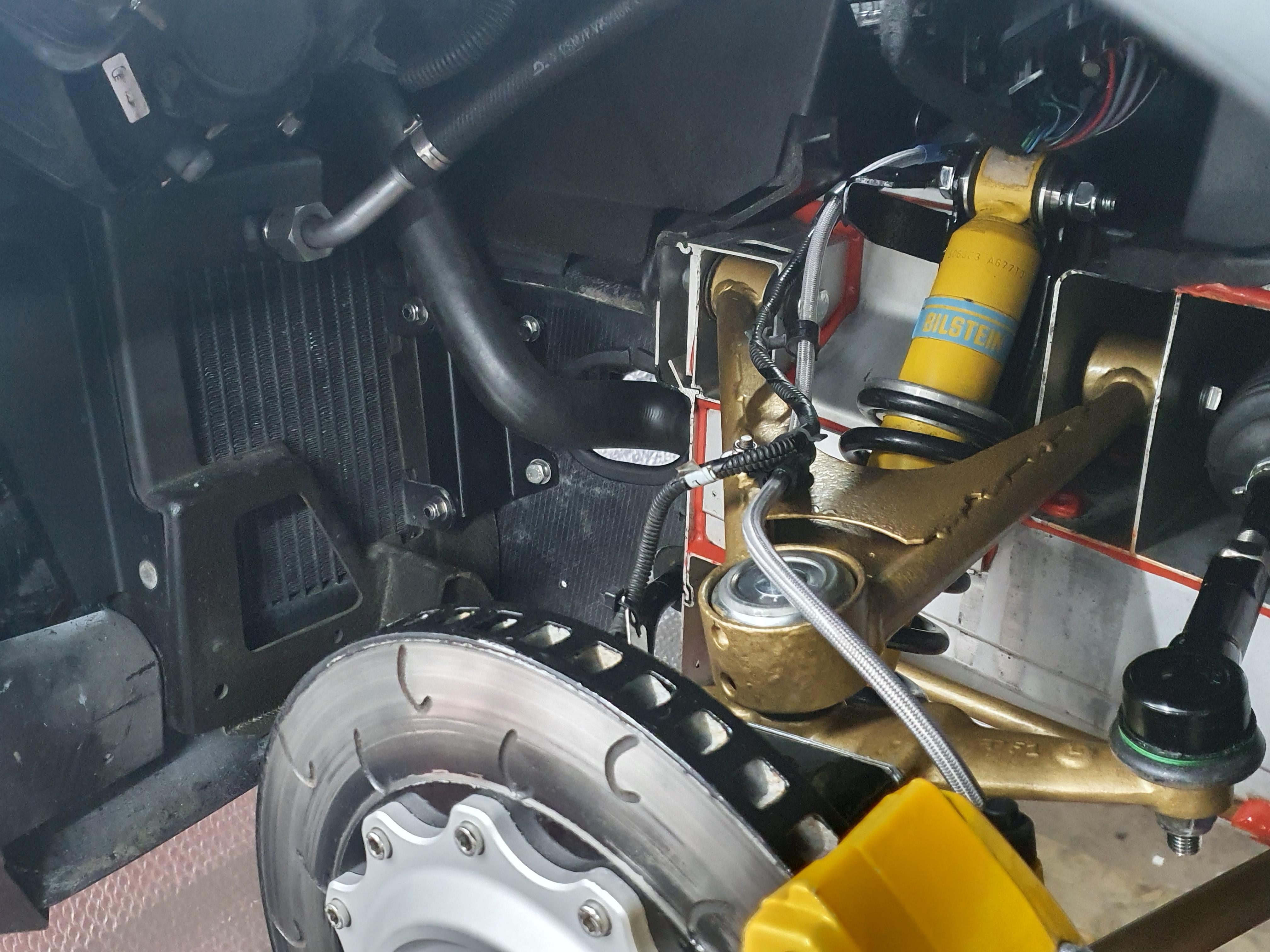

One job i was looking forward too was the camber settings set up. I have gut a Gunson camber guage and digital measurement tool.
Running std ride height and yet to be tracked but static set up with string and a metal ruler.
Closest i can get is
Front DS -0.7° lotus rec 0.0°
Front PS -0.3 ° lotus rec 0.0°
Rear DS -1.9° lotus rec -1.8°
Rear PS -2.0° lotus rec -1.8°
Not sure i can get it any closer to the recomended settings but and advice welcomed.

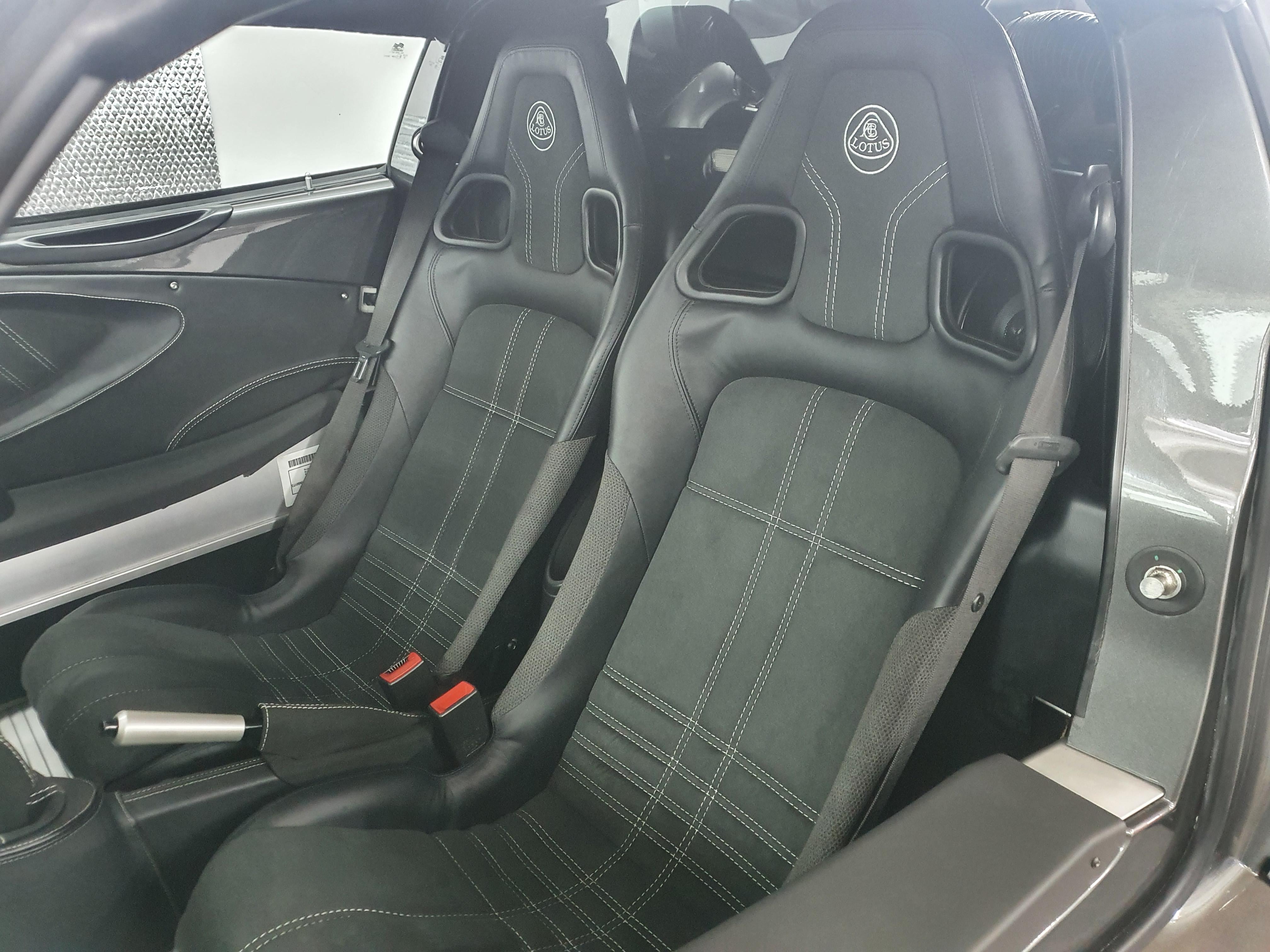

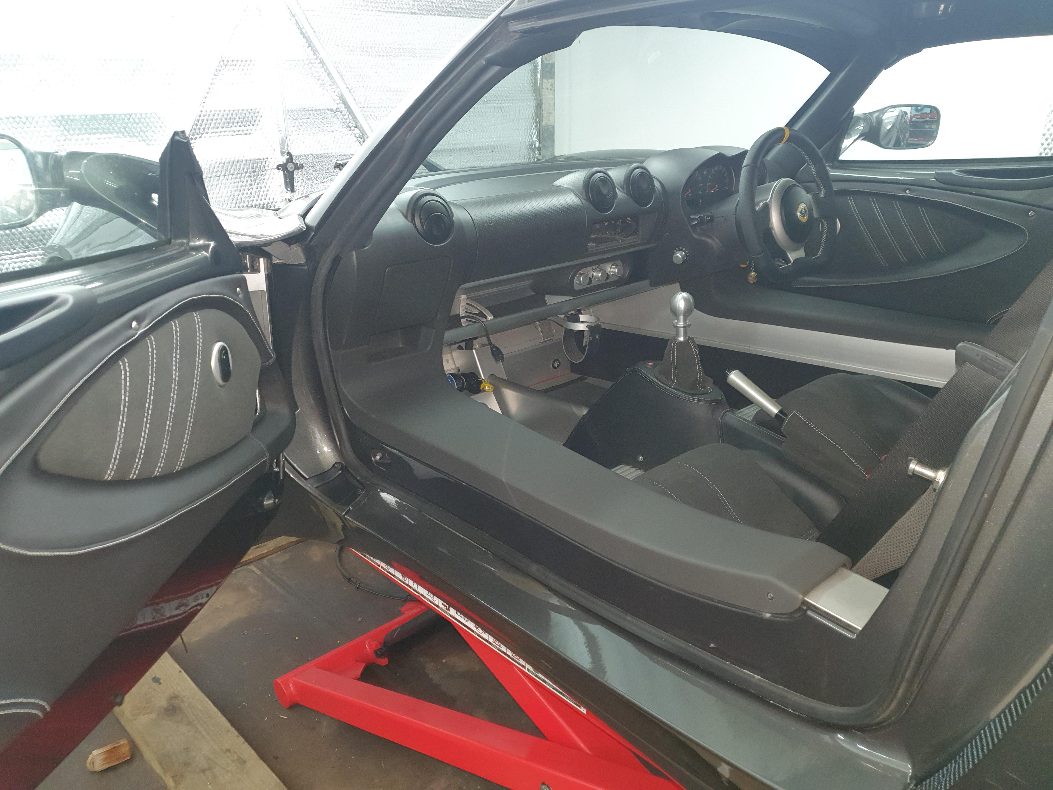

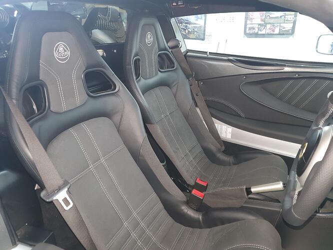

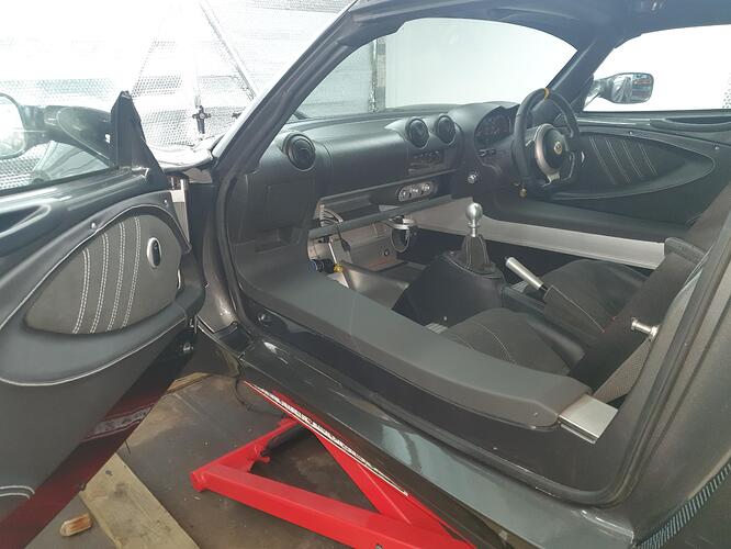

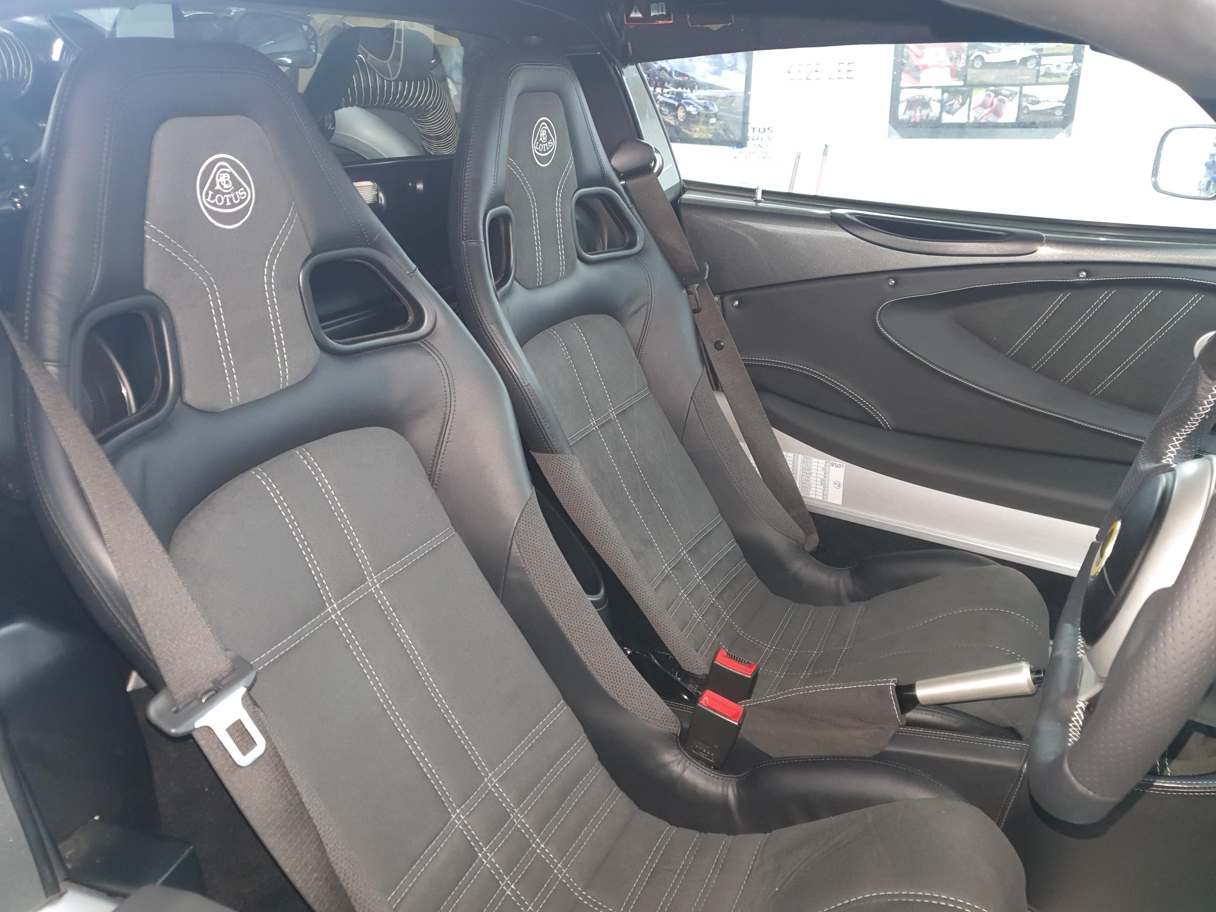

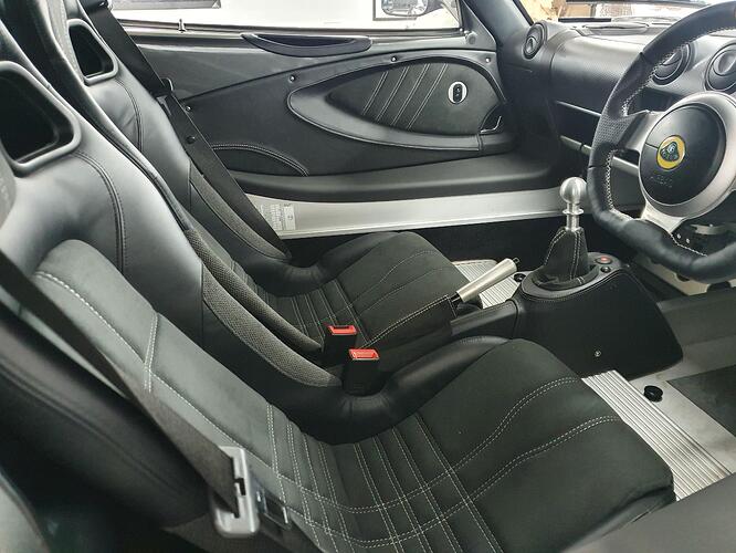

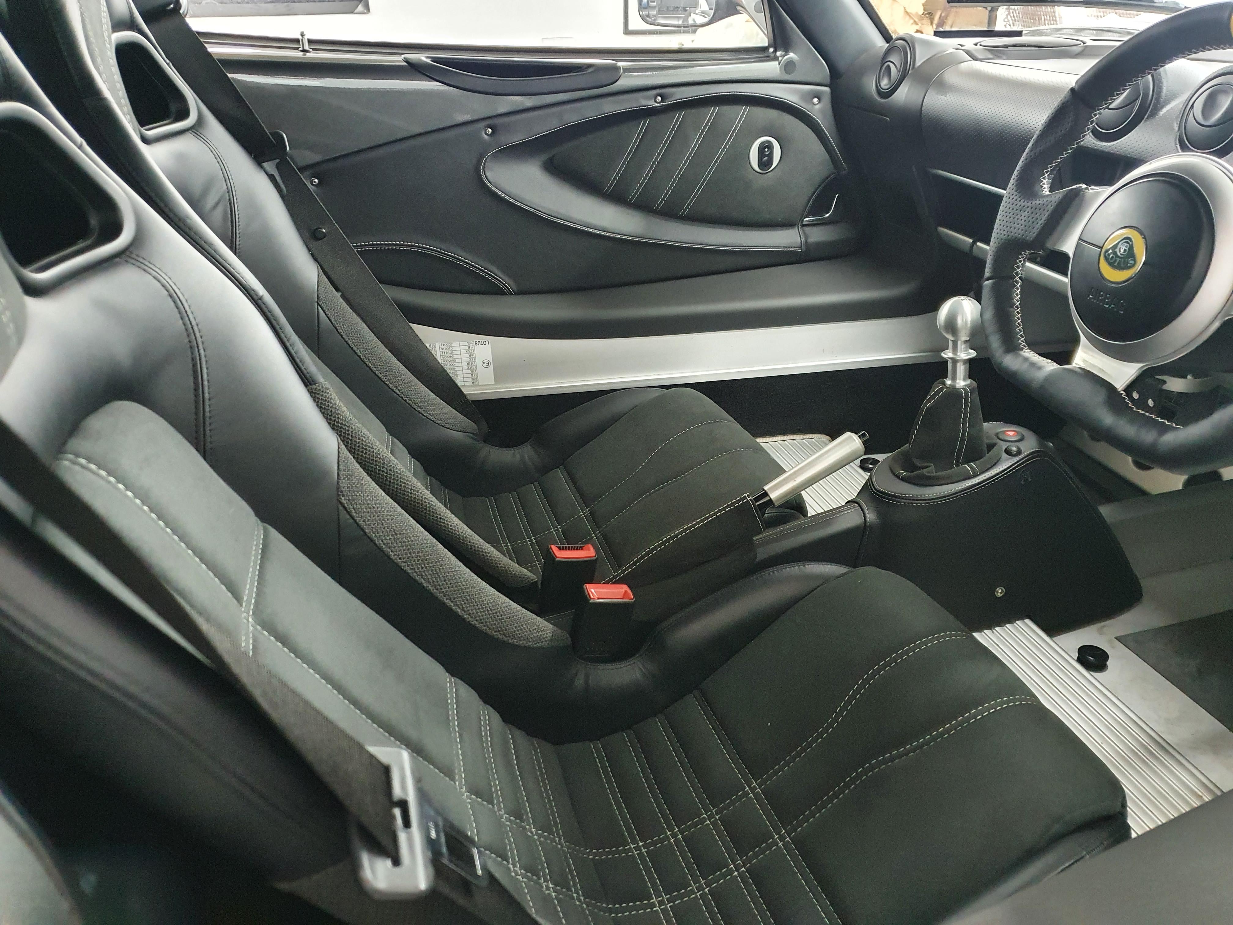

Got the interior back in, and very happy with what the trimmer has done, i feel it brings it right up to todays spec but kind of keeping it standard. The mats not quite ready but they are something rather special :wink:
Fitted my custom made D wheel too which makes getting in and out so much easier but yet keeping it std and of course using the airbag

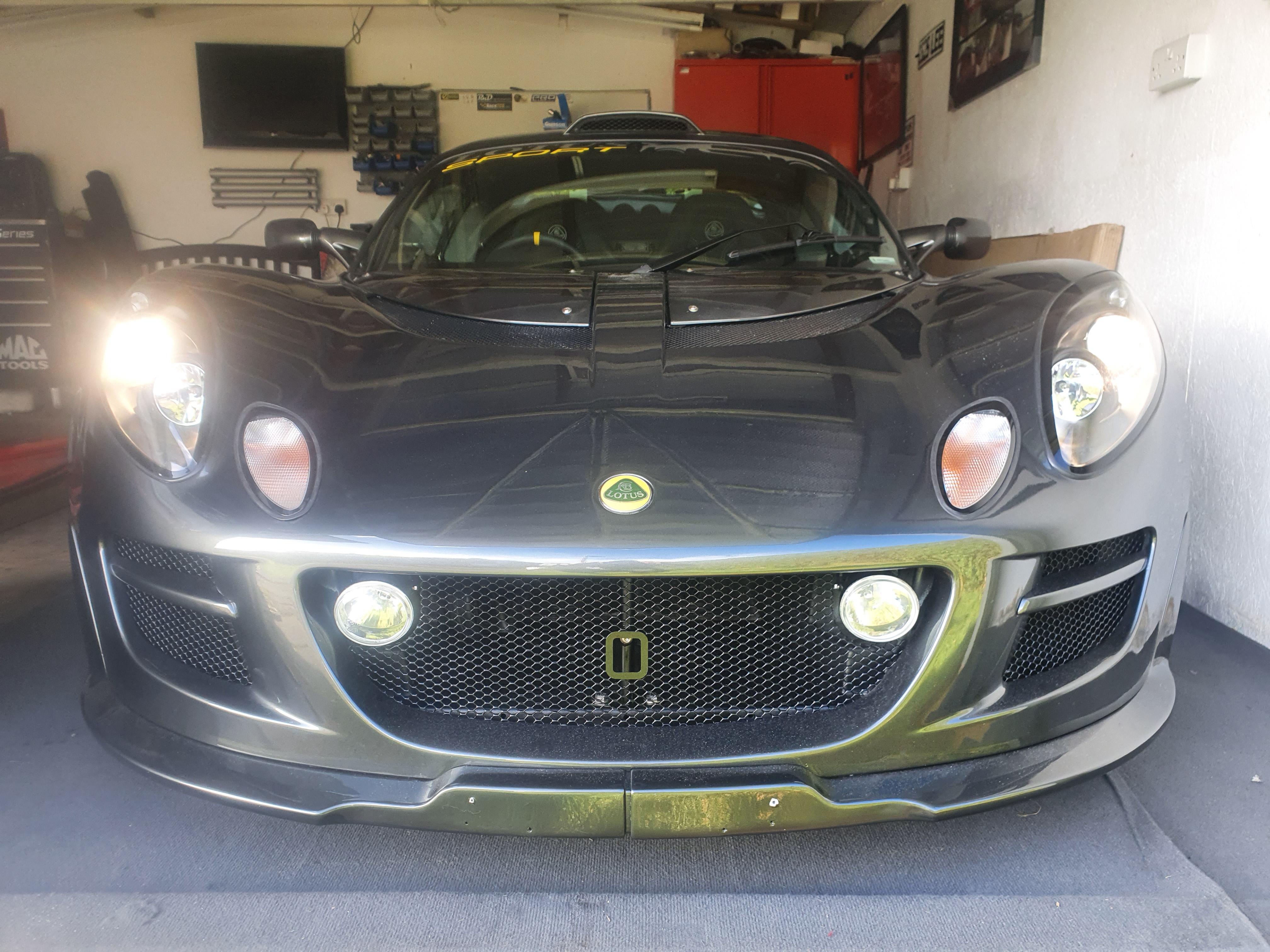

While messing around I accidentally stumbled on a way to have the dipped beam lights on all the time without the rest of the lights. I pretty much have my lights on when driving for better visability so will keep them like this for now. For anyone wanting to do this its the green wire that comes out of the instrument pack that needs plugged in.

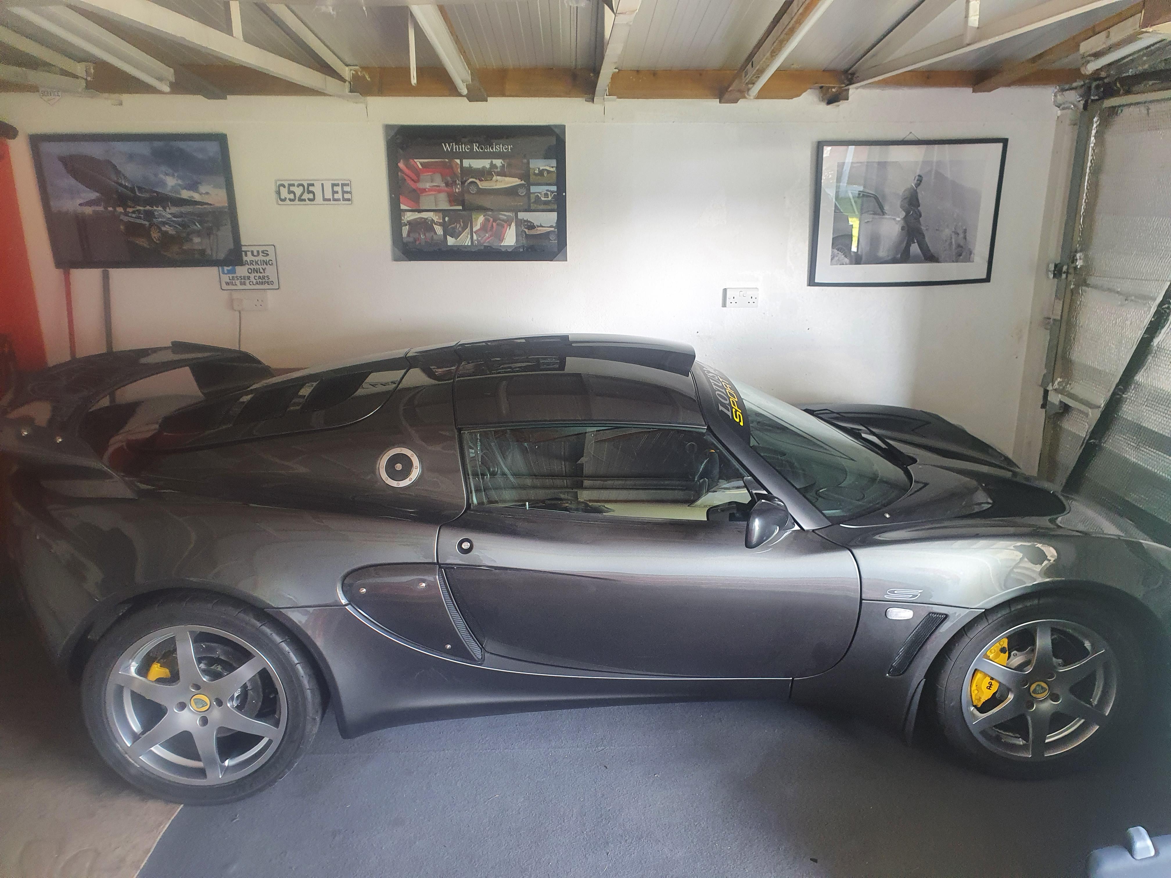

All done and awaiting the 27th March for full PPF treatment, i will keep the Elise wheels on for now as it will be trailered to the PPF company and dont want to risk damaging my cup wheels Mr Marra would kill me :rofl::rofl::rofl:

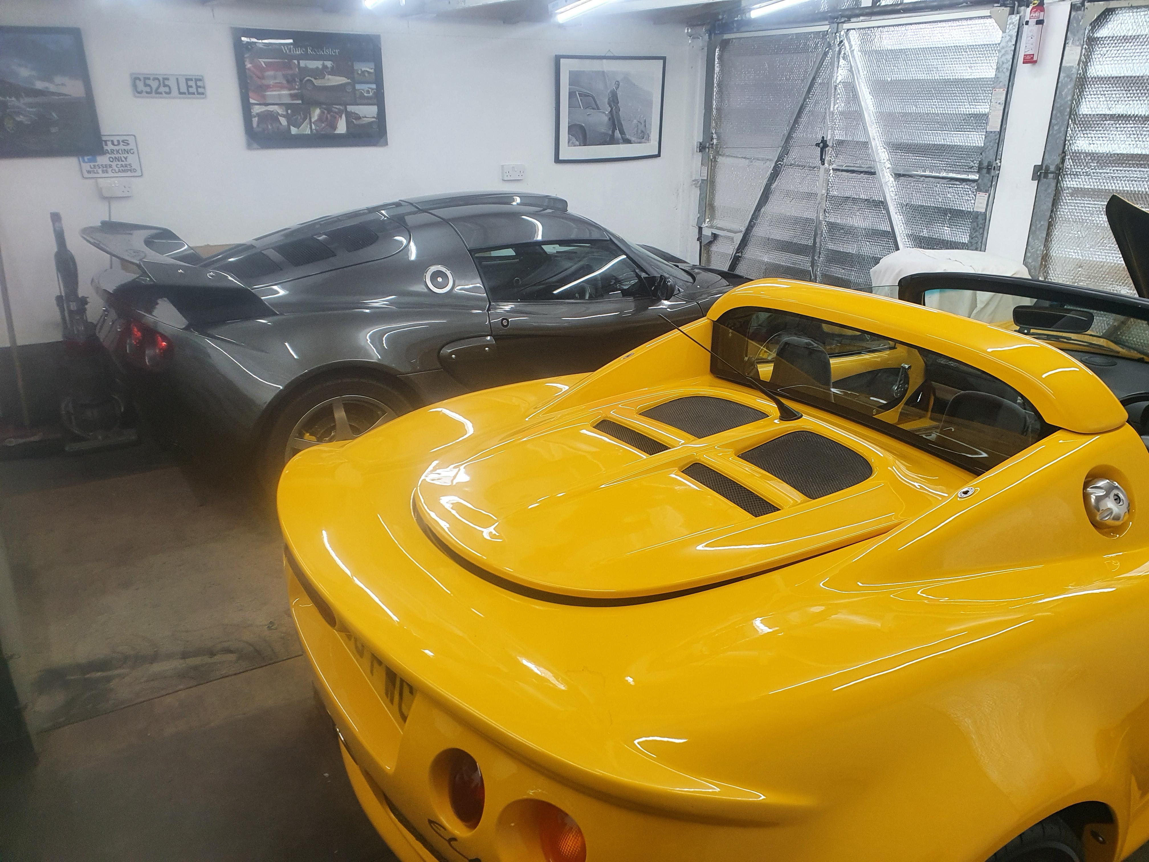

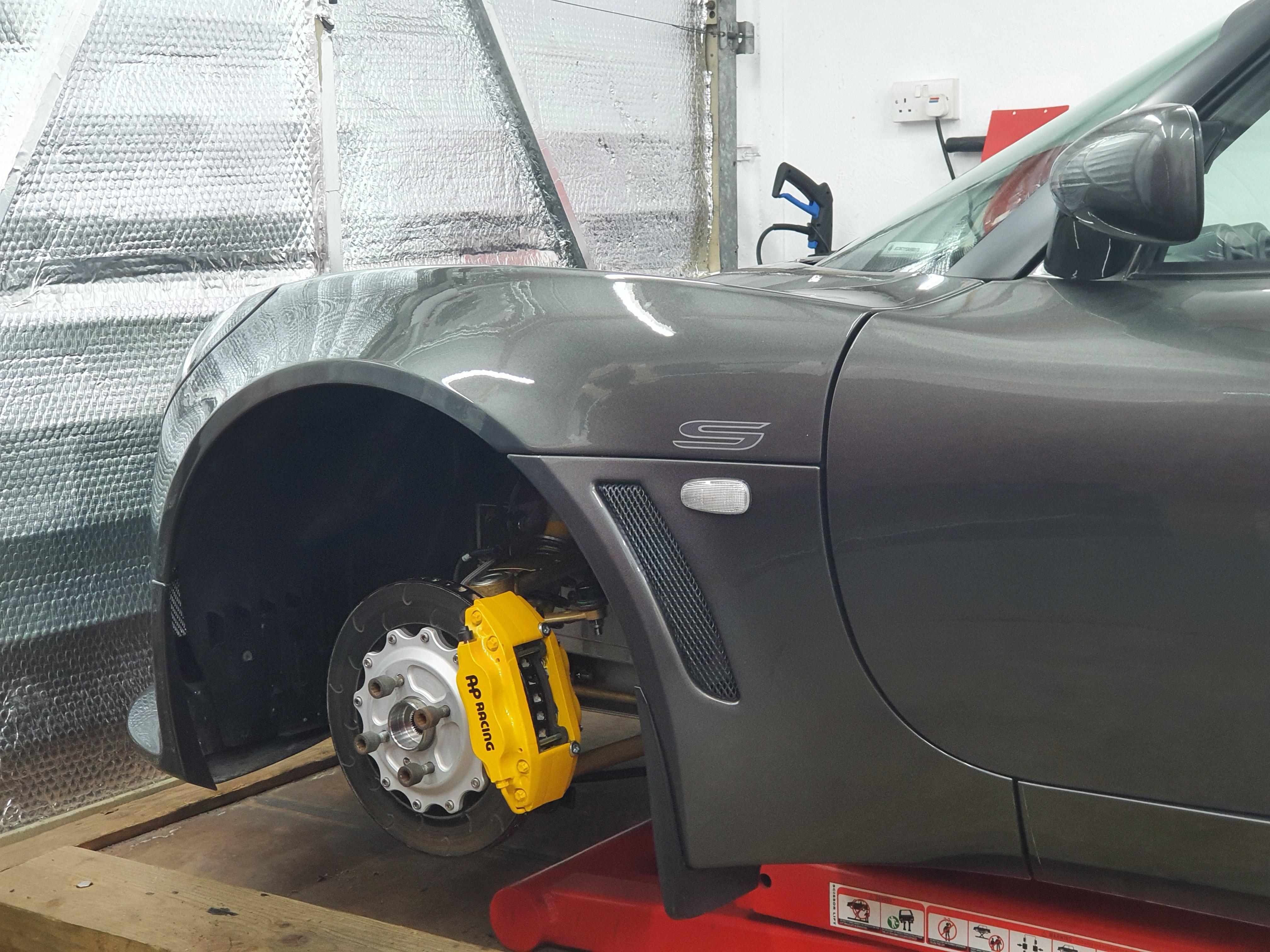

Got its older brother back from dry storage i re built over the first lockdown too. The owner has sold it so its going to a new home in Wales :sleepy:

For the Geo stuff:
What are you aiming for and how many shims did you have in to achieve the above?
-0.3 is more like where you should be aiming for the front rather than 0.0 (Geo Setups - TechWiki). I’d say you’re not far away at all, but I’d get the toe settings sorted before spending much more time on it as that will have an impact too.
My front camber is more like -0.8 and rear -2.5 which is maybe on the extreme end of a road setup, but still within acceptable boundaries so doesn’t tramline anywhere and tyre wear isn’t too bad.
