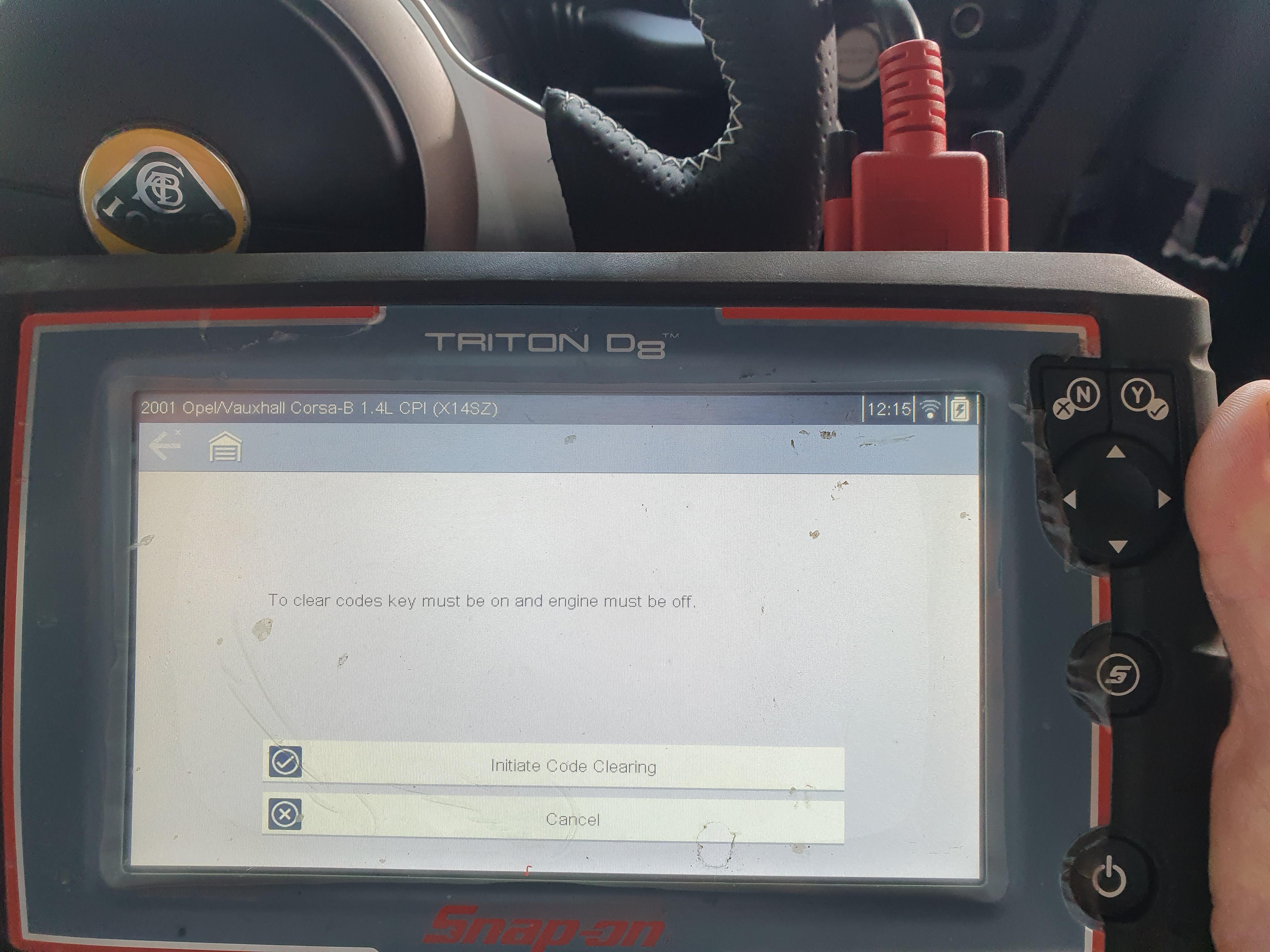

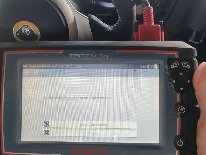

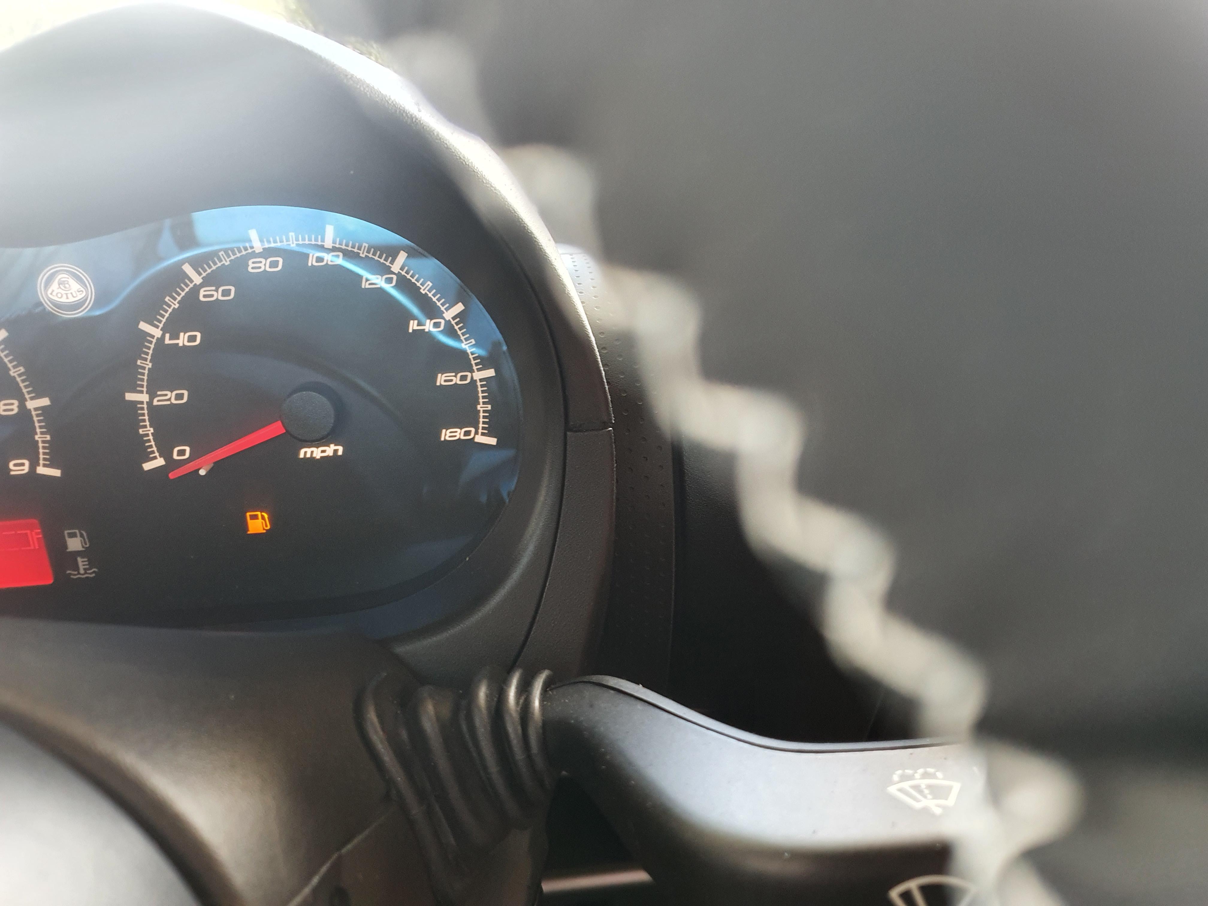

Little update, switching the airbag light off, needed to access the ECU by going in via a 2001 vauxhall corsa b :crazy:
Anyway all done

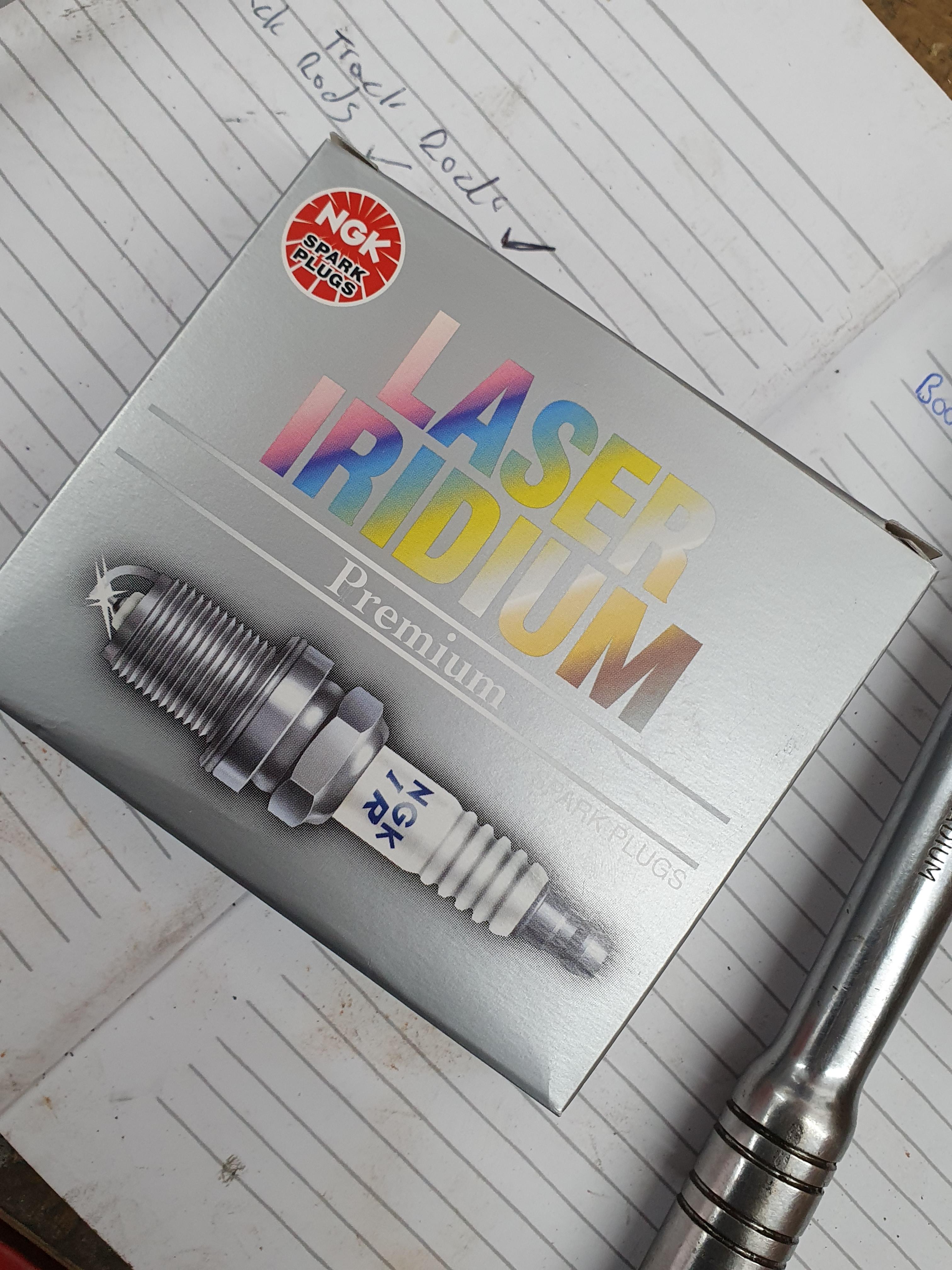

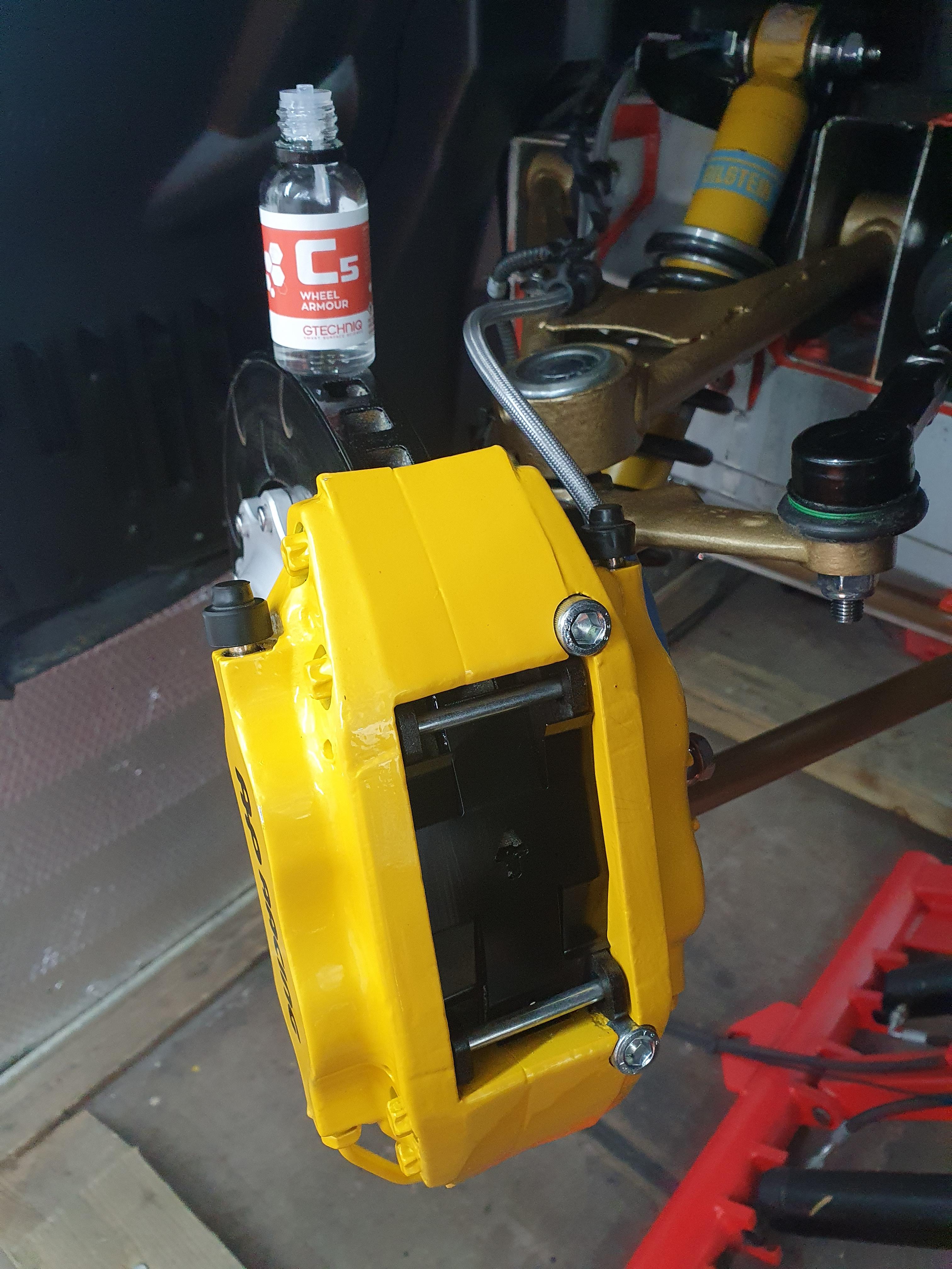

Gave its a fresh set of plugs a some nice golden blood, in the end went for 5/40 fully synthetic fuchs race oil.

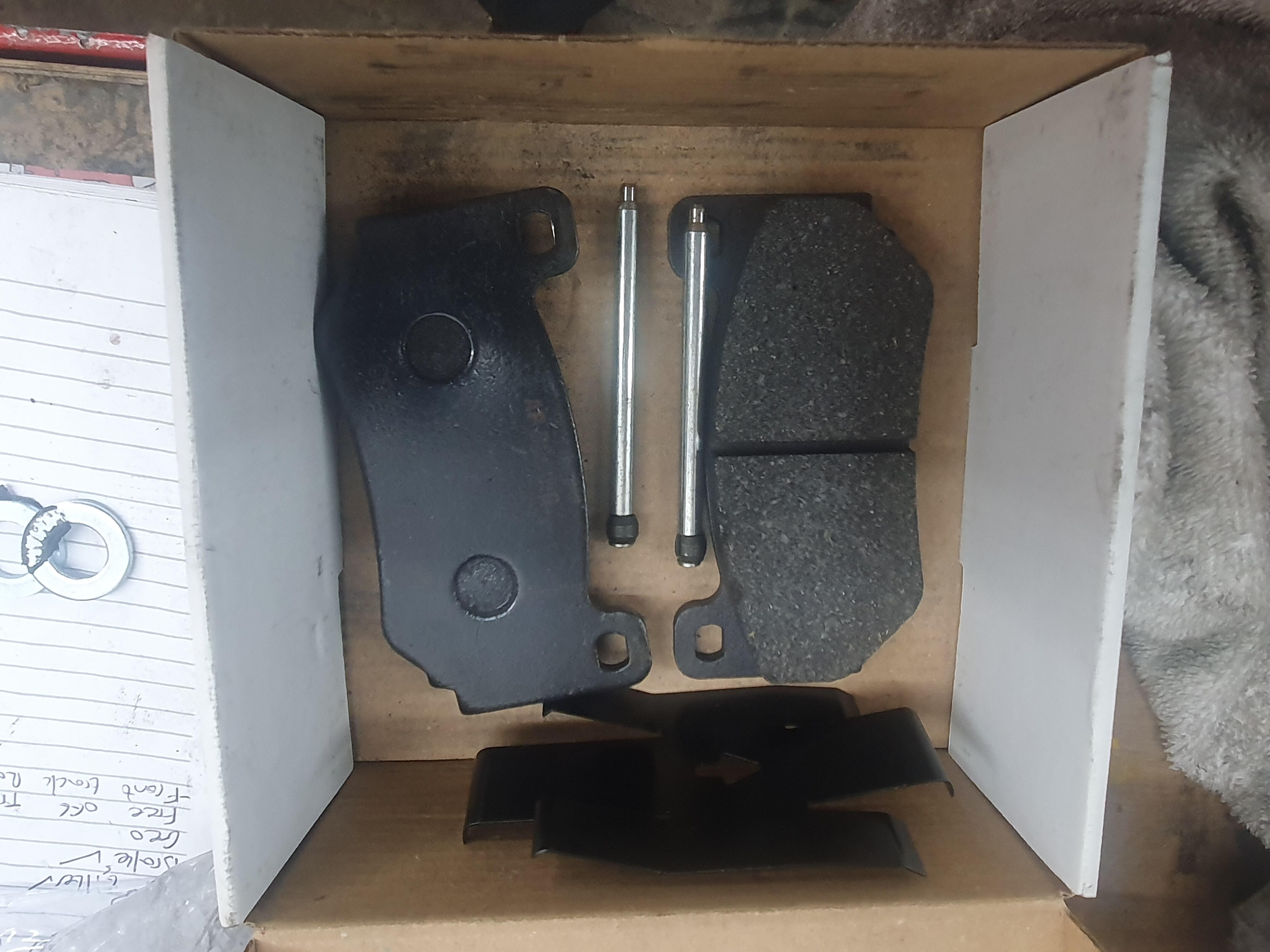

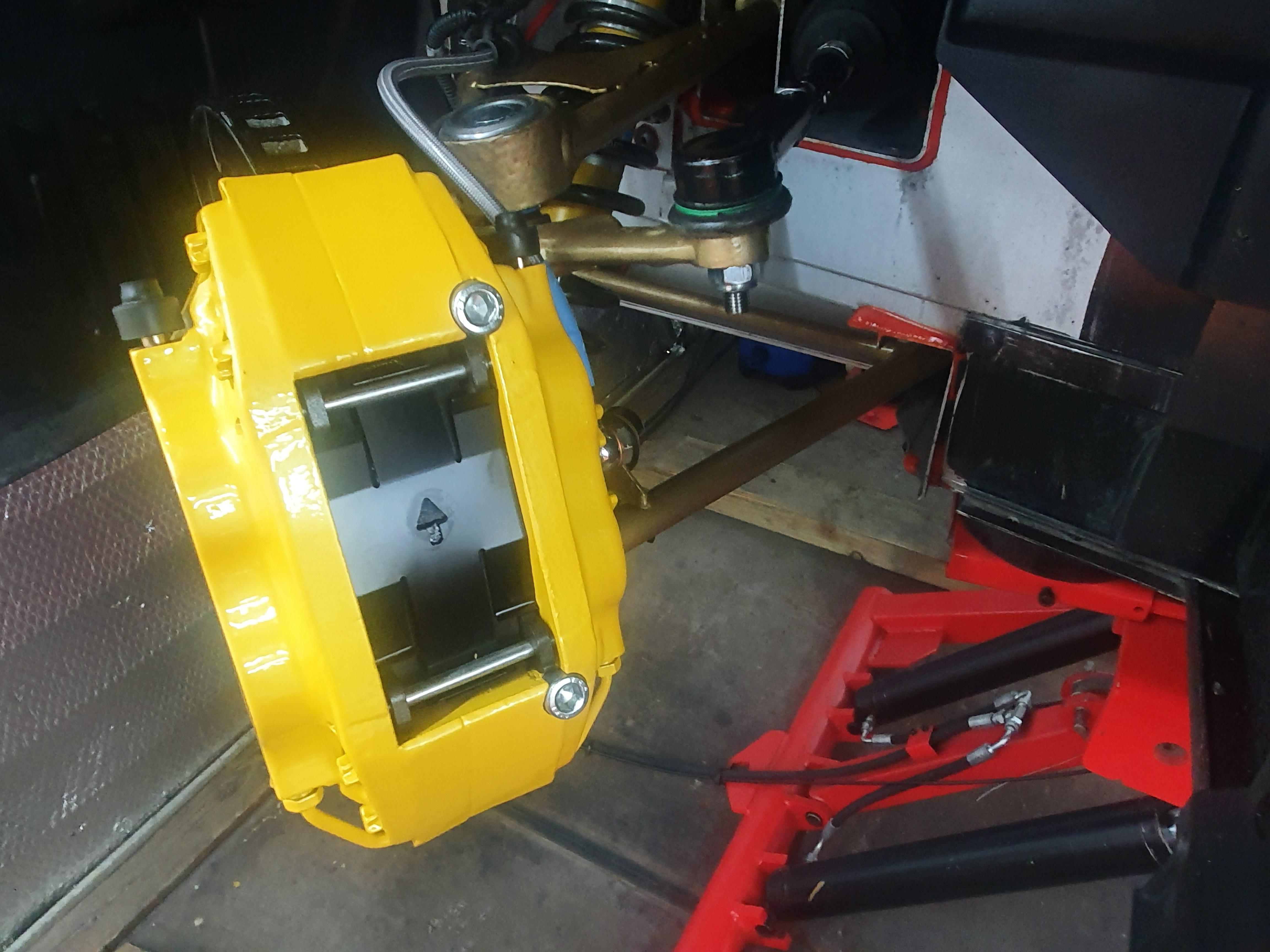

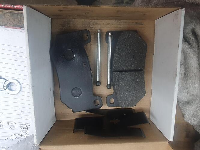

New pads fitted up front DS2500 to replace the RC5

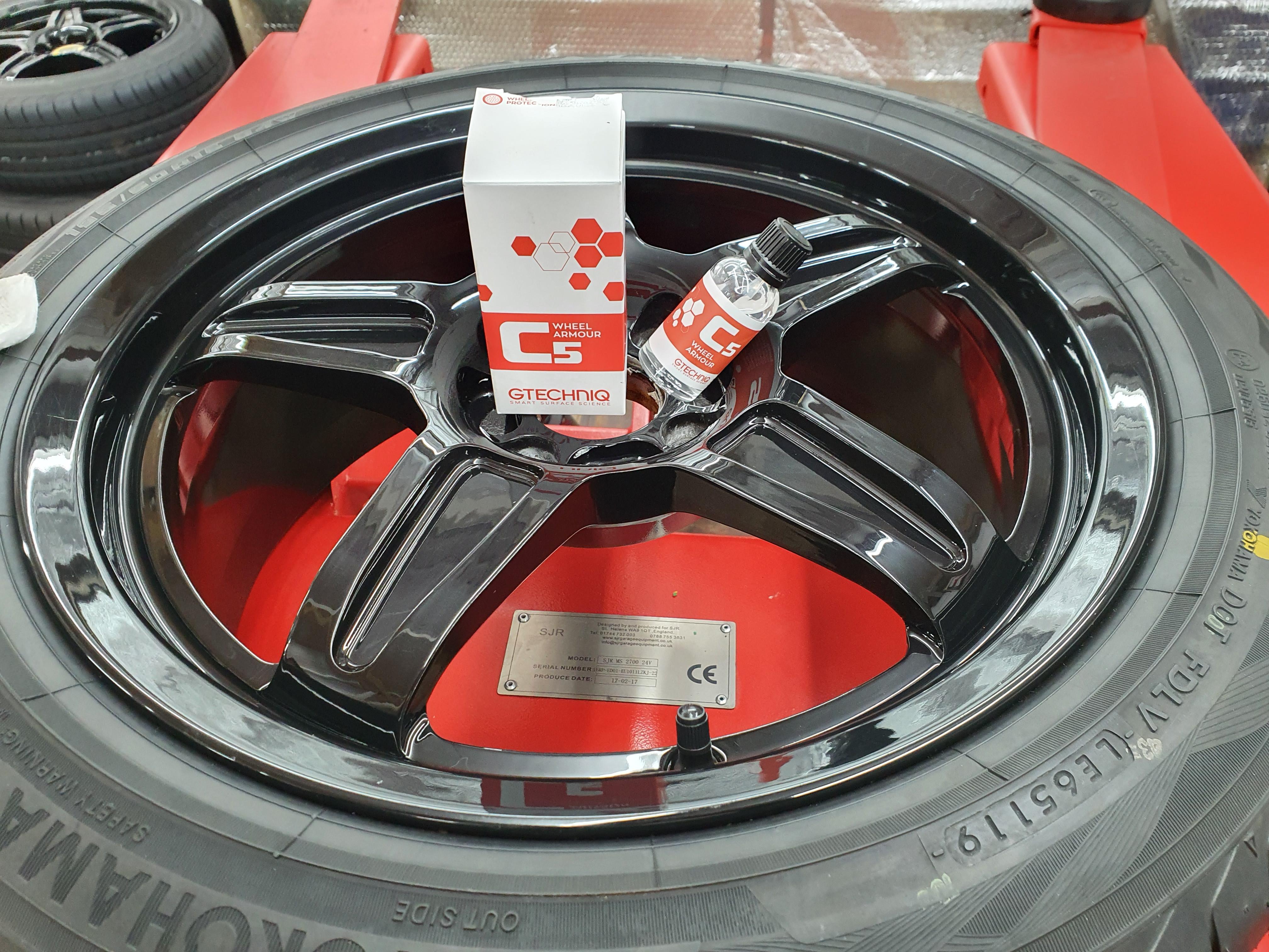

Went a bit OTT on ceramic coating, once i had done the wheels, calipers, bells, shocks and chassis got treated to a nice coat.
Nice to have it back on its proper wheels, PPF on the 27th and its time to give it a shackdown.

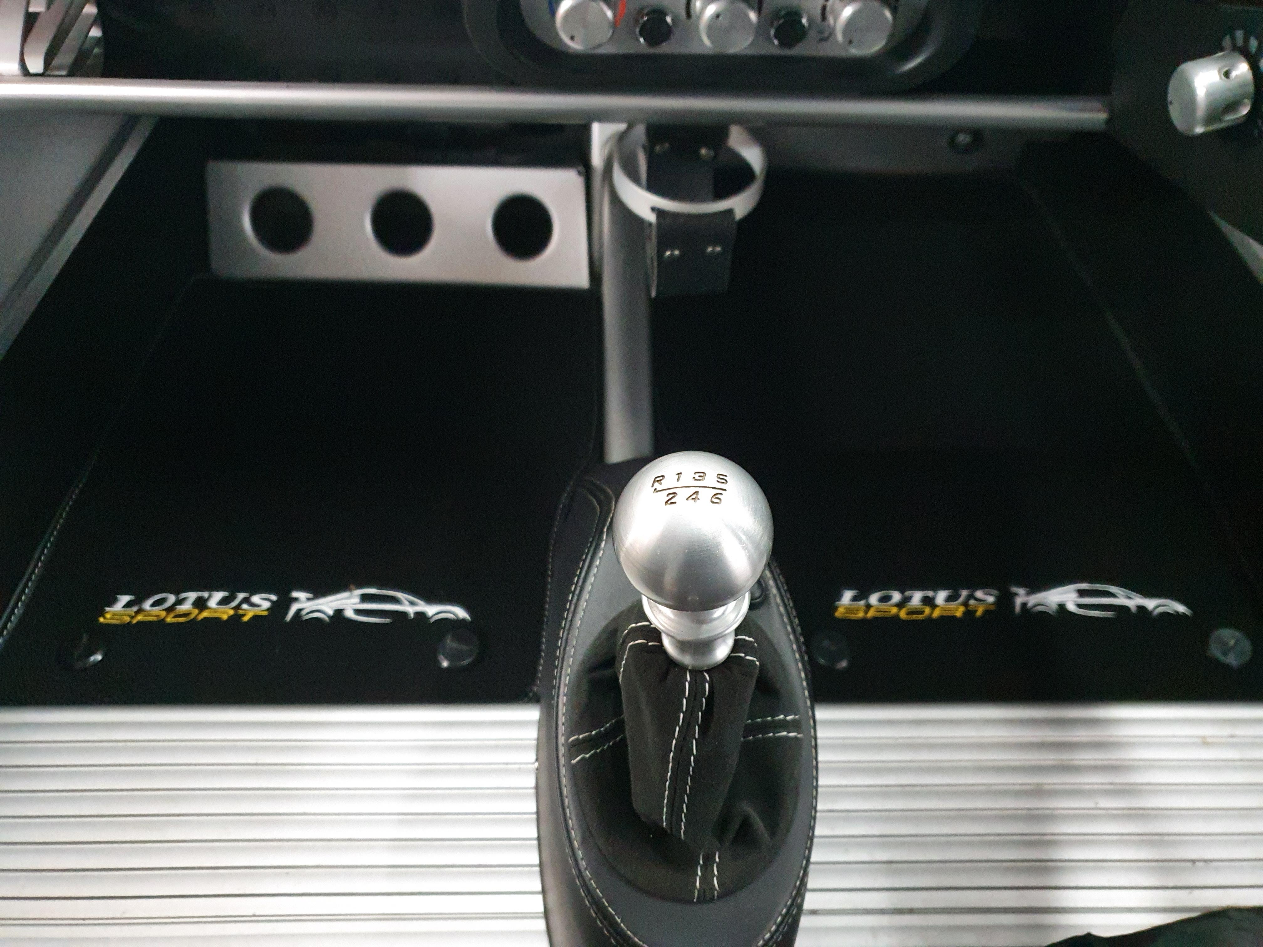

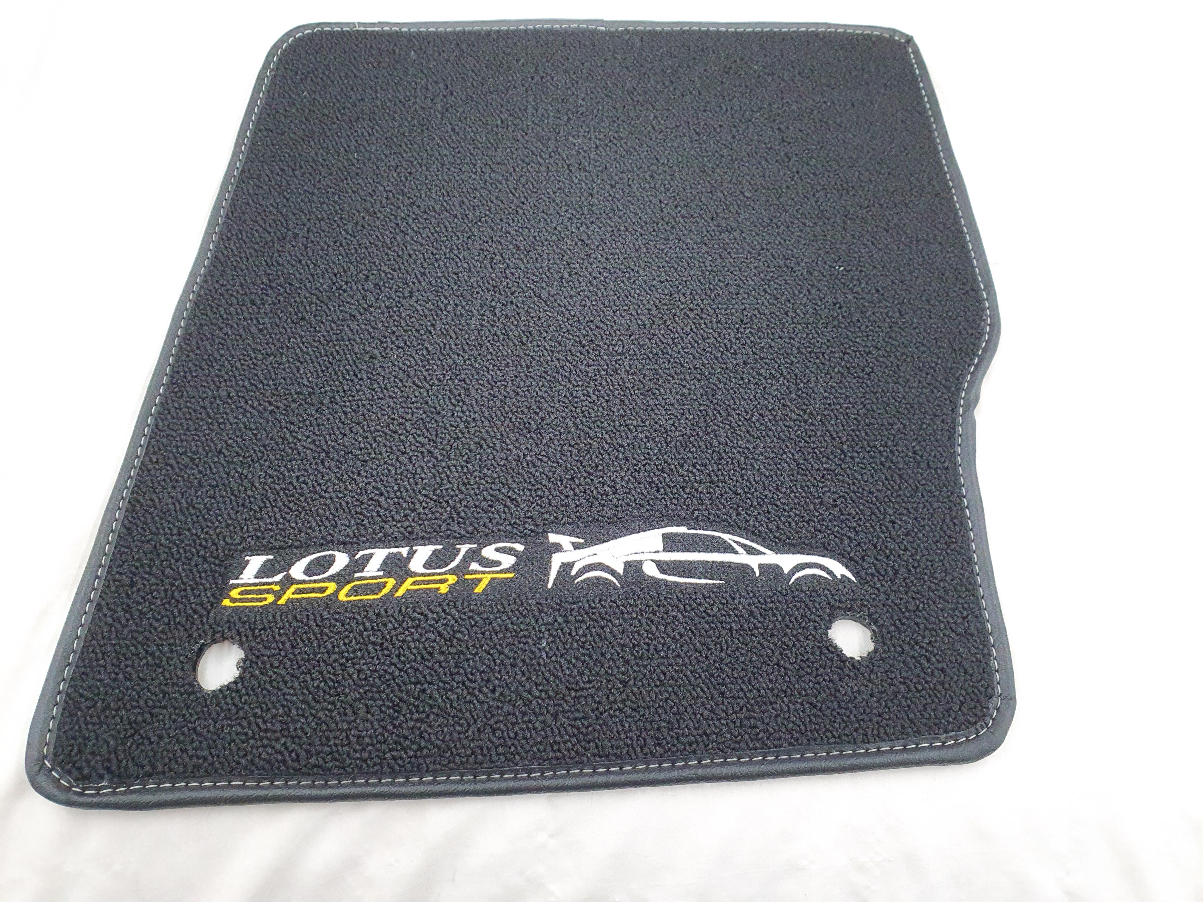

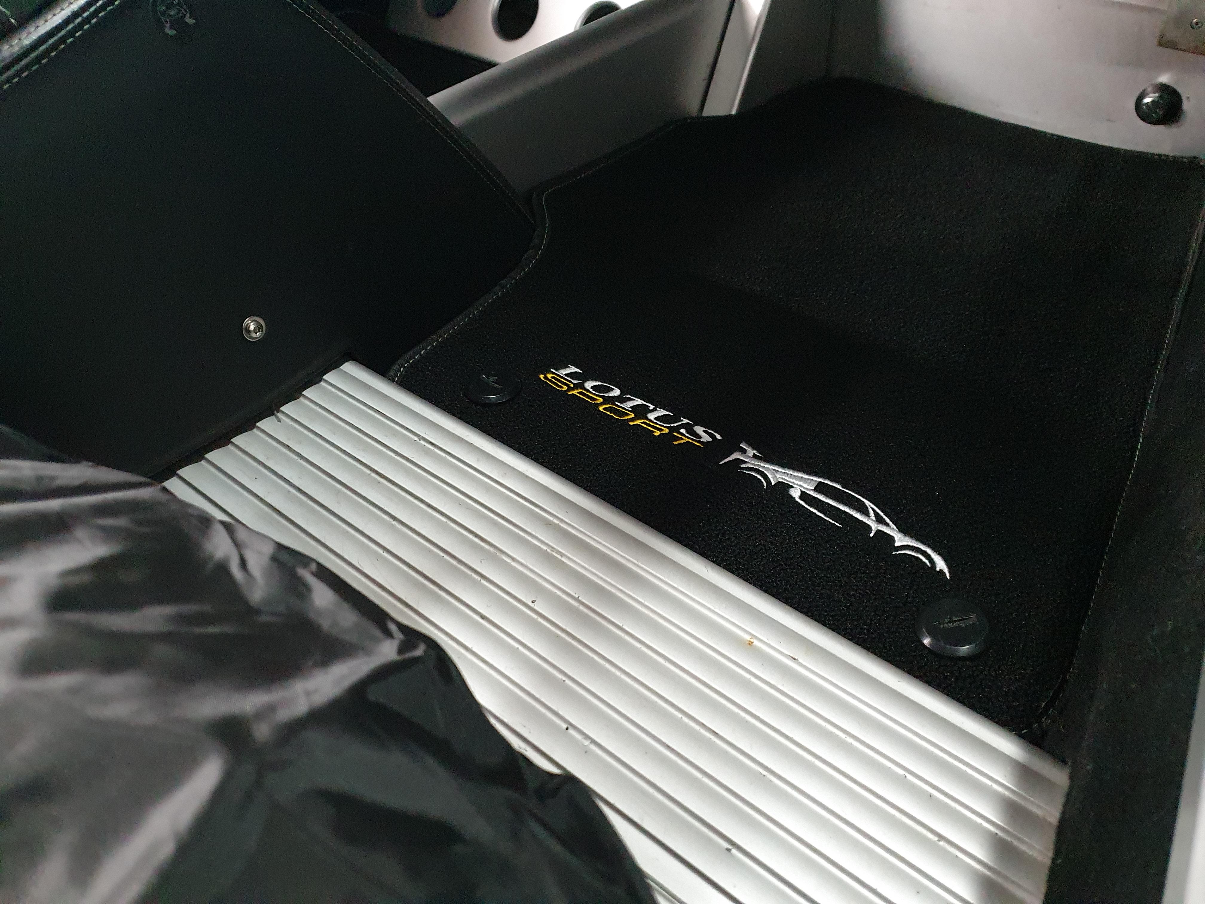

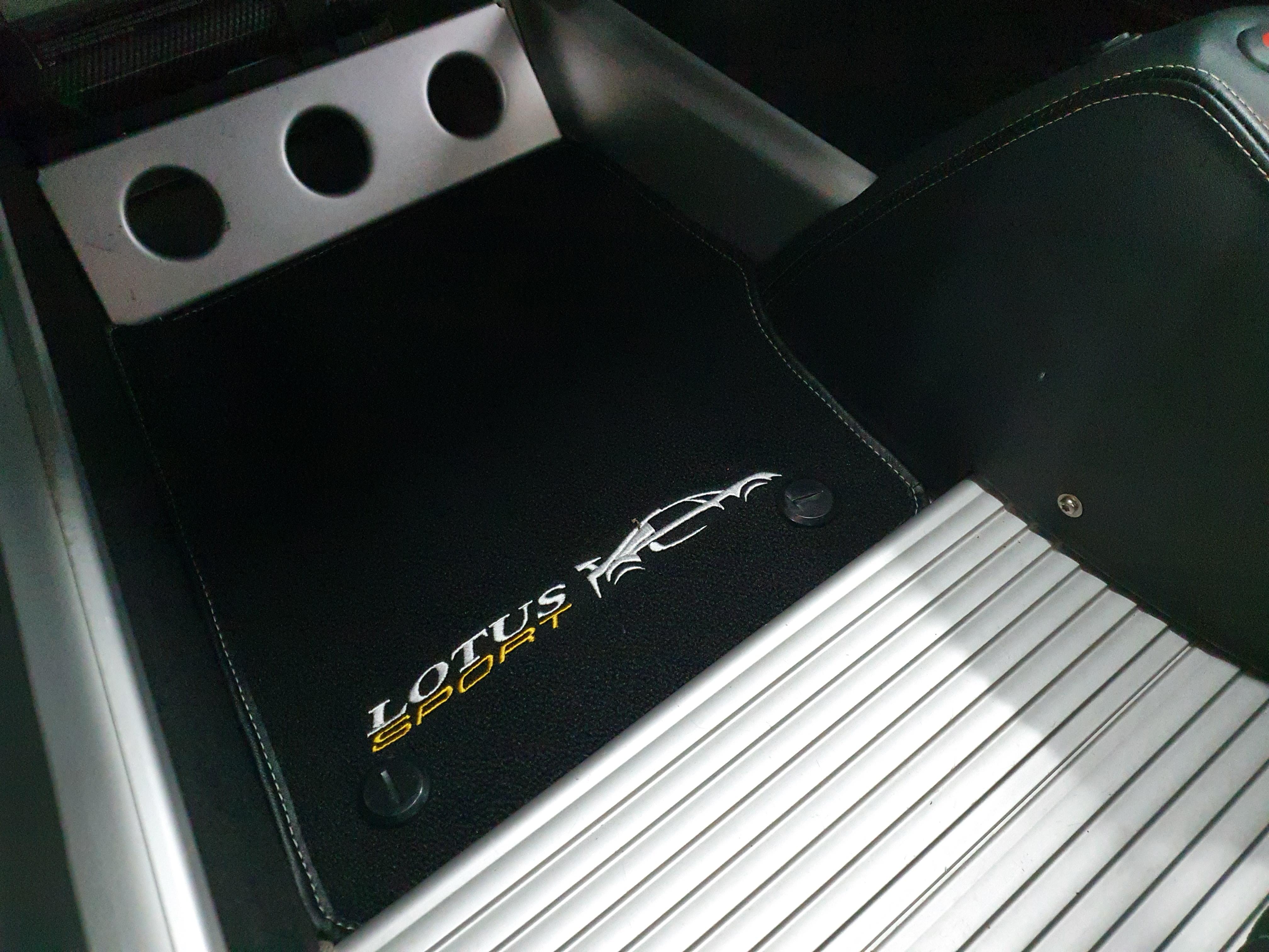

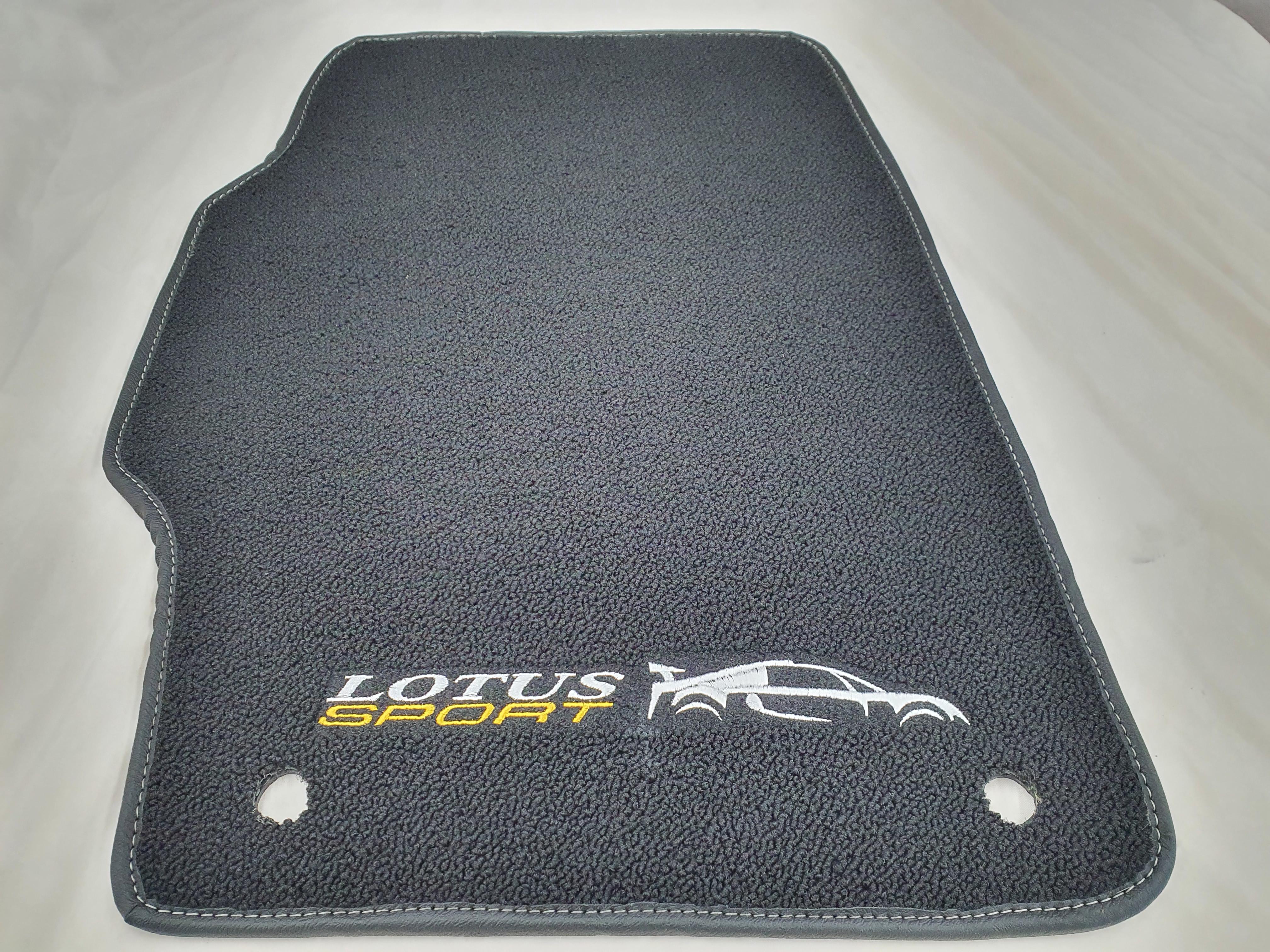

Really happy with the new mats Ross made for me, think they complement the rest of the interior
Looking fab! A winter well spent :thumbup:
Those mats are ace - mind sharing details ? (or PM if easier) - Thanks
+1 on the Mats, linky please?
For those who use Facebook he goes under the name of Ross Hogg Robinson send him a PM or his number is 07984 034 284 (he said it was ok to share)
Ross has done me loads over the years and is a top trimmer and equally top guy.

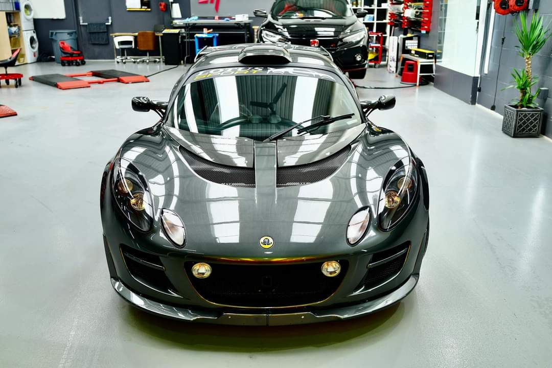

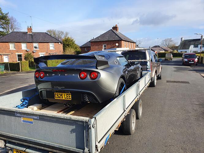

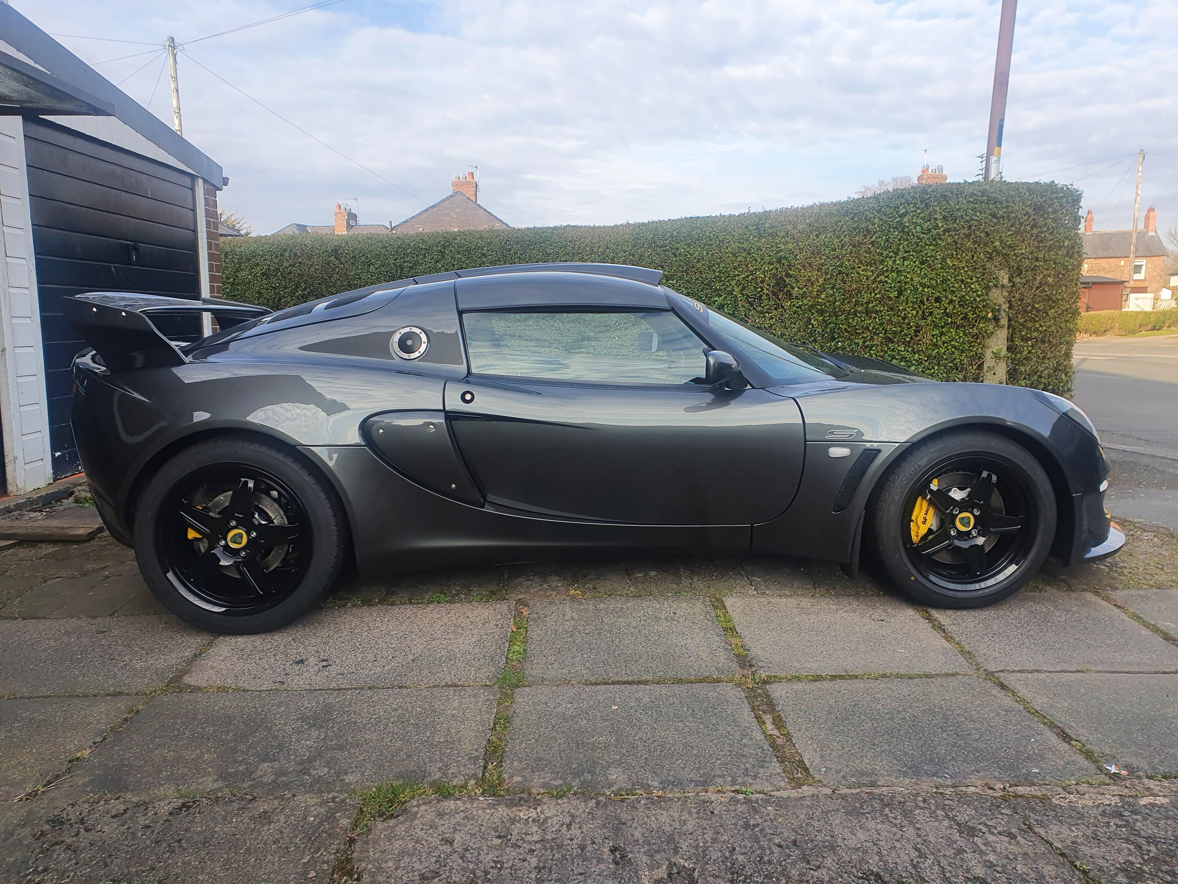

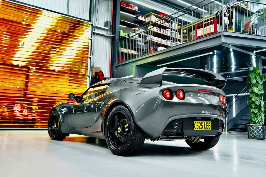

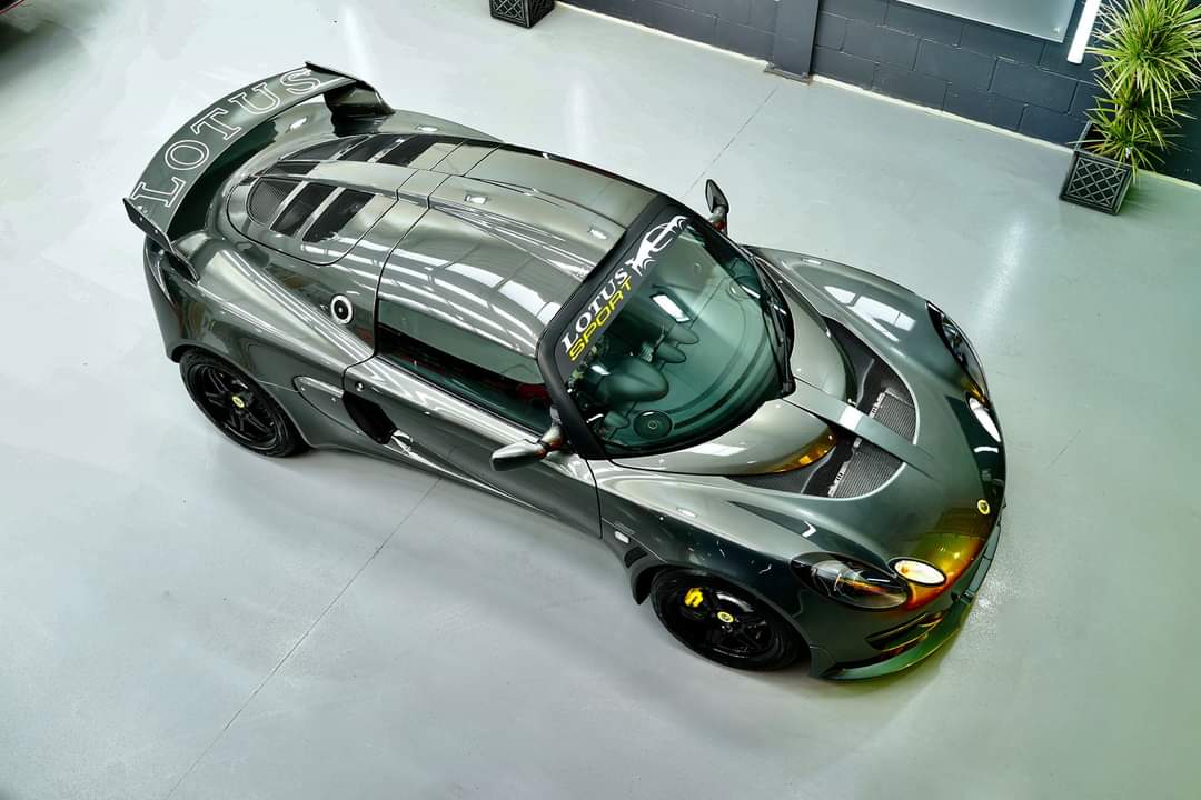

The finishing touches is the PPF, i wanted the bodywork protected, ive spent a lot of time and money getting the paintwork as good as new if not better. Although the PPF company is only 10 miles away I still trailered it.
Xpel film is used self healing should it get knocked and a 10 year guarantee. The front from the top of the lights downwards is covered, around the front wheel arches and lower panel. Both sills wrapped into infront of rear wheels, bottom of doors upto edge shaped downwards, air intake pods, rear arches and lower rear bumper.
I picked the car up and went straight for a GEO set up and from there to get a MoT.

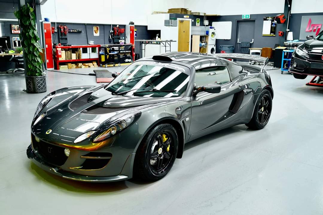

That is one seriously sexy car! I love the colour and the yellow calipers :sunglasses:
It was great to finally see it in the flesh, Lee. You’ve done a fantastic job, it looks absolutely stunning! It was also good to catch up with everyone on Saturday, it’s a shame Tim couldn’t make it. :thumbup:
Fantastic Lee, the over-filtered shots from the PPF place are simply not necessary as your later pic which I presume is just a naked photo from a phone in front of the Vulcan shows that the car is stunning on its own!
