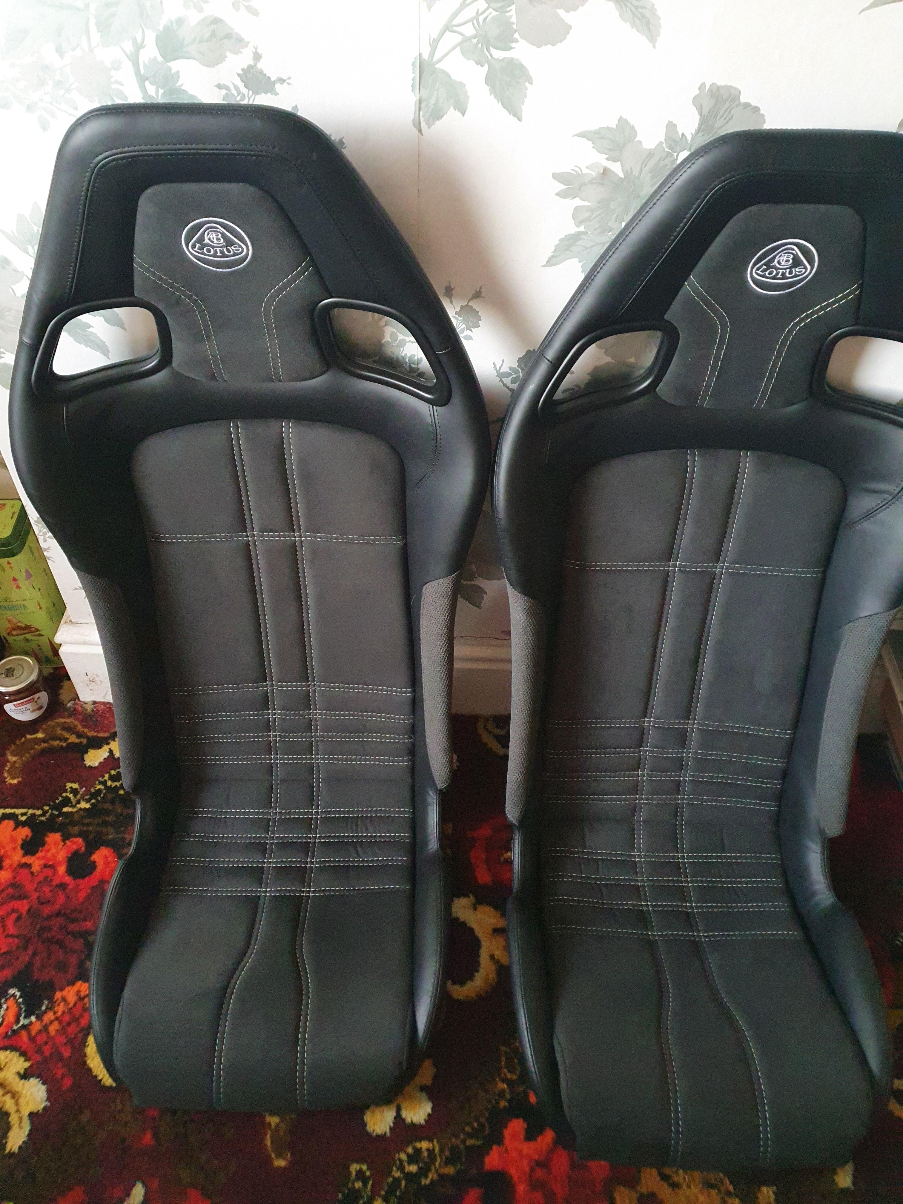

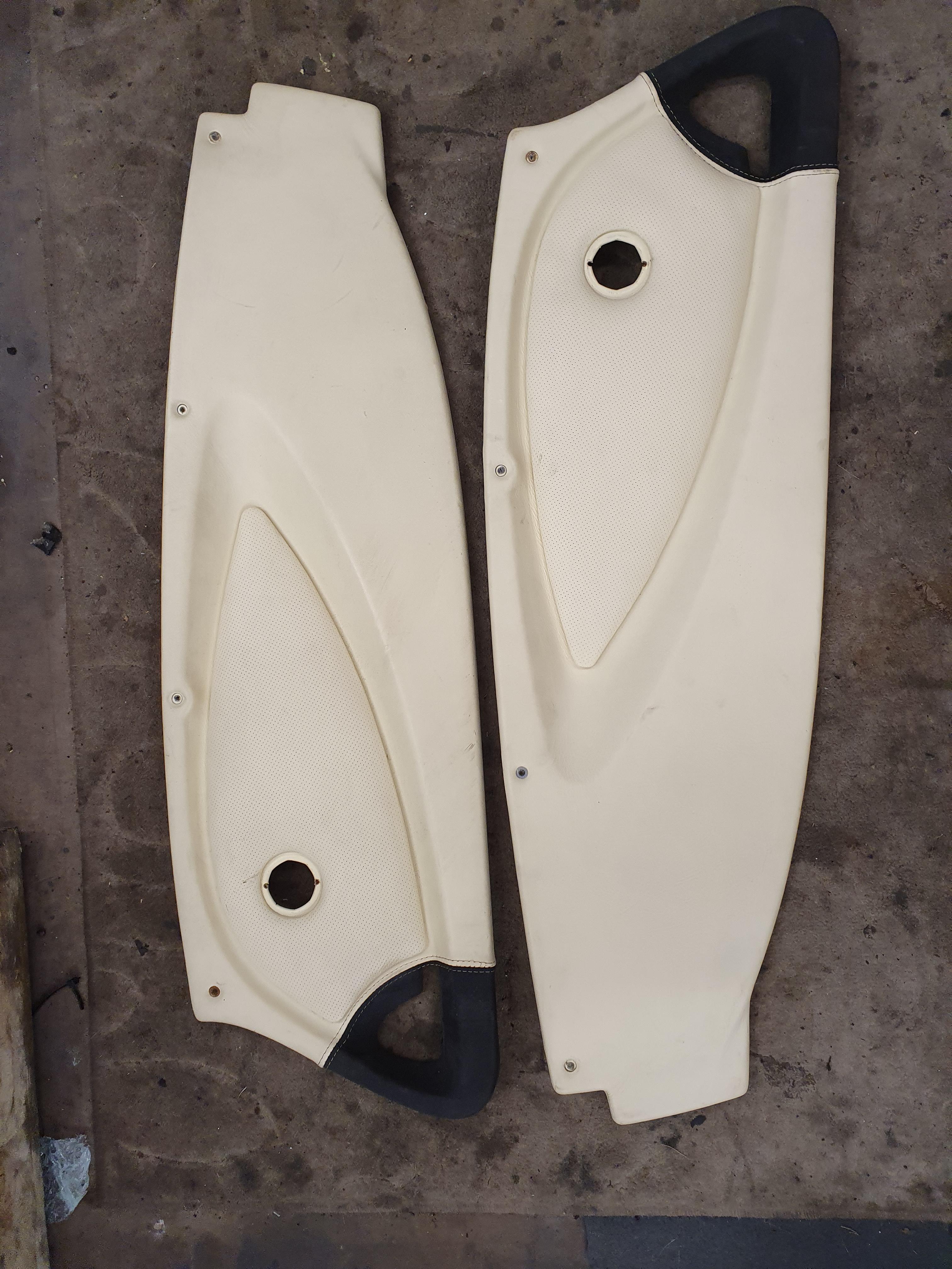

On the way back dropped the door cards in at the trimmer, they will be made to match seats. Allon White are supplying the Alcantara and leather to match.

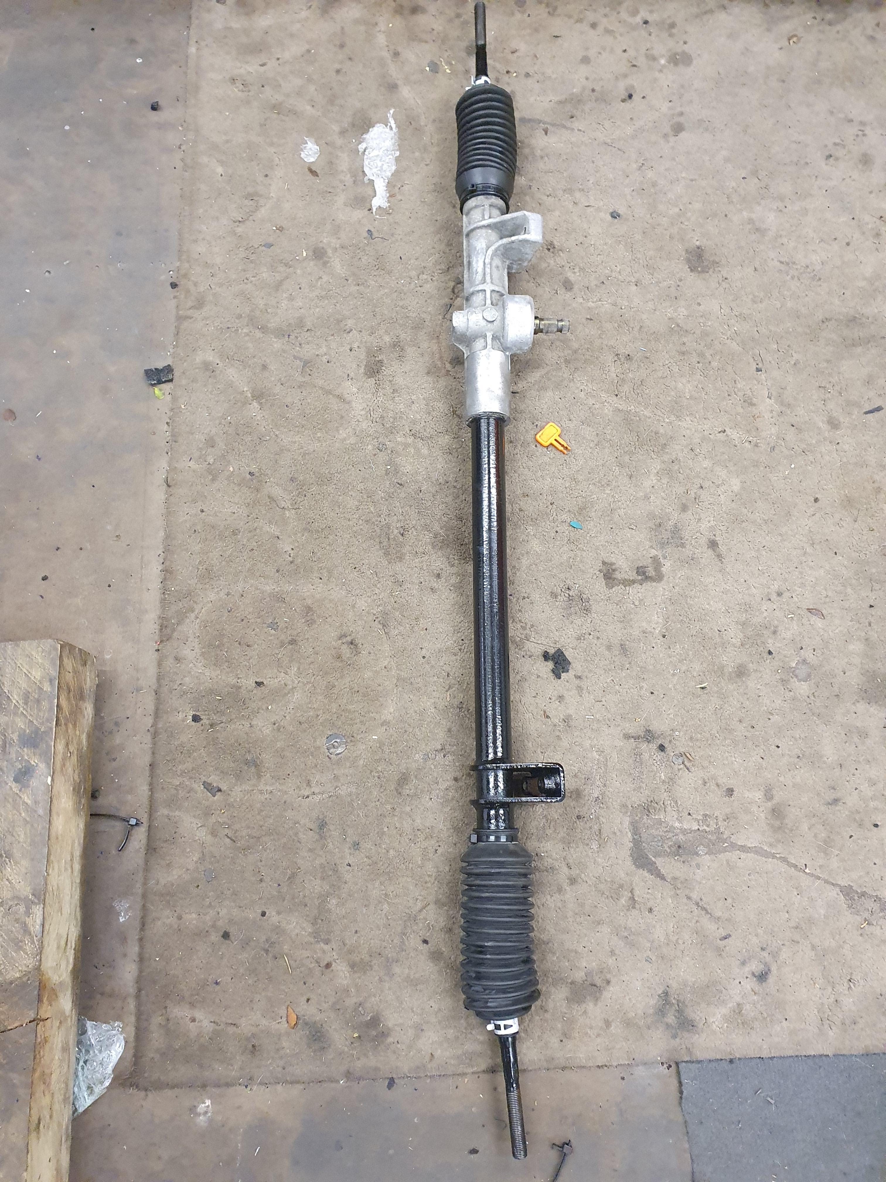

So that was Saturday taken care of, but on Sunday the rack got checked, thrust pad checked and new gators. Pretty easy to reinstall too with a fresh coat of paint.

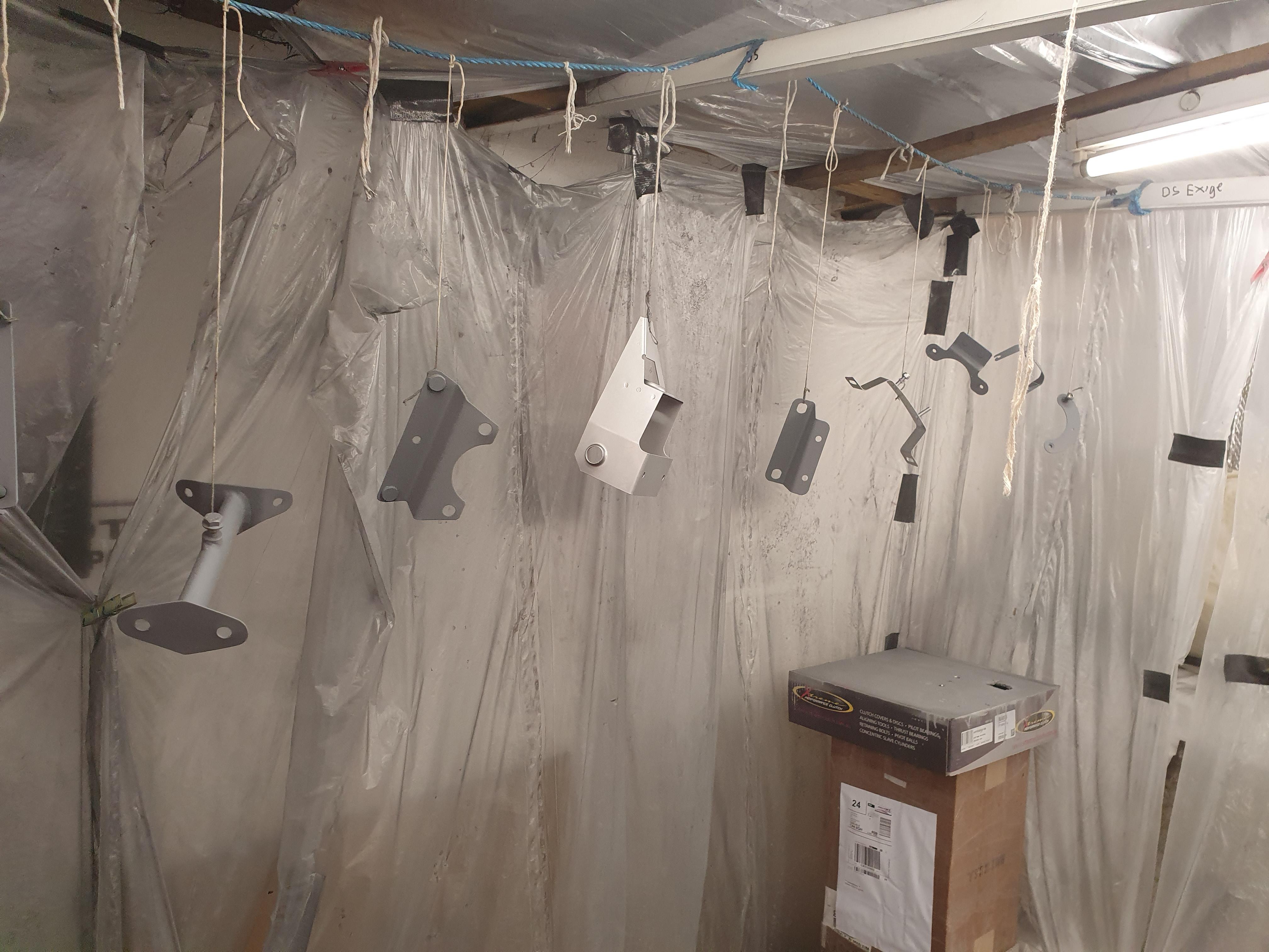

All front end brackets, and fixings back from the shotblasters and galv sprayed.

We’re those the seat on eBay last week?
I was watching those and then the advert disappeared.
Yes i got them off Ebay, made a offer the seller could not refuse.
Bugger, I hate you
I was watching those and then the advert disappeared.Yes i got them off Ebay, made a offer the seller could not refuse.
Bugger, I hate you
its ok i dont mind if you hate me , cause i love the seats
The new seats look great Lee, worth the epic trip! (does this mean I get to keep mine now? ). I’ll be round for a look when we are allowed.

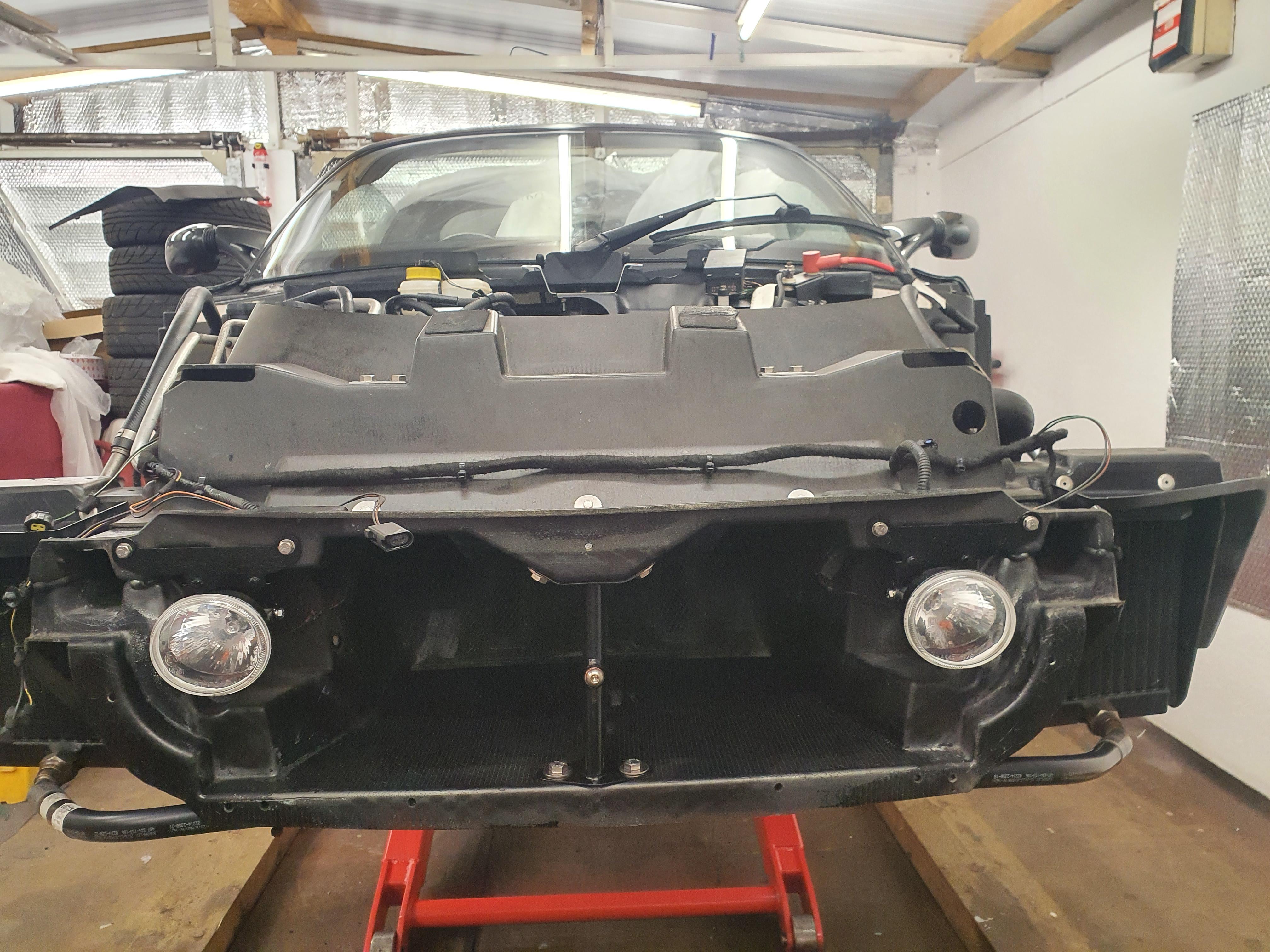

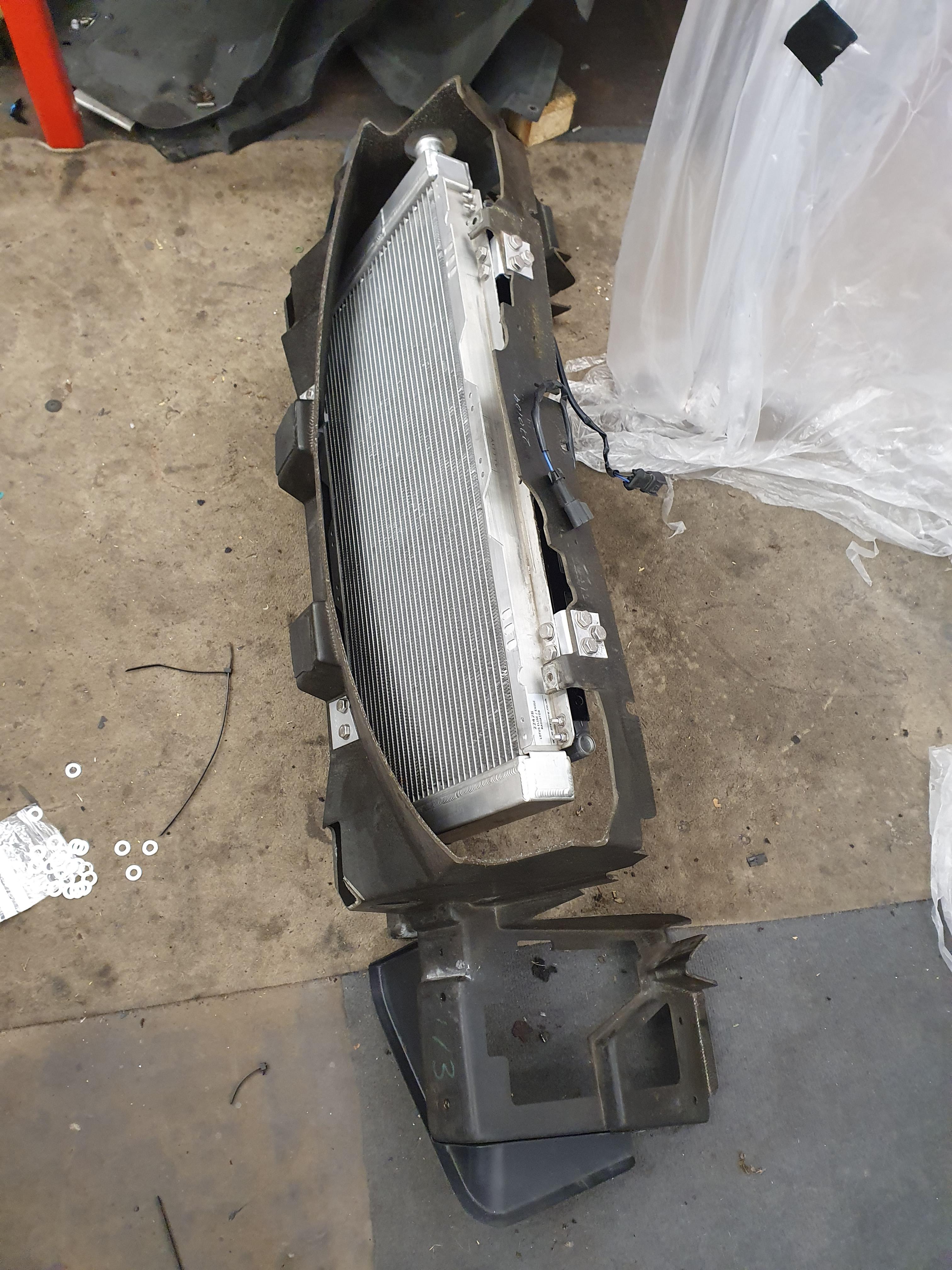

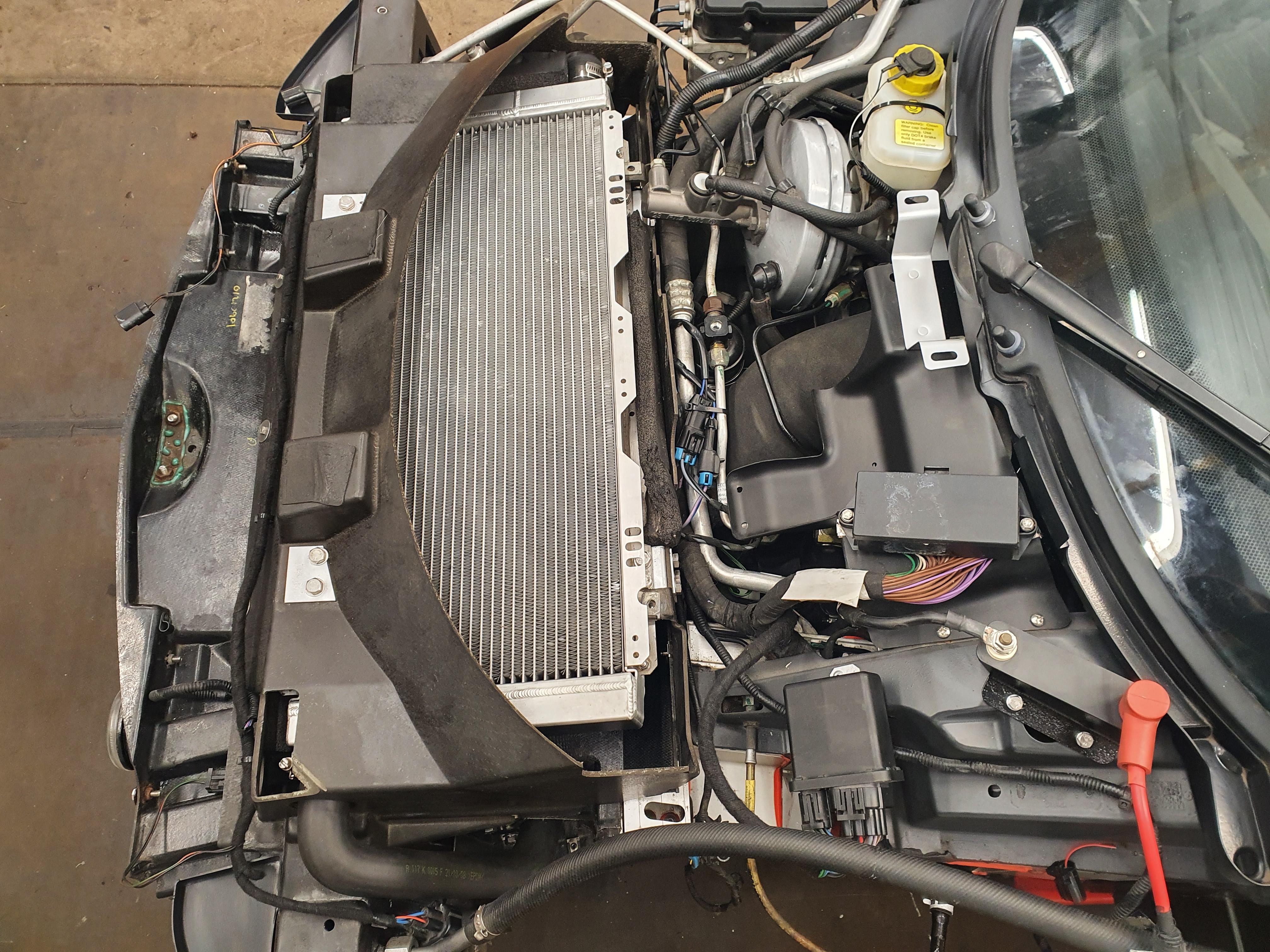

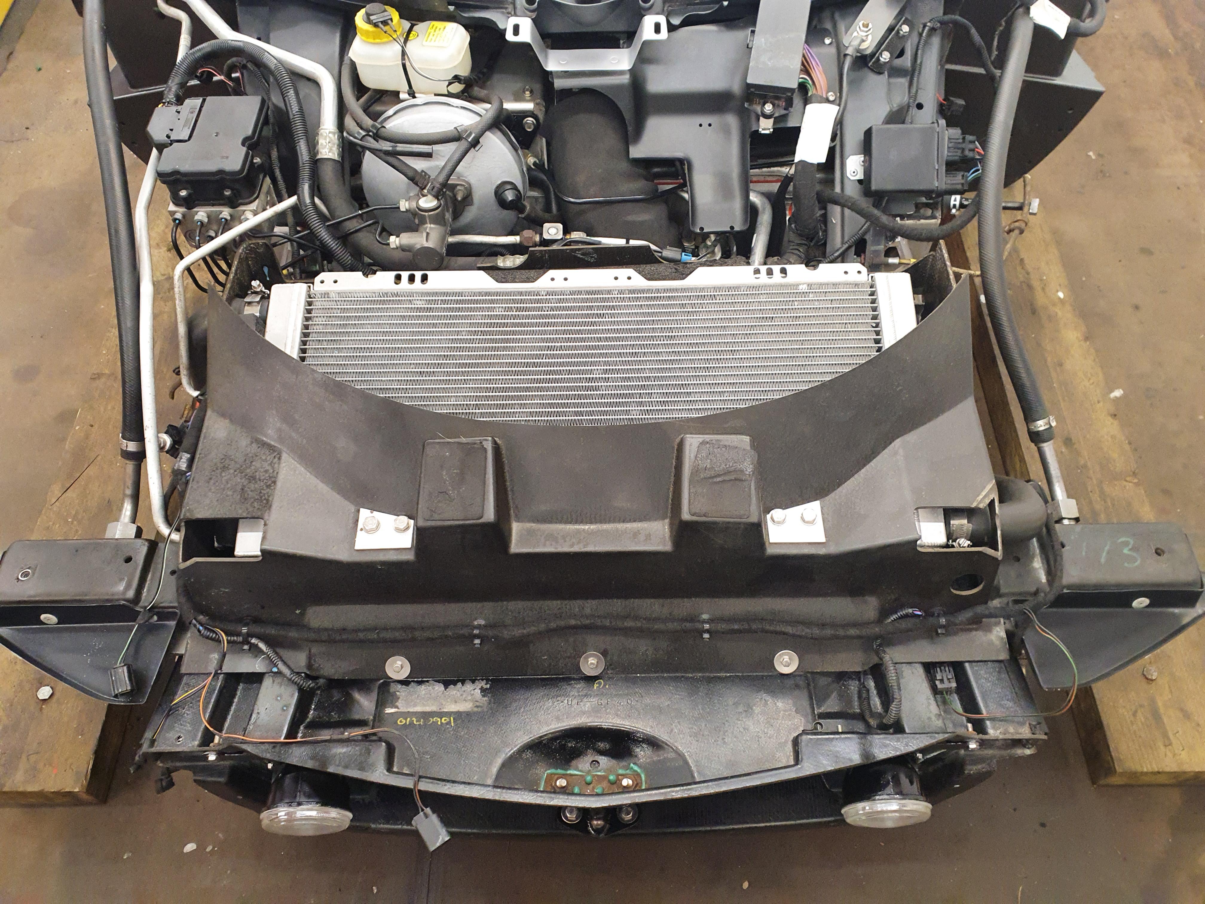

I reached another goal this weekend by getting the front heater and radiator area finished off.
This is before

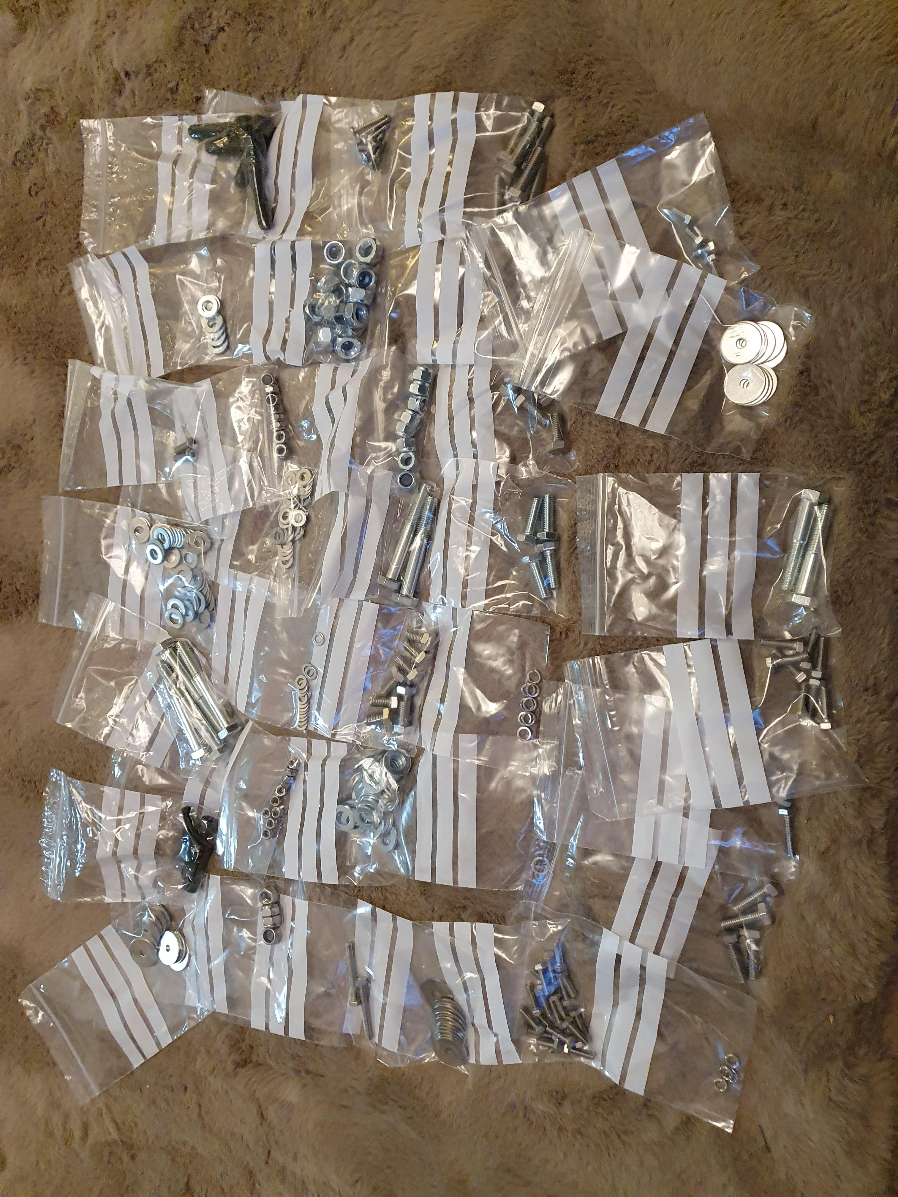

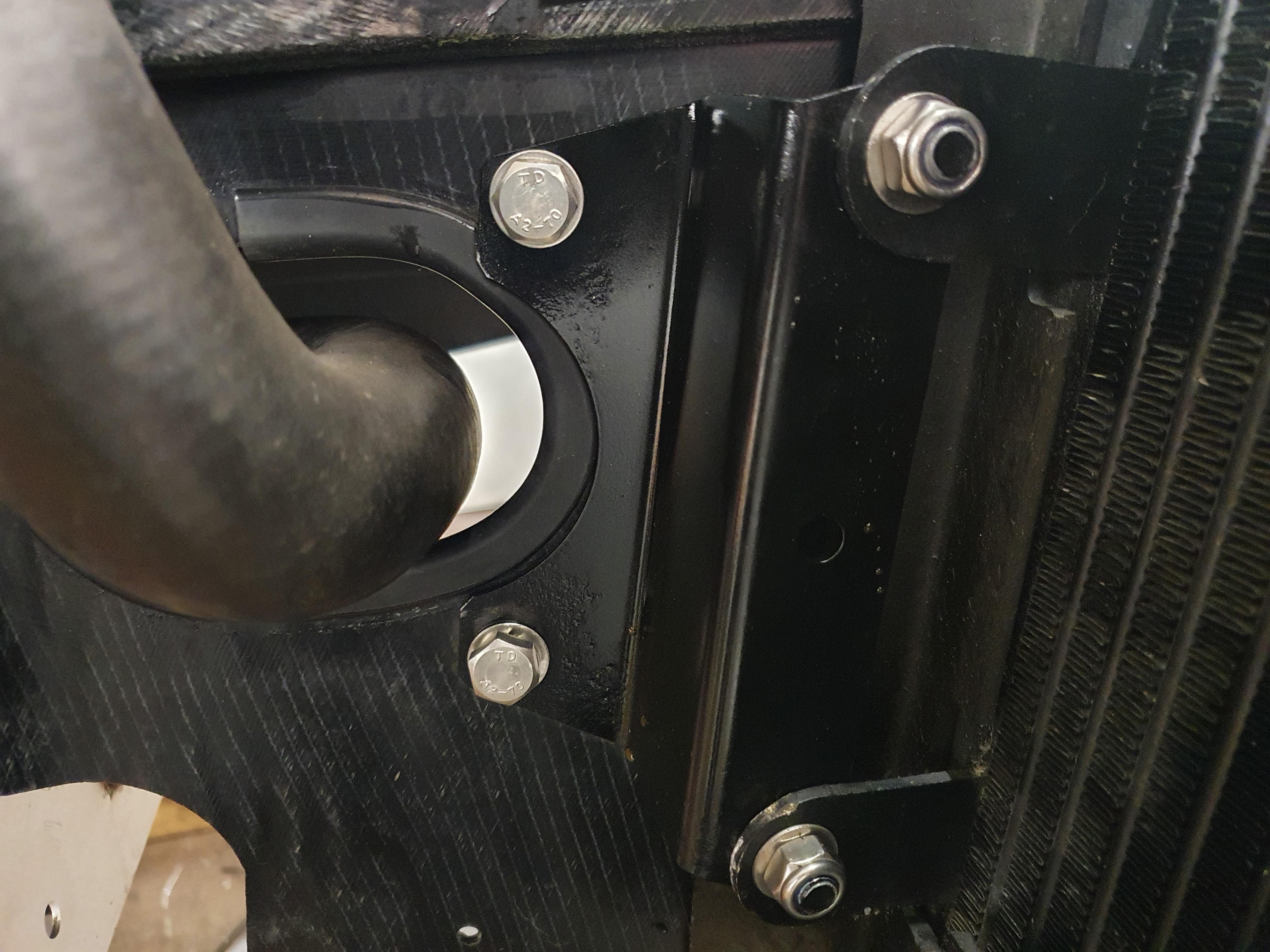

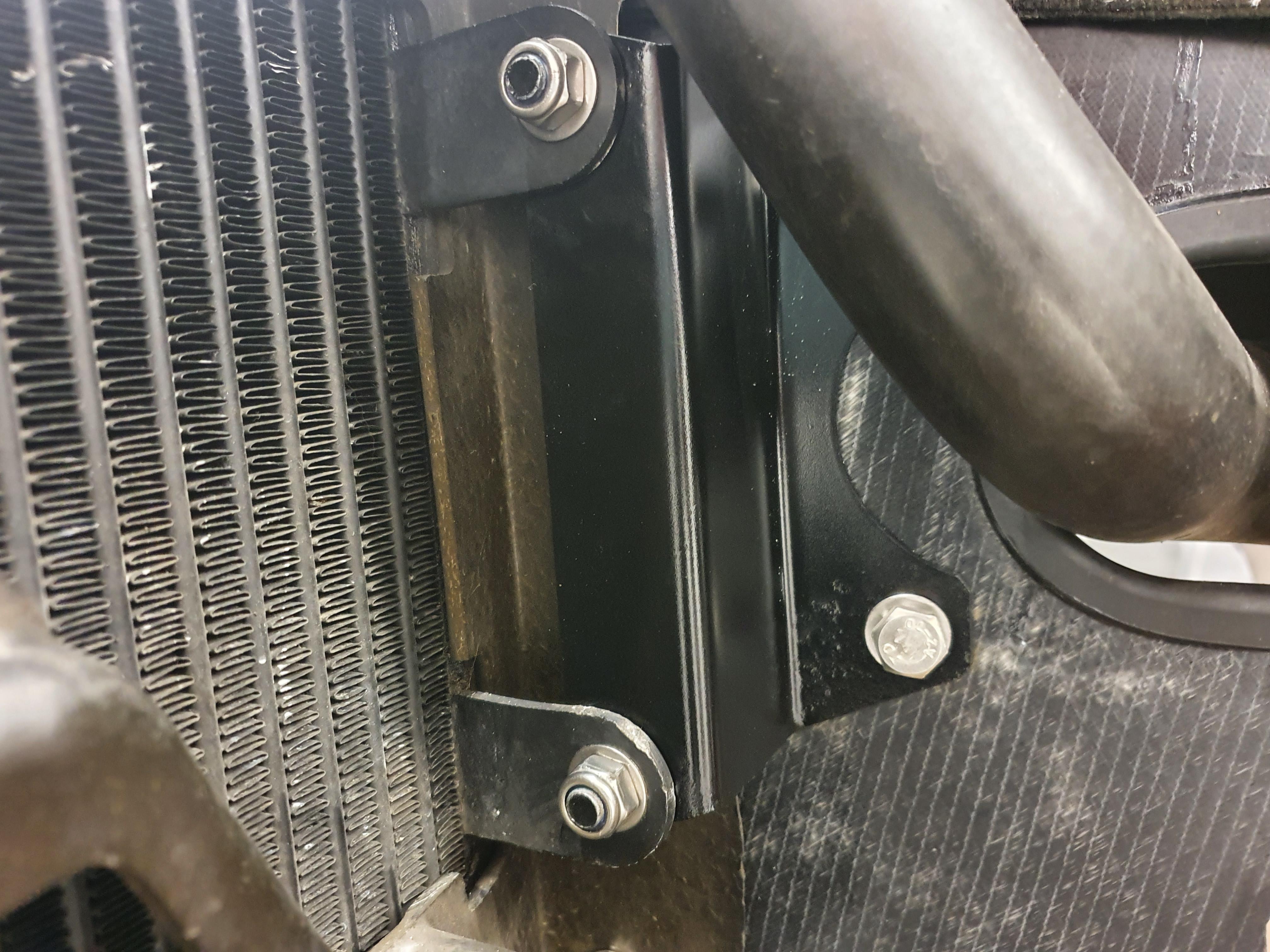

All new bolts for the front compartment and suspension.

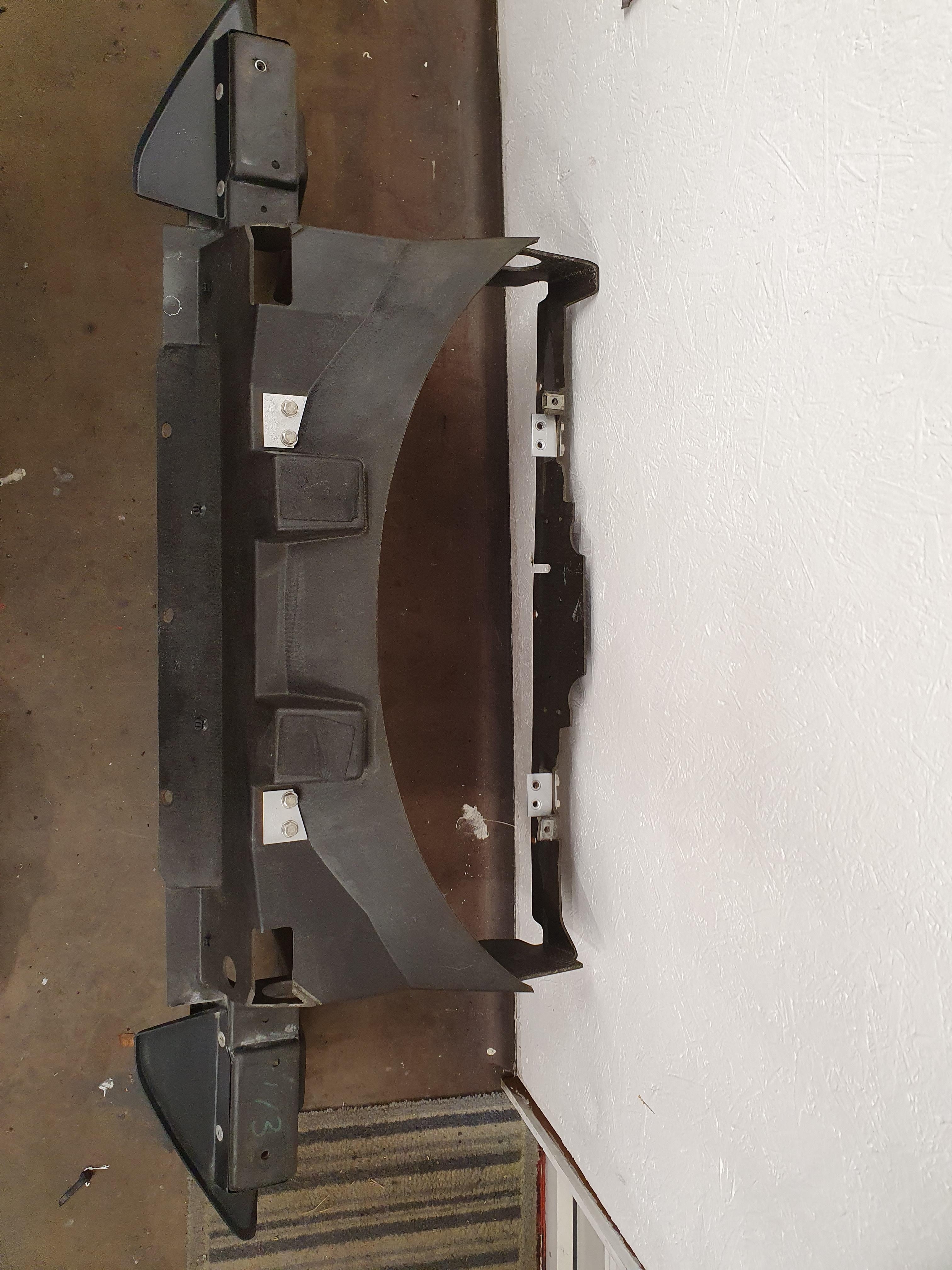

Restored radiator mount

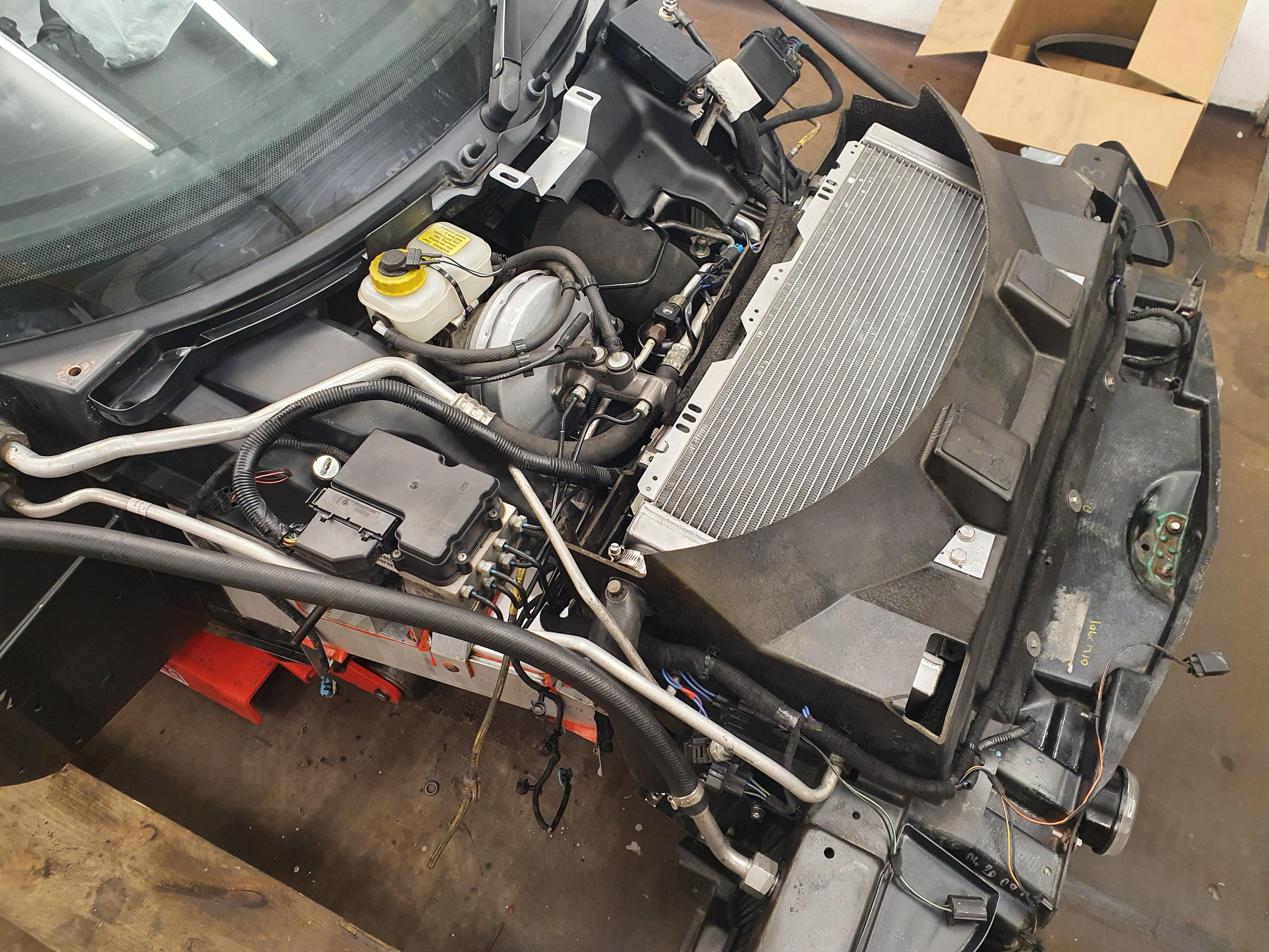

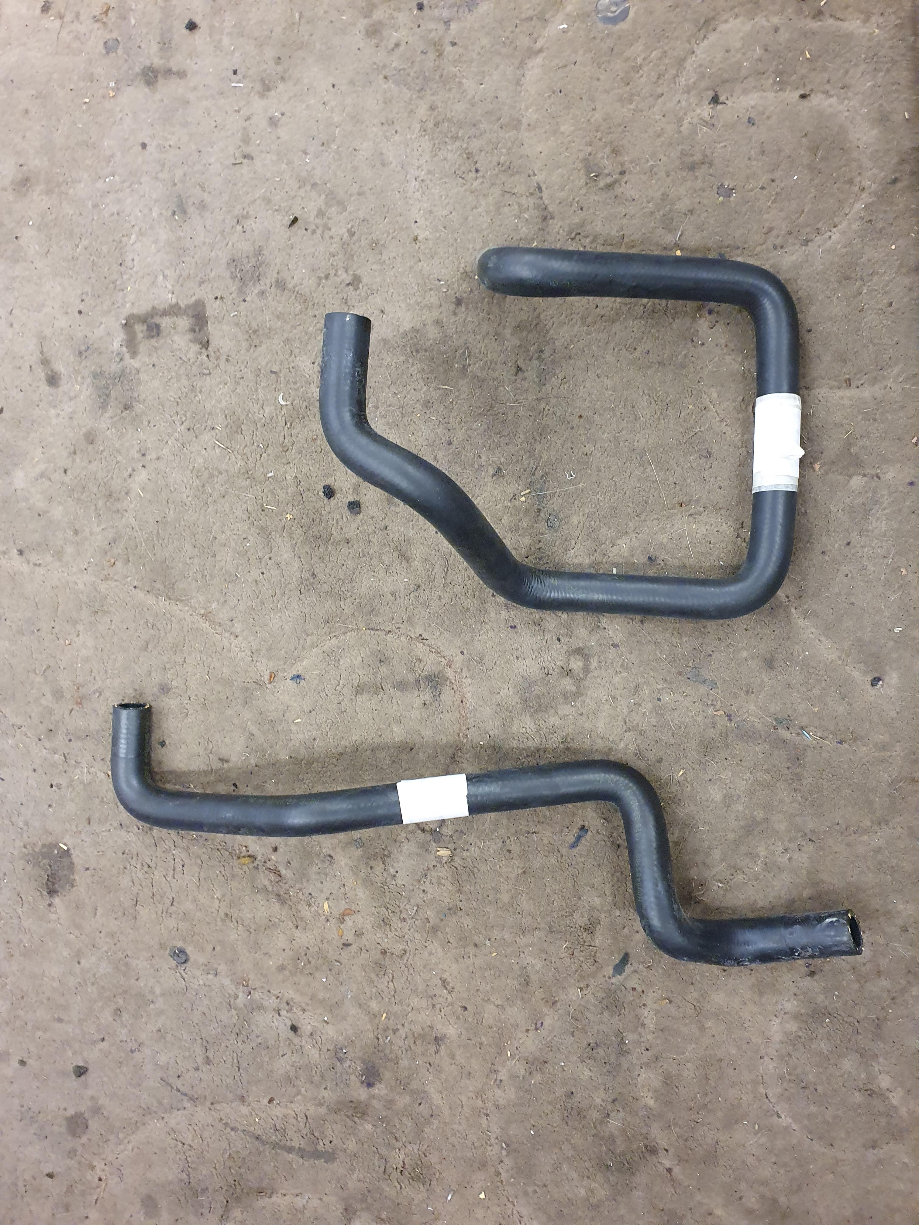

No chances taken so new heater hoses.

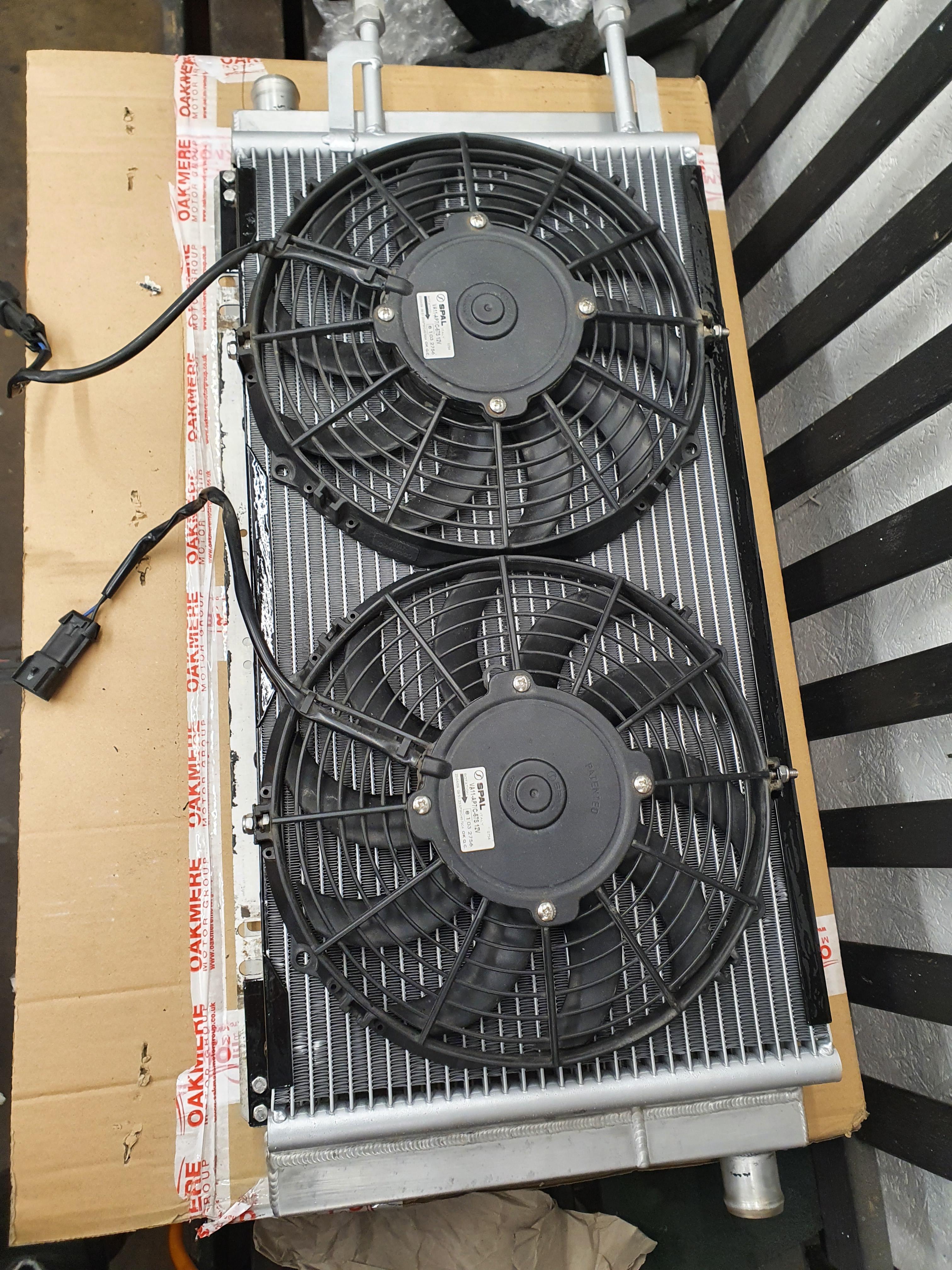

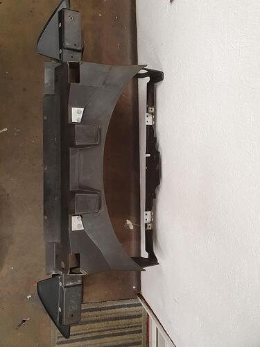

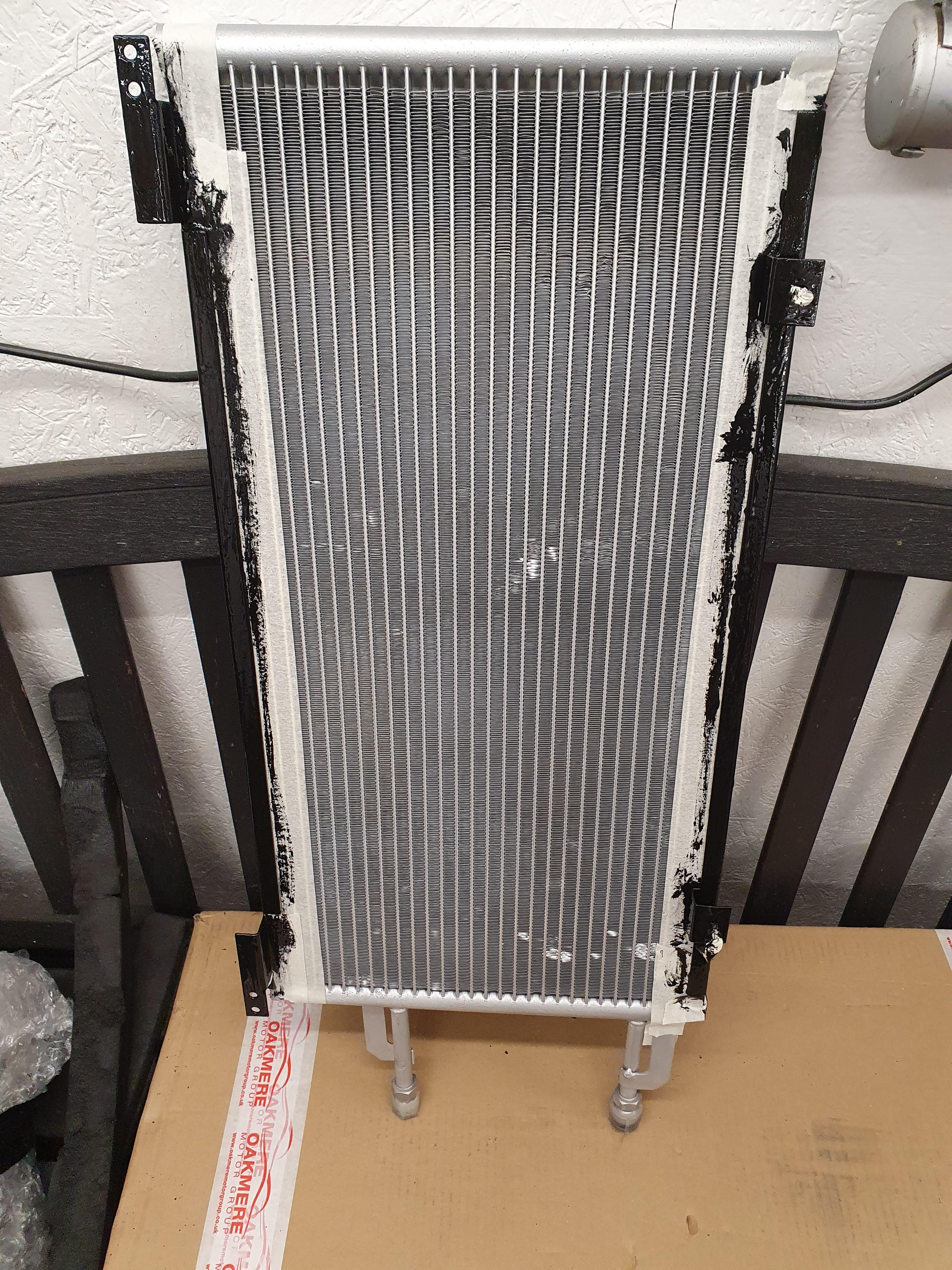

Although the new condenser came painted i gave the black brackets a few coats of Rustoleum for added protection

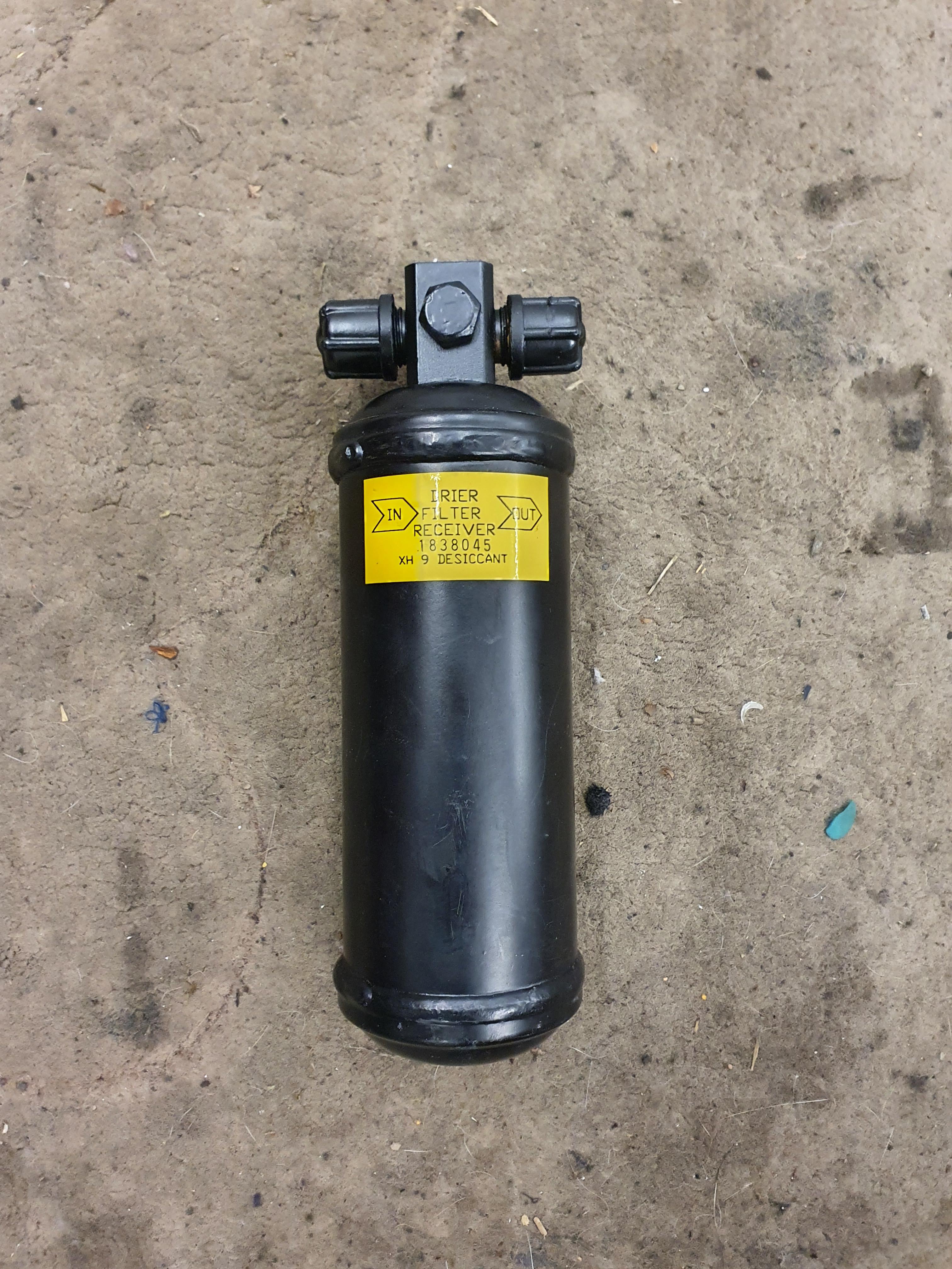

New receiver dryer installed for the air con
All mounted into the radiator housing
I used a friends air con gas machine to vacum the system, and refil with oil and gas. Once the cooling system had been filled and bleed i ran the aircon and it was lovelly and cold.
All the oil cooler brackets and oil coolers re installed with new bolts.
Finished results but happy with how it has come out now to focus on the front suspension.

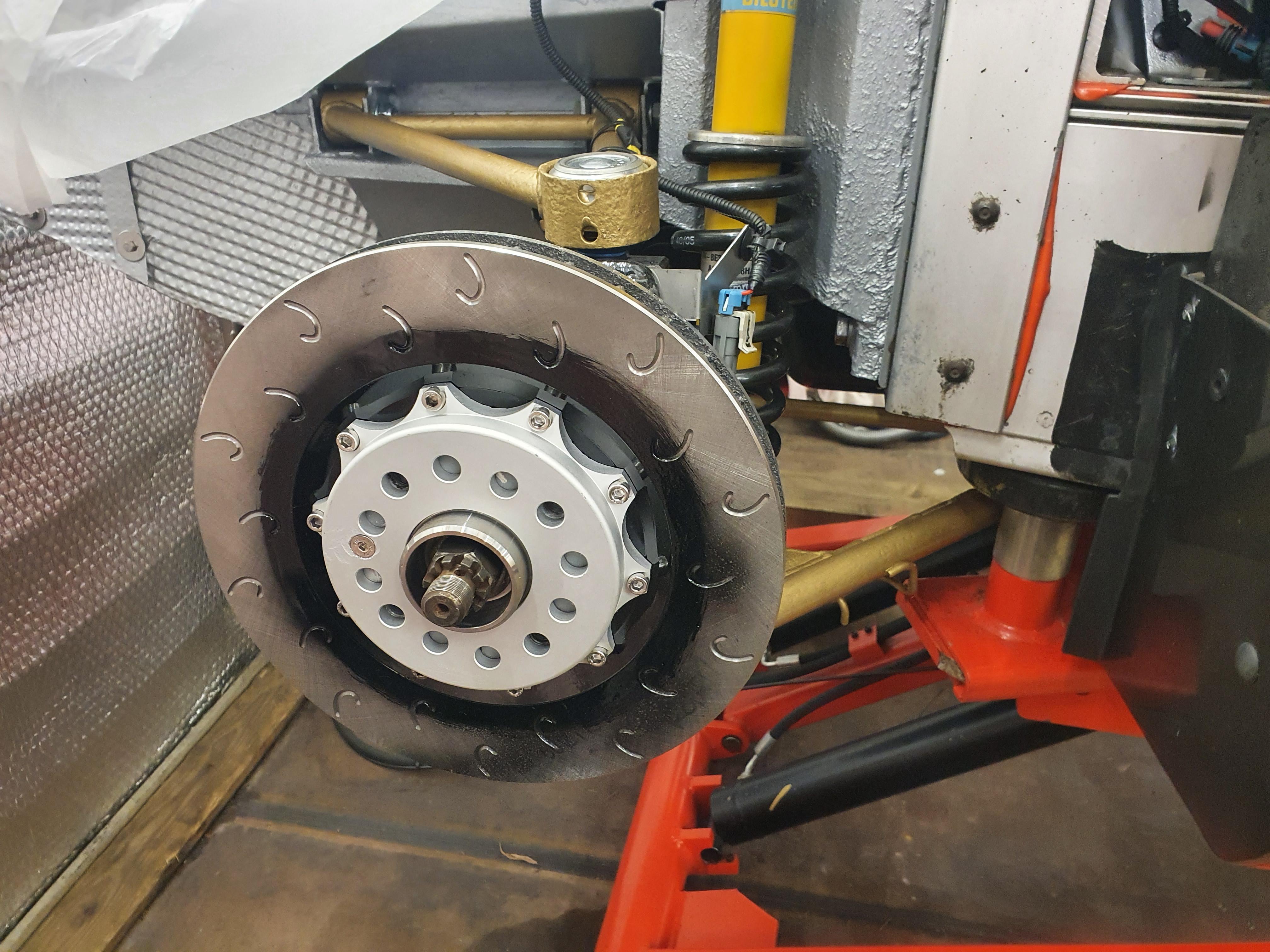

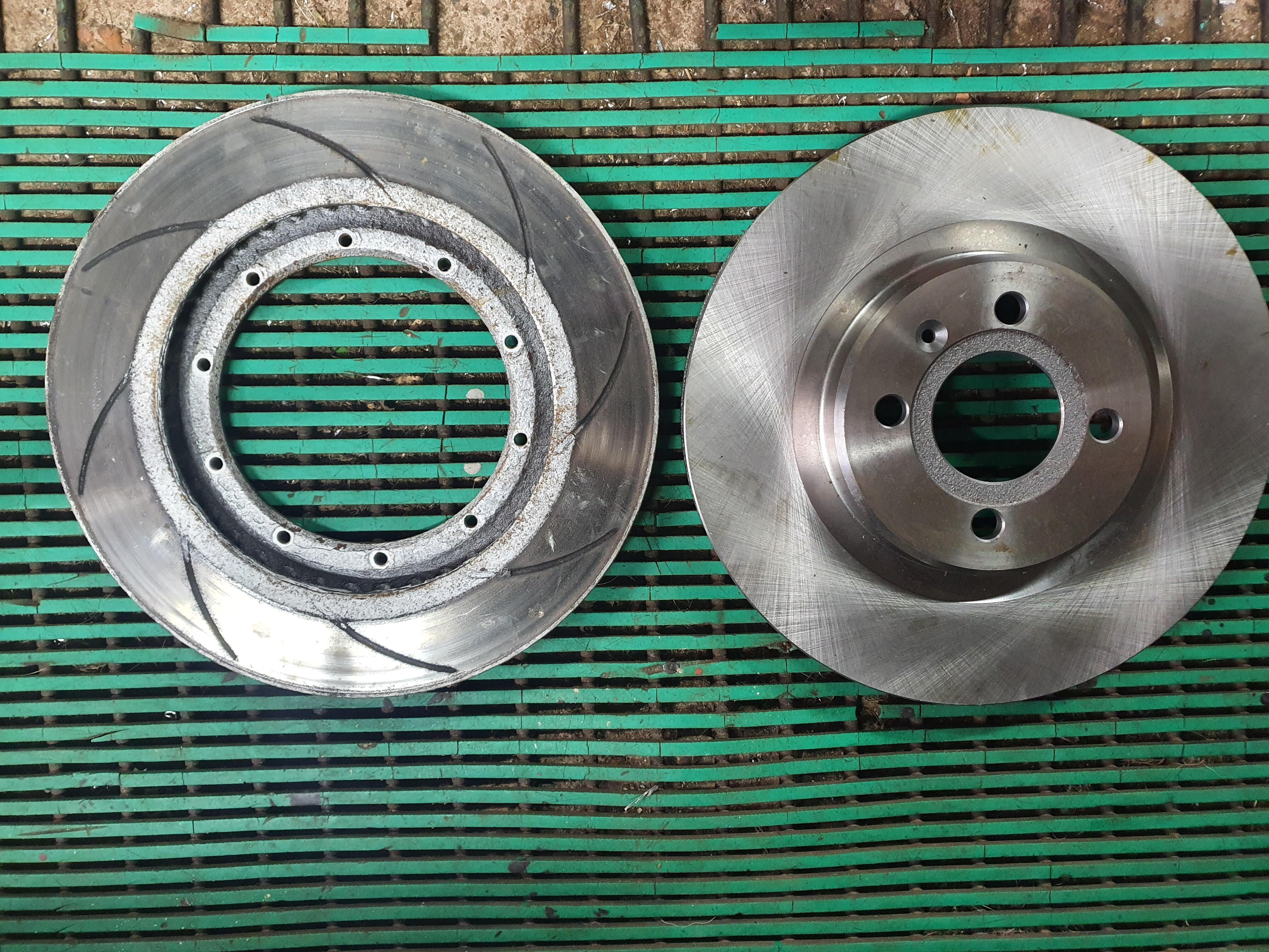

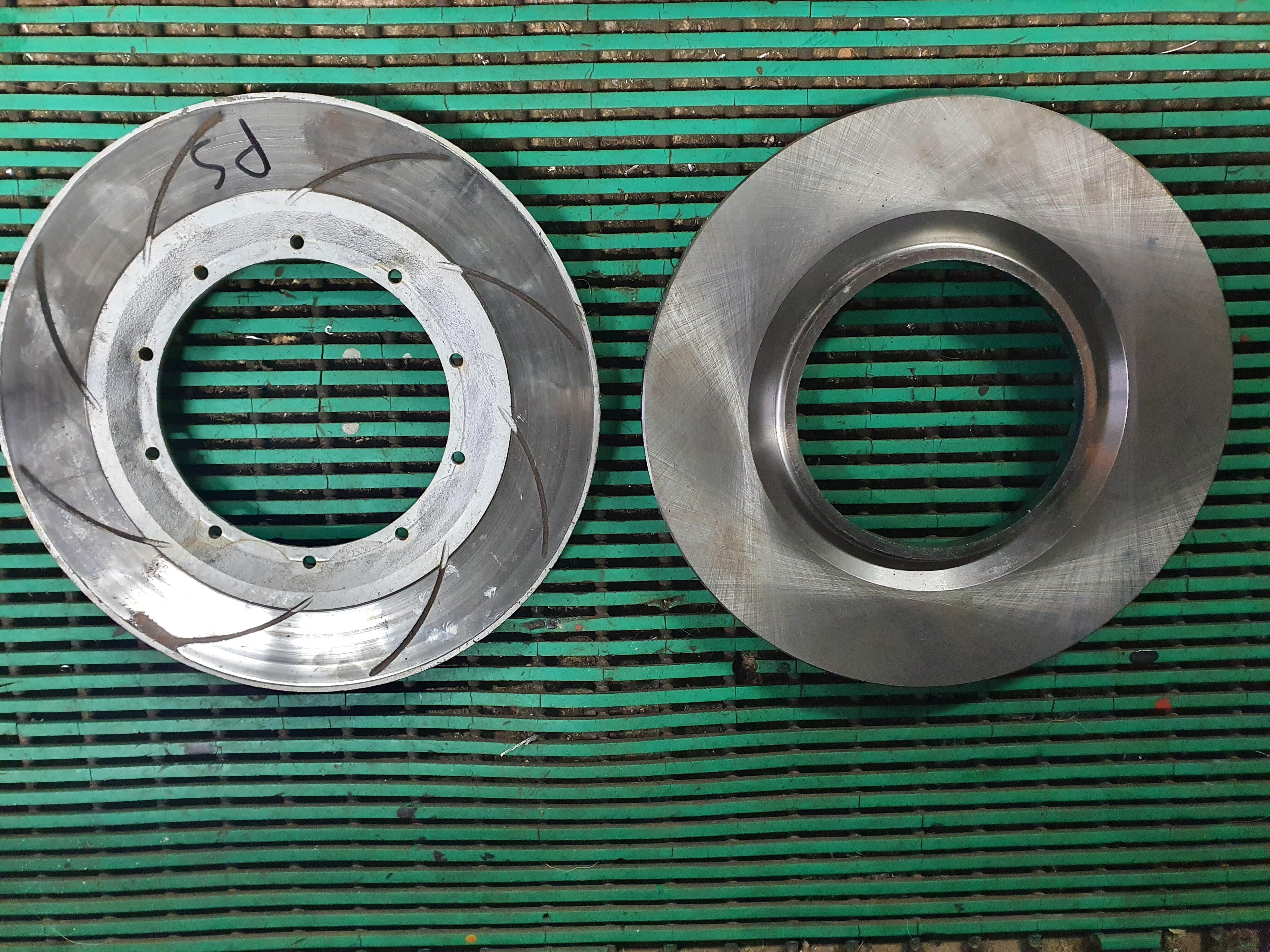

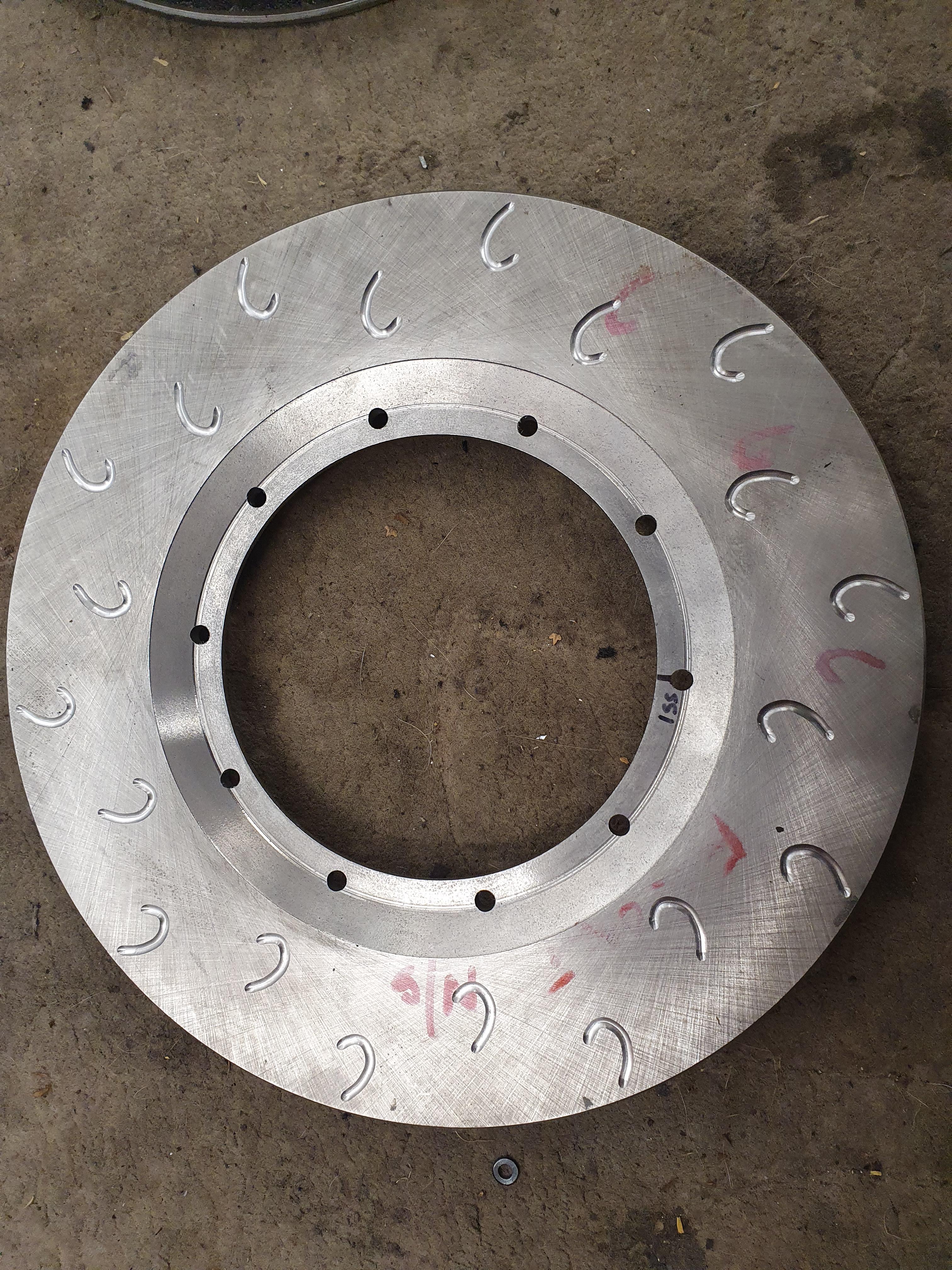

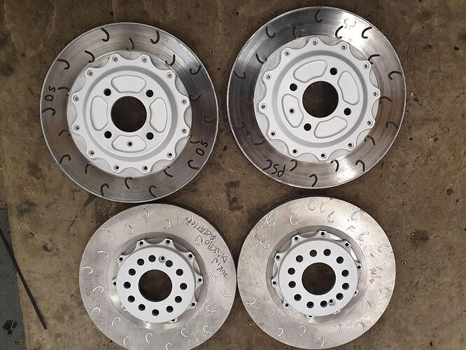

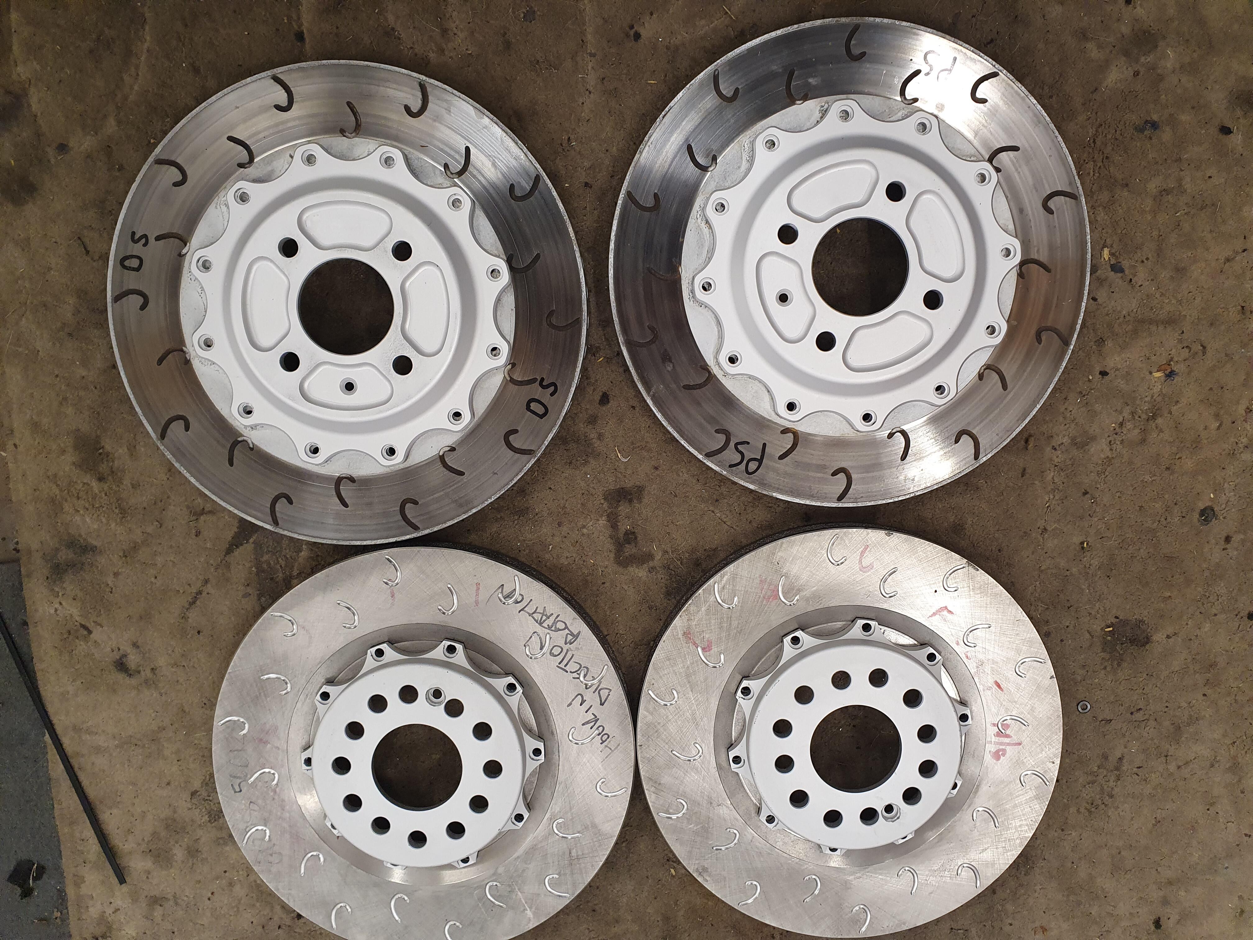

Something I am particularly happy with from a cost perspective are my home made discs.

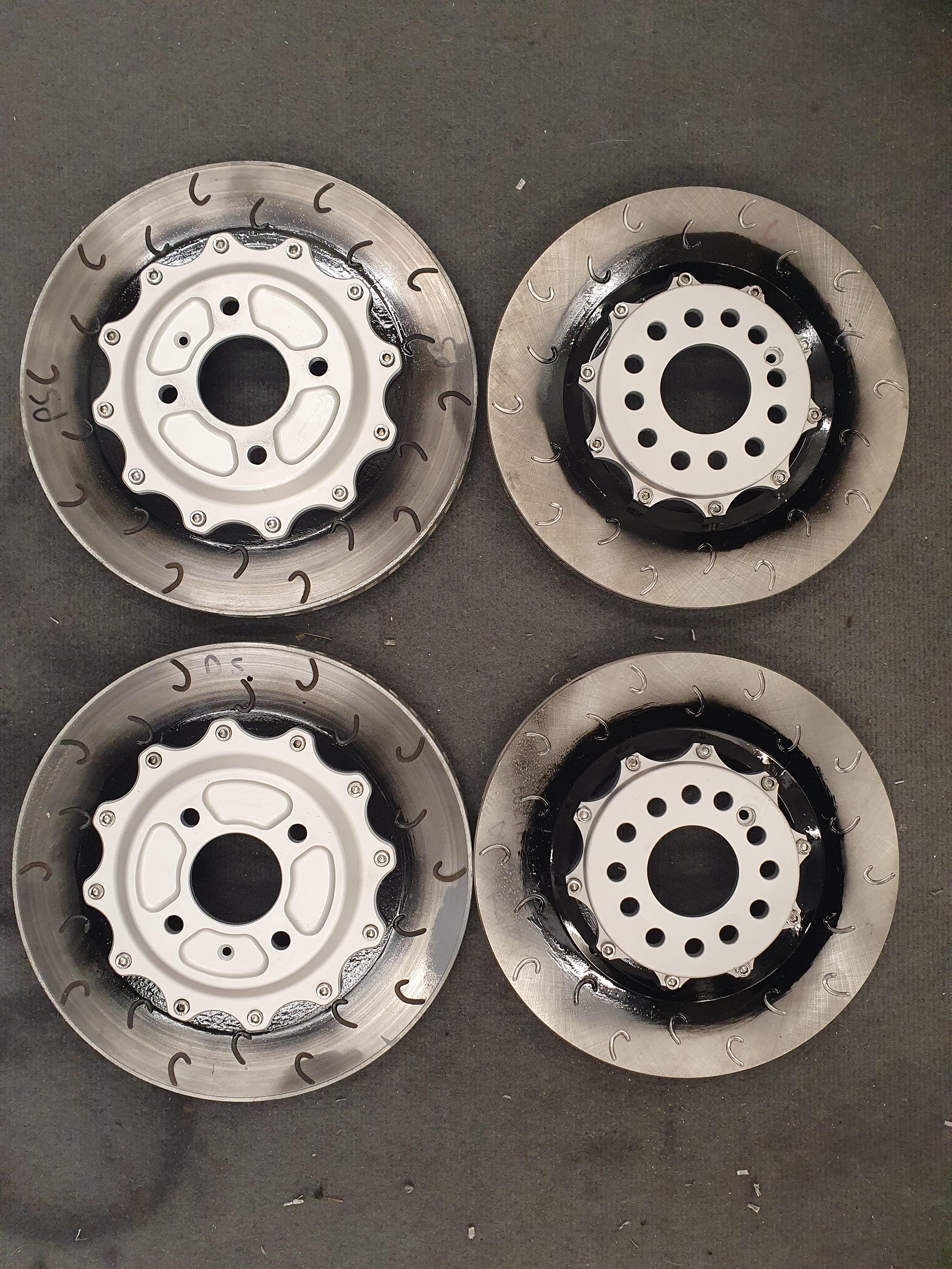

My rear discs had seen better days, and they also did not match the front 308mm J hooks.
Some basic plain discs got the middles machined out as per the originals. These got perfectly balanced with the alloy bells.
The J hooks got machined into the faces to match the fronts.
The alloy bells got re anodised from black to silver.
Nice coating of VHT paint to the parts that dont touch the pad and can rust.
Just awaiting the calipers but thats another thread.
