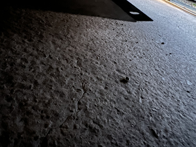

In tonights episode of that will only take 5 minutes but takes an hour : Idle control
I whipped out the laptop, connected the USB and lowered the target idle. It wouldnt go below 1350ish RPM.
That means one thing - I have the idle stop screw too high. Break out the 8mm , loosen the nut and wind down the screw a tiny bit.
Get in, target rpm met.
< metallic noise meeting another metallic object sound >
No problems to report though so shut off the engine and powered down the laptop.
Ill just tighten up the 8mm argh. Its in the bay somewhere.
Cue taking the undertrays off to find a bloody nut. That was fun.
Impact driver does most heavy lifting
Undo everything
Wack the undertray as its held down to reveal the nut
Fitting is reversal of the undoing.
Its ready for map tweaking now.
Could be worse.
Where the hell has that nut gone? Sod it, map tweaking time! What the hell is that noise/loss of power?
Ahhh,found it! :sob: :sob:
