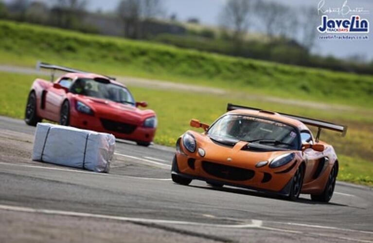

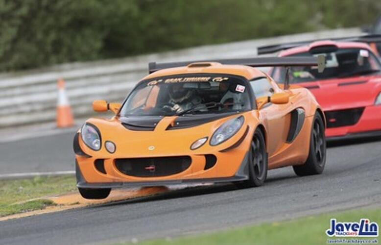

First time at Oulton Park yesterday and loved it, car was awesome :blush:
Great pics, looks like you are really pushing on.
Did you find the source of the noise during hard right turns (I remember you mentioning it previously)?
Was certainly giving it plenty.
And yes! Was my OSF tyre rubbing through the arch liner :joy:
Lastest update. I bought something.
Carbon canards. I likey. Bit more aero supposedly and the carbon matches the other exterior carbon.
Then took it to blyton again yesterday for abit of fun with a few mates, fun day and a couple of hairy moments but was a great day out!
@Jake Looks epic and you seem to be committed in some of those pics.
Is that why your rear lights look dirty? :wink::wink::wink::wink:
