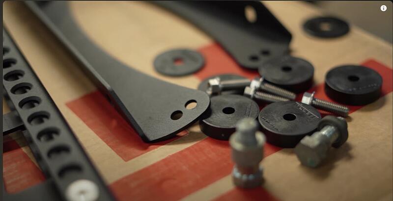

Have you got any plastic spacers/washers between the seat and mount?
Got a washer bolt to mount, but nothing mount to seat apart from the metal fixing which is on the seat.
Do I need a washer that side too?
I had/have plastic spacers to fit between the seat and the rail.
This is from the video located here : https://www.youtube.com/watch?v=CTIpnNIFuQg
I am struggling to find the instructions at the mo online
Found it
Fitting.pdf (3.7 MB)
Wow very technical, I’ll pop a couple in. :+1:t3:
Thankyou
