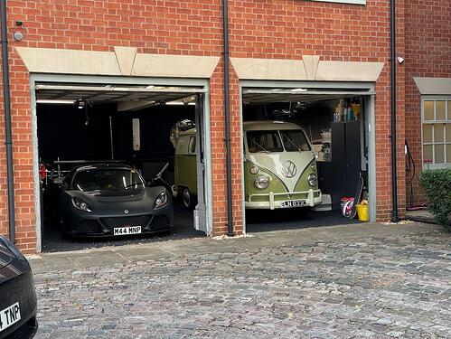

Natural stablemates… :wink:
Just caught up on last few updates. Car looks great at Donny. Had a tinker with alignment yet?
Thanks mate! I was in a rush before my track day, so just took out all the camber shims on the front and got about -1.5 degrees. It seems much more convincing now - very confident through the corners… I’m actually going to be spending a bit of time on my ‘bus’ now so won’t fit my new steering arms for a bit, but having the alignment strings is making me feel much more comfortable with fiddling - at least I know it’s all aligned nicely at all times!
I drove the VW for 4 days then got back in the Lotus and nearly crashed it the first time I turned the steering wheel - the difference is so utterly mind-boggling between the two! It obviously stands to reason that it’s a very different machine, but the stark contrast is stunning! It feels like a flipping fighter jet, lol!
