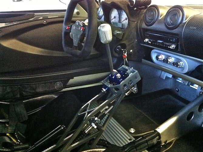

Naked Short Shifter
No it’s not a dwarf on a pole but an erection set with a kevlar disco ball

I can see it try this… Finished and installed… :smiley:

Looks great in that colour Frank. I’d still be worried about it flexing side to side.
What shifter is it, is it like the Ikea shifter in that raised housing?

It is very ridged fore and aft with enough give into the design to allow for a side impact if shit where to happen…I would rather replace a shifter than lose my leg… There is X bracing in the lower section you can’t see in the photo…
Thanks, I took a Porsche B&M short shifter and built the scaffolding to get it in the proper position. It took a little R&D and a sourcing better cables to give it the direct feel it should have…I had to also change the gearbox linkage to a push/pull vs pull/push…

I had the ikea shifter when it first came out, what a freakin pain to dial in…sorry Sean
Once dialled in though, its pretty spot on.
