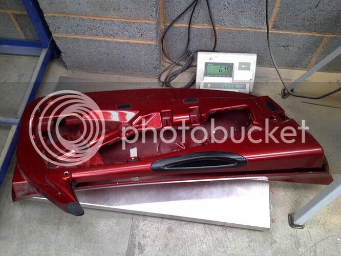

Ok so here you go, Rocky at UK Lotus Centre has lent me some doors to take apart (Top Man). Manual winders, none central locking. Glass out, beam out, winder out, locks out is my preferred order, 20 mins per door and excellent service manual info.
6.15kg’s

The TW Auto CF door contains all the necessary brackets (or extra strength laminated areas) as bonded to the inside of the OEM door. So there you have it 3.5kg’s per door (7kgs total).

Now you�re laying it on pretty thick there Jonny Boy, the doors were not purchased (at a similar price to OEM, and I can sell mine on) for weight reduction alone. I’d hoped for about 5kg per door for the record, however 7kg’s is 7kg�s and will drop the motor into the 830’s (just :wink: lol) for now.
