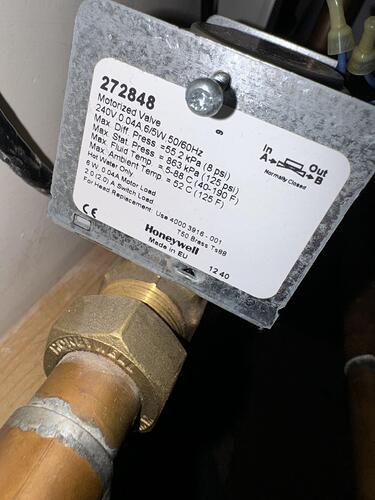

Today I changed a heating system power head.
Just before I went on holiday I noted a rapid clicking sound from one of the Honeywell power heads.
The IT man in me turned off the power and back on again. Voila , fixed.
Or so I thought. Yesterday I noted it was Baltic upstairs. The thermostats were below their fall back temps and asking for heat. The boiler was happy to obliged but the manifold wasn’t seeing the temperature.
The power head was again clicking.
Off to Screwfix today , bing, bash , bosh , circuit tripped, adjusted , fixed!
