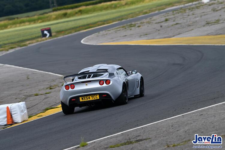

These images were taken from the Javelin paid photographer …
Some great pics there, fellas
Not often you get to follow your own car. Someone filmed me!
