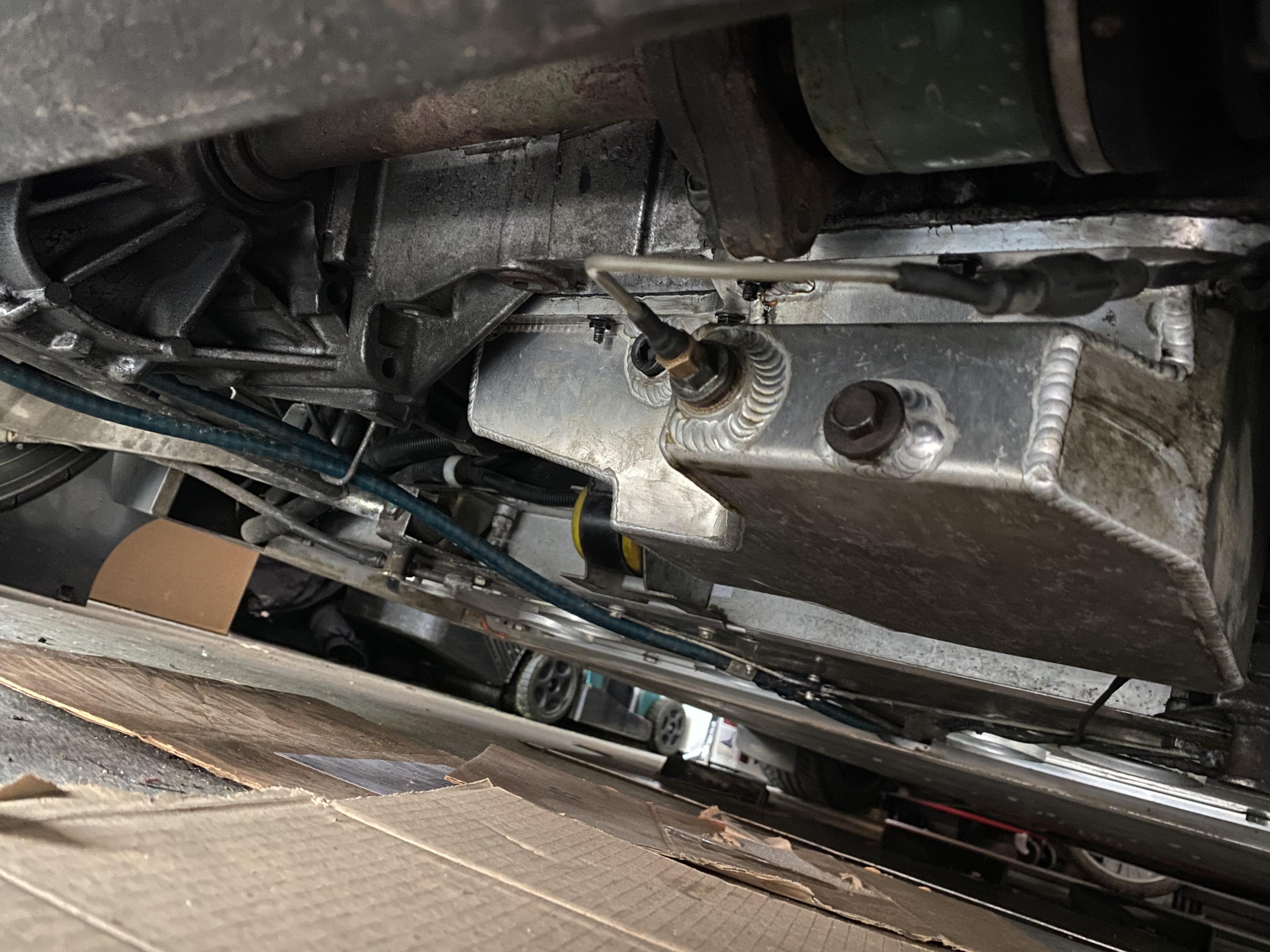

I just cannot get access to anything ! I can get my hands / eyes on the sandwich plate and oil filter ( no leaks ) , top of the block ( no leaks ), and around the sump ( no leaks ) but not the oil dipstick o ring of doom or the 3 bolt plate that goes to the rocker breather. It has to be one of those two I feel.

I have identified what I think is the leak. Its what I can only describe as a blanking bolt in the sump. It appears to be weeping from the copper washer thats just infront of the bolt. A found a drip there , and only there. It would make sense as the bolt is at the lower part of the sump, where its angled down and forward and the oil would run.
My son was out with me and he was checking everywhere and that is all we can come up with.
Picture of the offending bolt on my 3500l sump ( I am being factious , its just a massive sump )
I do not plan on doing an oil change for around 9 months , so I might bodge it with some RTV for now and look for a more permanent solution when I have the oil out.

My “attach of the RTV” was mostly highly successful. Enough for Lee to ask do I really want this doing.
As two bolts were knackered and I have a trackday on Saturday I thought what the heck, lets get it done.
Its now leak free with a new liquid gasket in place so roll on Saturday
