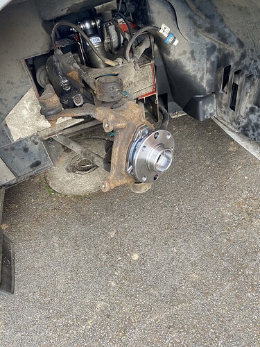

I have now changed the hub. I had ordered new hub bolts and got them earlier in the week.
I undid the old ones and left them a few mm proud and went round hammering them in turn. The hub eventually came out.
Cleaned it up and put the new one back in again.
Now I know how to do that one , I might just change the nearside just because.
Good work, glad the ā€˜whack it’ technique worked.
Did it hurt you as much as it hurt me to bolt such shiney bits onto such rusty crud? Had to resist the temptation sooooo many times this winter to rip it all off and get it painted up nice. :mrgreen:
Yes, the pain was real when placing the magpie shiny metal back on.
It really looks worse in the picture than it is .
I cant decide if I should use bed liner paint for some por / dinitrol stuff …
