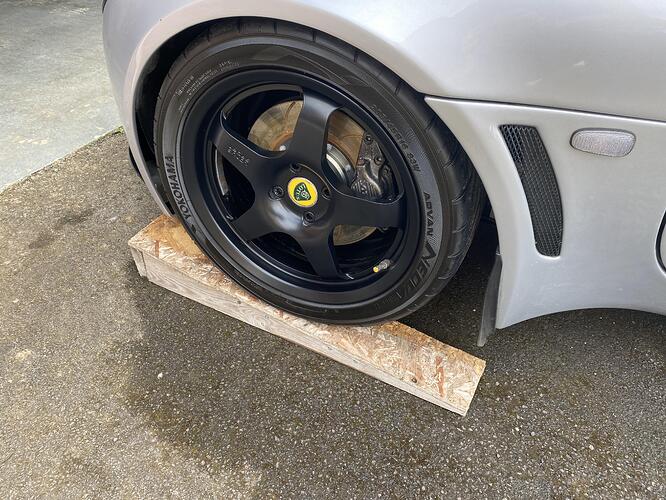

So came round the doing the front offside hub today. I have had a wrestle with the bolts that have been in there since what I can only assume day dot. They came out with a bit of a fight and me doing popeye impressions.
Strangely one was 19mm the other two 20mm. That normal?
I have cleaned them up with a wire brush now.
I ultimately could not get the hub out. Its seized. I need a hub puller I think ( [mention]Fonzey[/mention] )
Car is now back together again
Few pics …
I had eldest assisting me with spanners/sockets and youngest cleaning the inside of the wheels when off.
The mismatched bolts doesn’t sound right, neither my Exige or Elise had that - all were 19mm (I think).
As you’re doing the front hub a puller won’t help much tbh, the puller that I have is for pushing the stub axle out on the rears. As it’s the front, you should just be able to brute force it off - either hammer on the back side of the face of it, or there are some small chisel/pry notches built into the hub itself though they might be covered/masked by rust by now. You could also put the bolts part in and smack the bolts in turn from behind with a hammer, but only if you have some spare bolts to use in case you mangle the threads.
Maybe see if you can spray in some penetrating fluid and leave it a few days, then come back to it and bray the arse out of it and it should come out. Maybe :mrgreen:
I have attacked it with brute force and ignorance. I had a 27mm socket over the back and smashed it a good few times. It went no where!
I dont have any spare bolts. I should order some
I didnt know about the pry marks. Ill take a look over the coming week. I have precious little else to do ! :frowning:
I had a real mission with my elise tbh, I think eventually I ‘walked’ it out by half screwing in the bolts and tapping (smashing) them around in sequence. Obviously once it goes, it goes - so make sure the young’un isn’t in the firing line or you might be joining the NHS queue with a half-child/half-machine :laughing:
The bolts go through the carrier though and then into the hub. Wont I shag the threads in the carrier?
I am favouring the bray it until I cry approach from the rear. Or might even make a leaver and turn the steering wheel?
Should be no threads in the carrier mate, just a ‘raw’ hole.
I’ll be honest I didn’t check! I have ordered some new bolts so I like your idea of rotational braying
I think I expanded my hammer collection when doing this for the first time, so feel free to treat yourself to some new garage bling.
Ha! I’ll look up hammers, really big hammers and shiftyabastard hammers.
Think you’ll need to get it off the car and onto a bench otherwise you’ll be doing the ball joints no good.
Thats plan b @evo_ufo
Have been told that Lotus tend to put the 3 bolts back in to 5mm proud and go round wacking them until it cracks.
If I cant get them out Ill take the carrier off , send it away to be powdercoated and put the hub back in.
