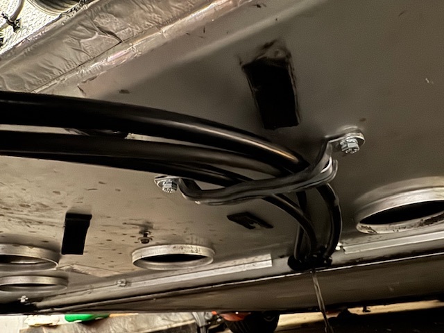

Made the last oil line, number 3. Also in a Fireseal hose to prevent more heat in the engine bay and under the super charger/alternator etc. Still need to make brackets so that it does not touch anything but this is the best route for it. Much of clearance around brake line and cooling line.

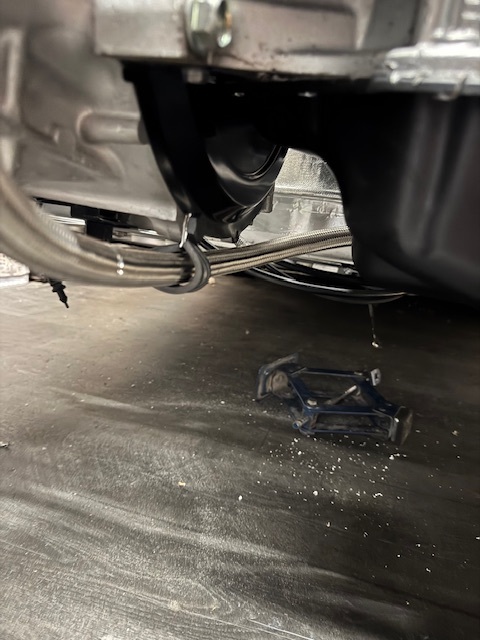

Shear panel back in, also having a nice view at the oilpan/sump and some other adjusted items :wink:

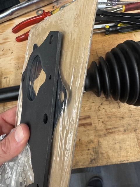

Nose bracket on the JRSC did not fit. Got the tip I needed a thermal gasket as it is thicker and helps on IAT. And there is the gasket. At least the same thickness as the recommended Hondata one as the Hondata one will take ages to get. It is PFTE.

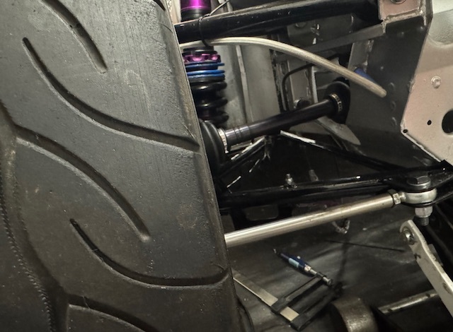

First driveshaft is in.Need to make brackets for the brake lines and some other stuff.

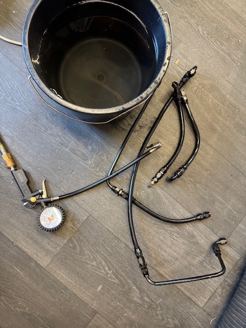

Made the final fuel lines and pressure tested the new ones and retested the old ones. 7-8bar on the line and keep them under water. Pretty simple. Fuel pressure is 3.5 bar so should be fine.
And mounted it all

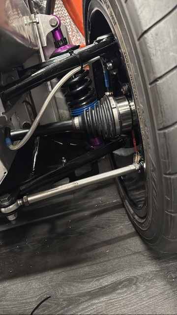

And the new driveshaft arrived (left)
Made by a company that makes driveshafts for rally/rallycross and they made this with the same methods for strength

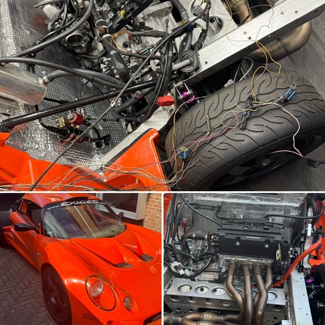

  • Did start on remove all parts from the oem throttlebody to clean it. IACV was stuck so ordered a removal plate from aliexpress , exactly the same one that is being sold in Holland by all kind of Honda companies for triple the price. Will run fine without IACV and a slightly higher idle might help pushing more coolant around (next to the seconday EWP that is already installed and working)
  • ordered a early S2 exige throttle cable.
  • Waiting for Dan/HPE his engine mounts. Will order them once he has stock. Looking forward to those!

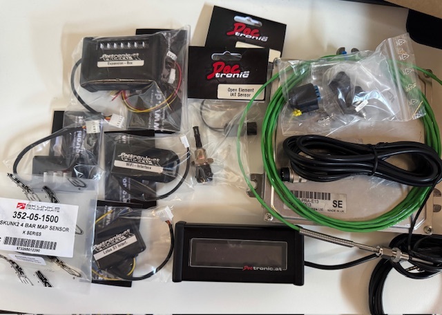

  • Printed the electronic scheme and pulled out Doctronic ecu and all gimmicks so I can start once I rolled the car out of the garage to make some room and clean it a bit.
