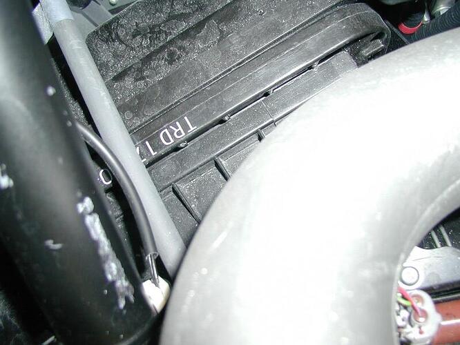

i think the 2007 cup car uses a much larger Toyota sourced airbox and filter.see this thread on a U.S. Cup 255…
All things considerd i would think this would be a better direction than the aftermarket.

what about putting the cup255 airbox and filter on?..from the elietalk thread they seem to reckon its a tuning part (TRD) from a V6 Toyota.
Is the std map likely to be able to cope? It would the semm the MAF would remain the same.
As its a validated TRD part then I’d hazard a guess that it would work.

the maf characterisation may be different betwen the Toyota and the Lotus ECU so I wouldn’t say for sure that any mods which work on the Spyder would neceasrily carry across to the Exige.
