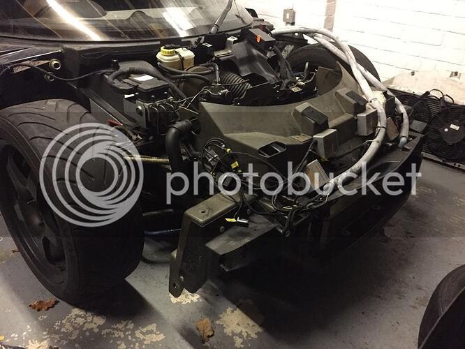

Resurrecting this thread as have a few plans this winter, and I’m sure you’d like some pictures of an Exige in bits rather than more Caterham talk :slight_smile:
Shiny new 50mm triple pass radiator, thanks Dave.
Was supposed to fit this last winter but never got round to it. Had some time off this week so spent a few hours today getting the clam off and the previous rad out.
I’ve also removed the now redundant oil coolers. They had been disconnected a while ago when the car was moved over to a laminova, but this was the first time since that the front clam has been off to allow the coolers to be removed.
Deciding whether to change the Chargecooler pre rad as per the other thread.
What are your charge temps? Mine use to hover around 5-10 degrees over ambient and were always very stable. How many pumps do you use? I had a push and pull pump on mine which helped over the original single pump Proalloy supplied.
Finally been back to the car and got the radiator fitted and bled through.
Some top mount fans.
Typically the fans don’t have the right connectors on them so will need to sort that out.
I really need to replace the foam packing between the crash structure and the rad. Any ideas on the best place to get some replacement foam, and what would you use to stick it to the crash structure?
I bought the sticky foam on eBay when I did mine, bought several different heights to make sure I had a good seal.
