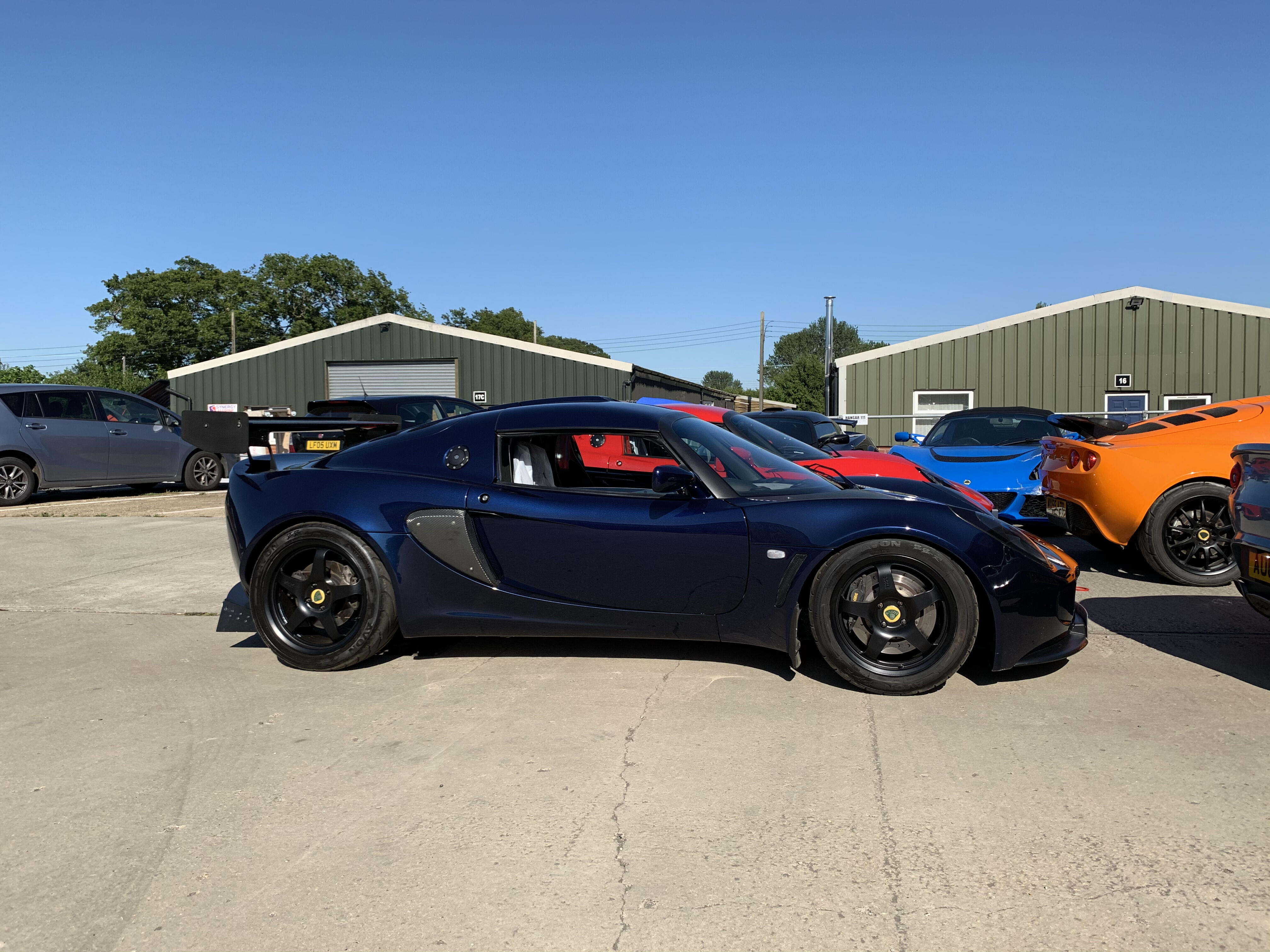

Back at it again.
Looking good ,Will. Love that colour (and those wheels)
Great news Will, looks mean in that picture.

Got the car out of storage over the weekend. Looking great after the wheel refurb, and having the sills tidied up.
Got the sills fully PPF’d this time instead of just shark fins.
Really should sell, but can’t quite bring myself to do it.
Best thing is probably to advertise and see what interest there is.
Looking really good
Is that Nightfall Blue?
Cracking colour, plain and simple. :thumbup:
Thanks yes Nightfall. Fantastic colour in the sun. Really pops.
Only the second one I have seen, the first being Andyzim’s, and both look amazing, and this is only seeing photographs!
I am sure it will be HARD to let go…
