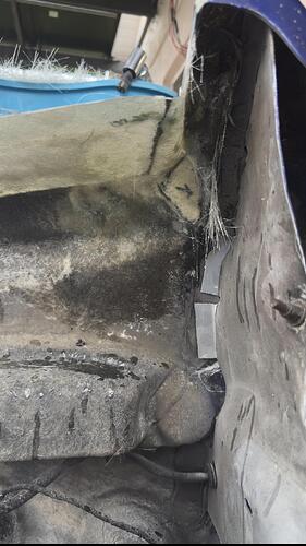

In the meantime, I have patched the last hole in the rear clam…it looks messy, but just a good sand should help.
Next is to sand the repairs on the outside and check for any areas missed. After that, sand the inside and add more chop to the inside for strength and clean up. I think the rear is almost there!

Last night I put down a couple more layers of chop…yes, I see the air bubbles too…and as much as it pains me, I feel it will be ok. Next steps…sand down, inspect to make sure I did not miss anything or areas that require additional support/glass.
