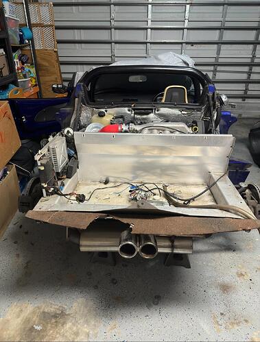

I know what most are thinking…well, you do a horrible job at describing any damage…where are the pics!!
So, here you go…I am sad to present…The Damage
Ordering didn’t go as planned, but hope you can follow the flow

Minor updates…sanded the rear clam a bit last night to try to start the repair
Next was to remove the heater matrix pipe, it’s a 16mm (American size is 5/8)…doing a high temp silicone tube with double clamps on each size
Finally, each time I filled up with fuel (petrol) , I noticed a smell of fuel in the cabin…well, here is the issue!!

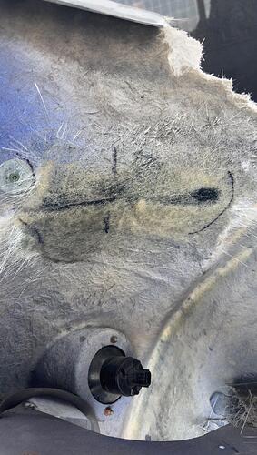

Started on some fiberglass repairs…I am not an expert and taking my time to figure it out. My main thought is to get the some what minor areas done and this also will help straighten out some pieces than maybe what I learn from here will help with the larger sections.
anyways, some minor photos
Following the FG repairs with interest. Not really done much with FG myself
