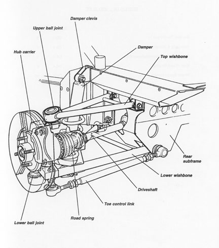

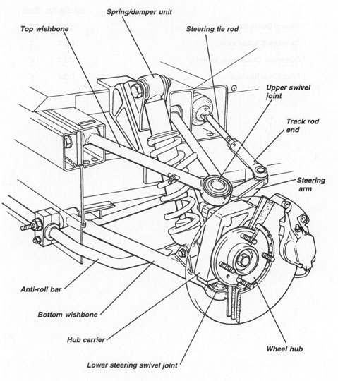

Hi, The guy’s on Seloc are to busy chatting about Thai ladyboy’s and best ass contests so hope you guy’s can help. Shouldn’t take longer than 2min if you have your suspension at hand for the winter. I wanna calculate which spring rates to go with before ordering new �hlins.
I’m interested in the spring ratio’s of the Exige. Could anybody help me measure the following on the FRONT and REAR.
A: Lower control arm - Lateral distance outer ball joint to the virtual line between the 2 inner bushings.
B: Lower control arm - Lateral distance shock absorber mounting to the virtual line between the 2 inner bushings.
C: Wheel carrier: Vertical distance between the center of the upper and lower control arm balljoint.
D: Wheel carrier: Approximate lateral distance between lower balljoint and the middle of the tire contact patch. (This could be Exige S1 specific)
E: Mounting angle of the shock absorber when at standing height.
F: Mounting angle upper control arm.
G: Mounting angle lower control arm.
