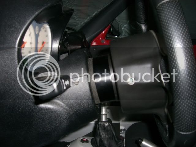

At the end of the week I’ll try to fit this on the OEM airbag steering wheel. Yvo thought it should work !
Well, here’s what I want. Apparantly it can be done. I’ll try to get it done on friday…
ok, so the spacer is fitted. the back of the steering wheel needed just a little shaving so that the spacer would fit, but with long bolts, everything went on quite easily (so my mechanic said). Even with a 3cm spacer, there is some slack left on the wires of the airbag. 4cm would be maximum.
