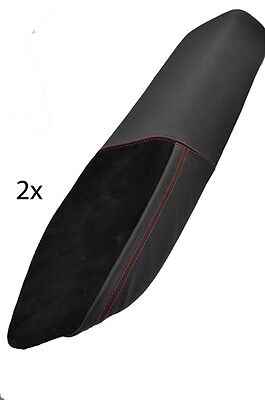

Sill covers
Anybody used these covers??
Mine need a refresh and these could do the job.

These are only covers, so you need to get your old covers removed and fit these without messing them up …
From experience, the material is really important on the bit your bum always rubs on, the black section and usually the corner of it - I had some recovered but the material wore out always instant and Im sure the suede would also … really needs the tougher original material in that area and well fitted so its not too proud and easy damaged …

Andy is the Carbon look material used in some seat panels suitable? otherwise guess it has to be leather.
it was the Carbon material that wore out - the original material is like a canvas, its also used on some of teh seat - not sure the name of it - but I would only use this or similar wear resitant stuff - IMHO …

Andy was it Keprotec that wore out? Their website makes it look like the stuff used on the wear sections,of seats.
If so maybe its not really so tough and the original hooding would be best
The alcantara bit where feet scuf the cover is pretty worn and looks as if its been replaced more than once.
Would leather for the bum bit stretch and look pretty poor ?
