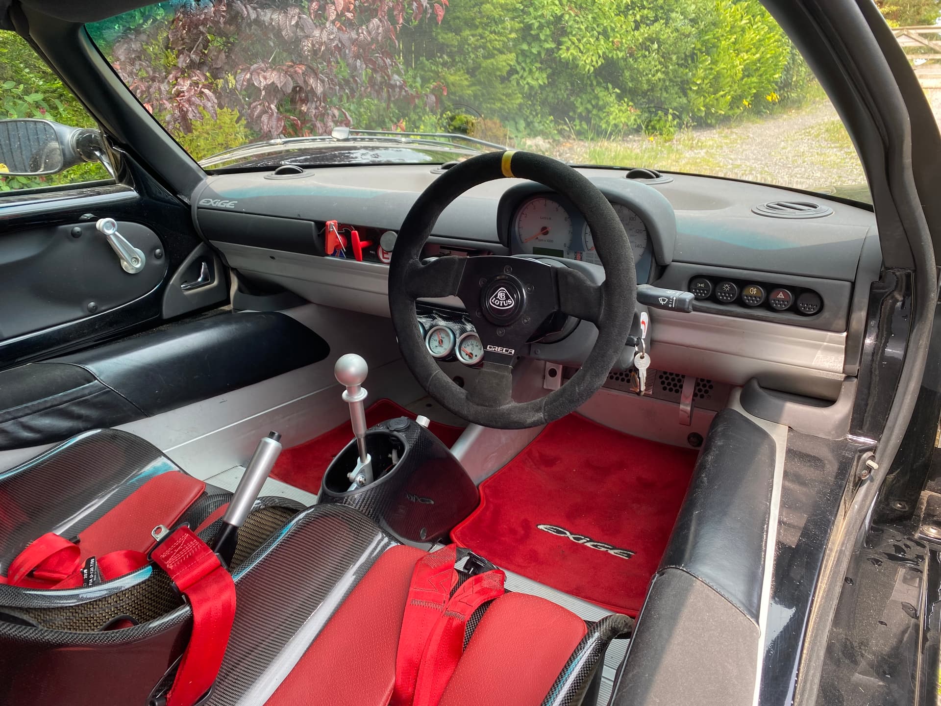

Next up the removable steering wheel and new (old) red matts.
Starting to feel like ‘my car’ now

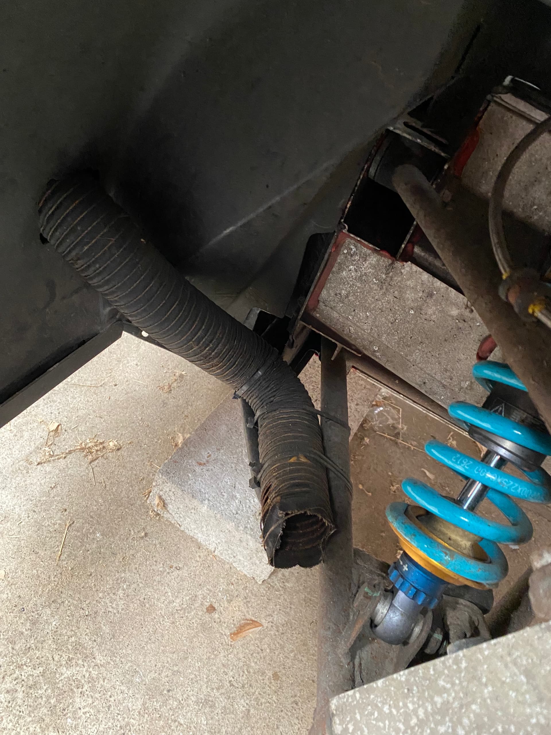

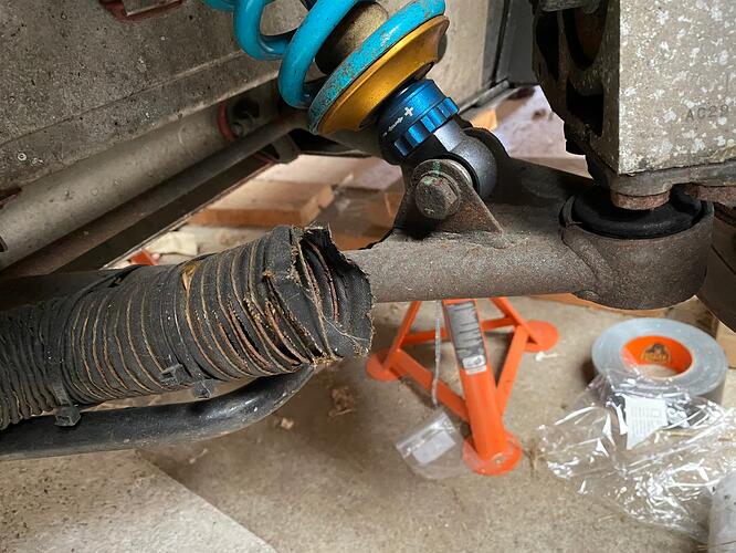

Next up is to replace some ‘not so nice’ and pretty aged front brake cooling ducts. A couple of pictures of what lies beneath..

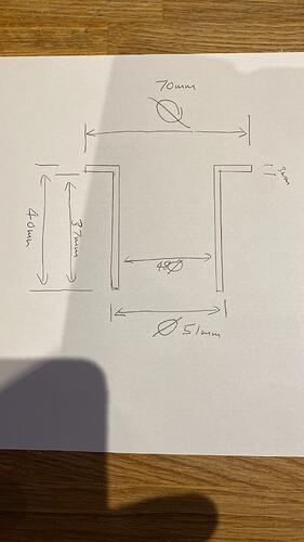

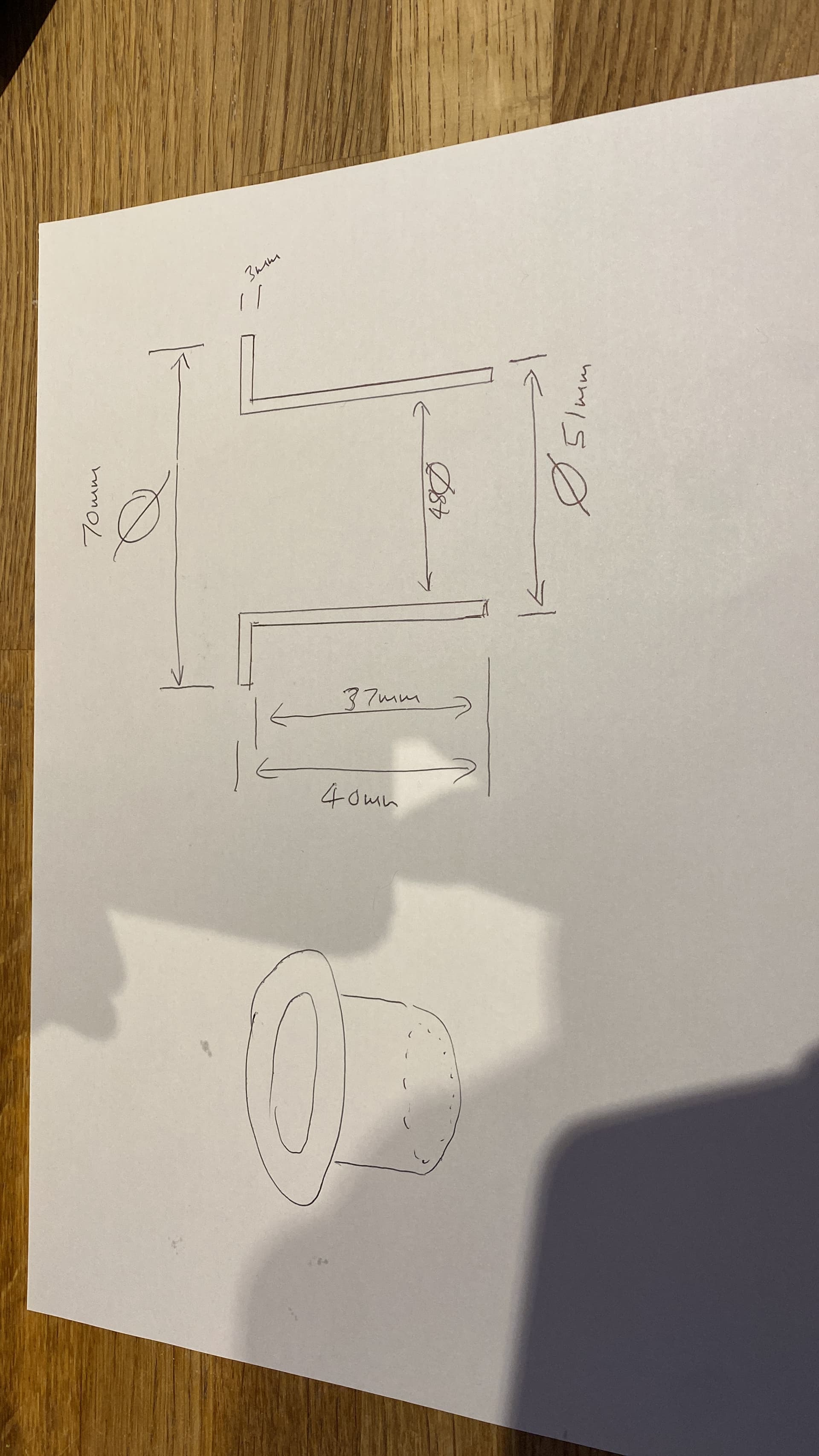

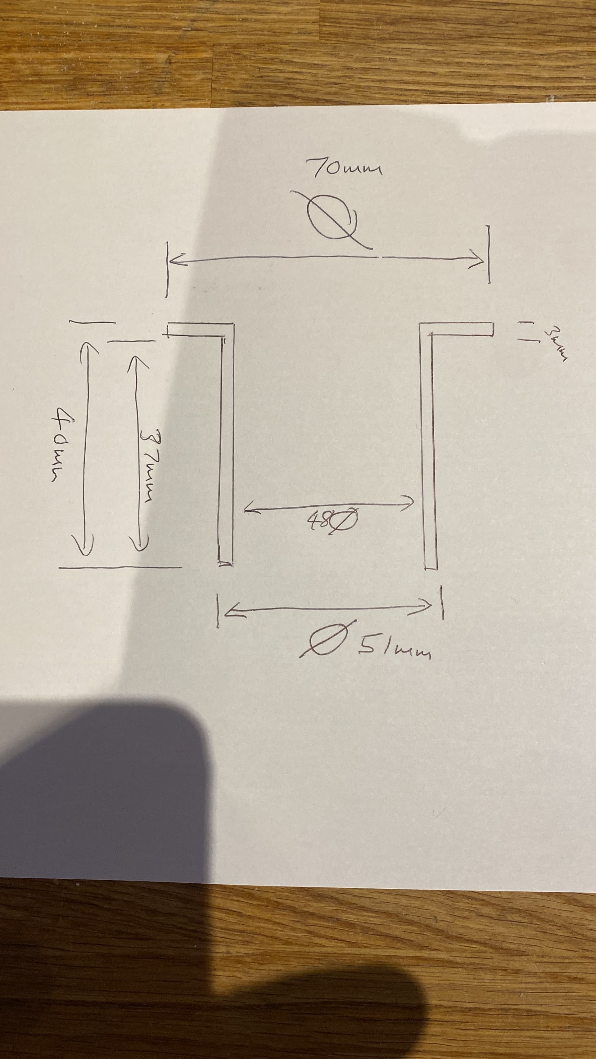

To properly attach them to the inside of the front clam, I’m making some 3D printed ‘top hats’. Rough drawing below
Will post when made and fitted
Must be nice to sit in the car! Looks really good interior wise
