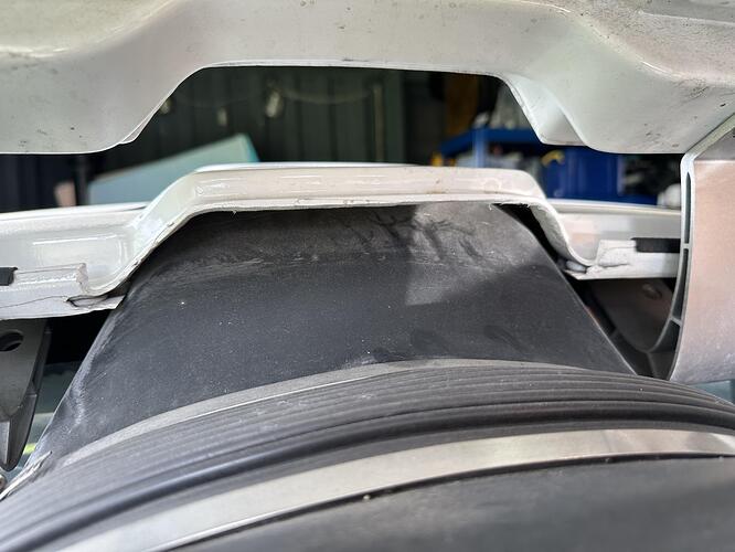

The repair (round the rear light on the right) has flattened some of the lines too which I can see and feel.
So my question is, should I try source a replacement clam or would it be feasible for a good fibreglass body shop to be able to rebuild the lines?

I’ve attached some pictures of the flattened lines (right side, left for comparison) and some rough parts of the clam just in case this helps. If no idea if the rough bits are genuine / appear over time or if it points to an after market clam. I’ve also attached a picture of the mount holes under carpet.
It’s rather difficult to redo blurry lines.
So I would go for a new or nearly new clam.
As for the accusump holes, they are usually not in a standard clam.
So it could be an original item in your clam. However it doesn’t make sense that Lotus would make a type specific rear clam, just for the accusump.
I think they simply drill them in the correct place. (Which you could do in another clam)
