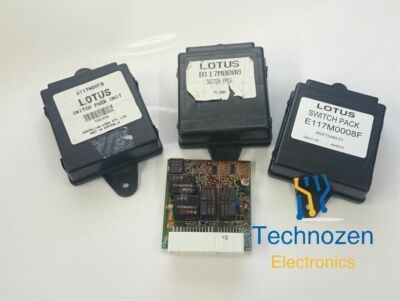

Sounds very much like a switch pack module.
Cheers Andy, will look into that
