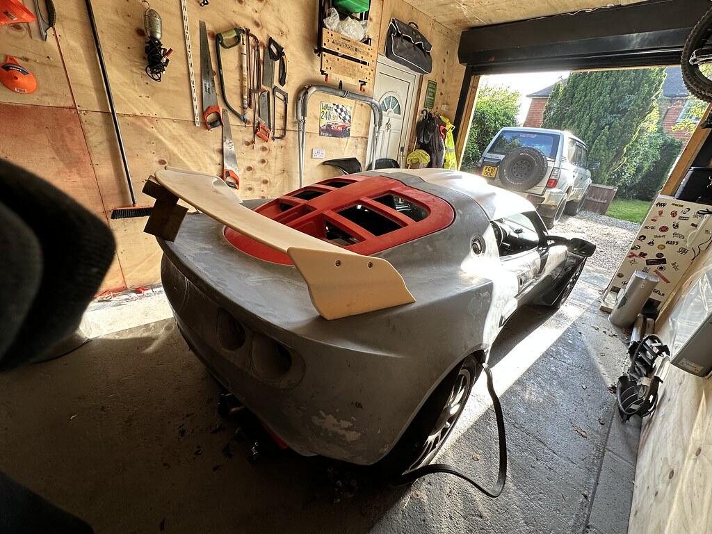

UPDATE
So following the last post, I have almost sourced everything needed to complete the Exige conversion and have started to make progress.
Firstly a 2010 rear spoiler was purchased:
Imgur
I removed the Elise clam for the final time:
Imgur
A 2010 long roof scoop hardtop and rear bootlid purchased from Jon Seal, these were then mounted to the car
Imgur
Imgur
This is about where it is at the moment. Next step is to start the process of sanding it all and fettling the panel gaps.
