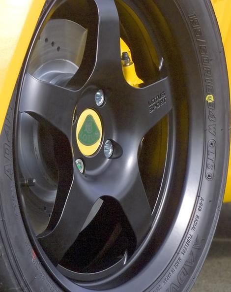

The standard spider alloys whether black or silver are not forged. The forged ones are the double spoked wheels. These are generally back, but you can get them in silver as well - you can get/see the silver ones at the Hanger111 web site.
Didn’t the 240R come standard with the 5-spoke forged wheels?
[image]http://wiki.seloc.org/images/b/bf/240r.jpg[/image]
[image]> http://wiki.seloc.org/images/b/bf/240r.jpg> [/image]
240R had the 5 spoke forged wheels as std, but the 240 Cup just had the standard spider wheels.

Yep the UK cup car came with the standard wheels in silver rather than black, although the Australian cup came with forged wheels…
