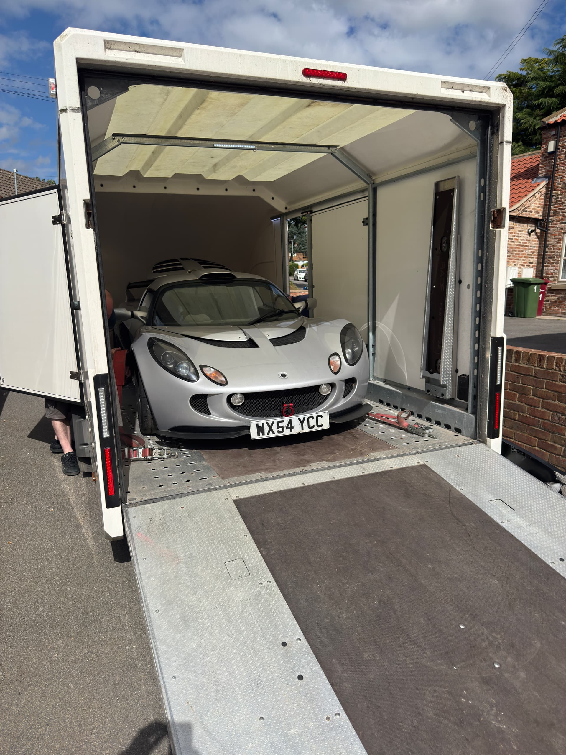

Off the car goes to SeriouslyLotus and parked the cup in the garage while it’s away.

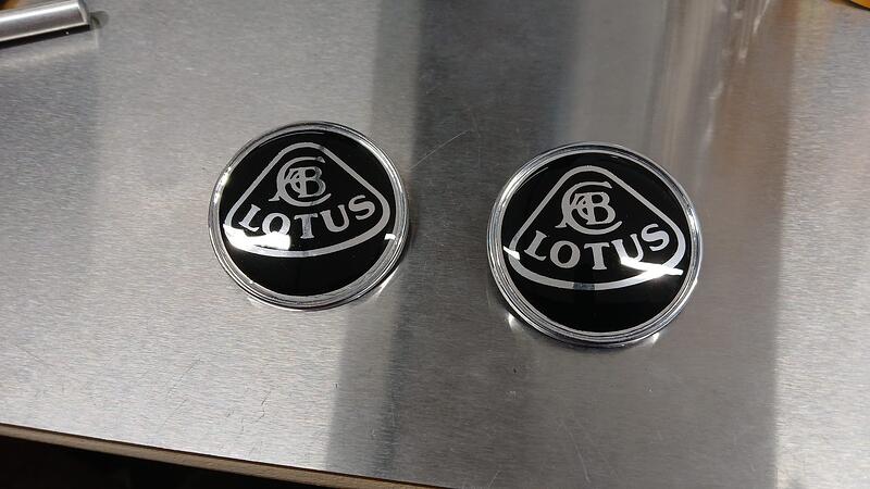

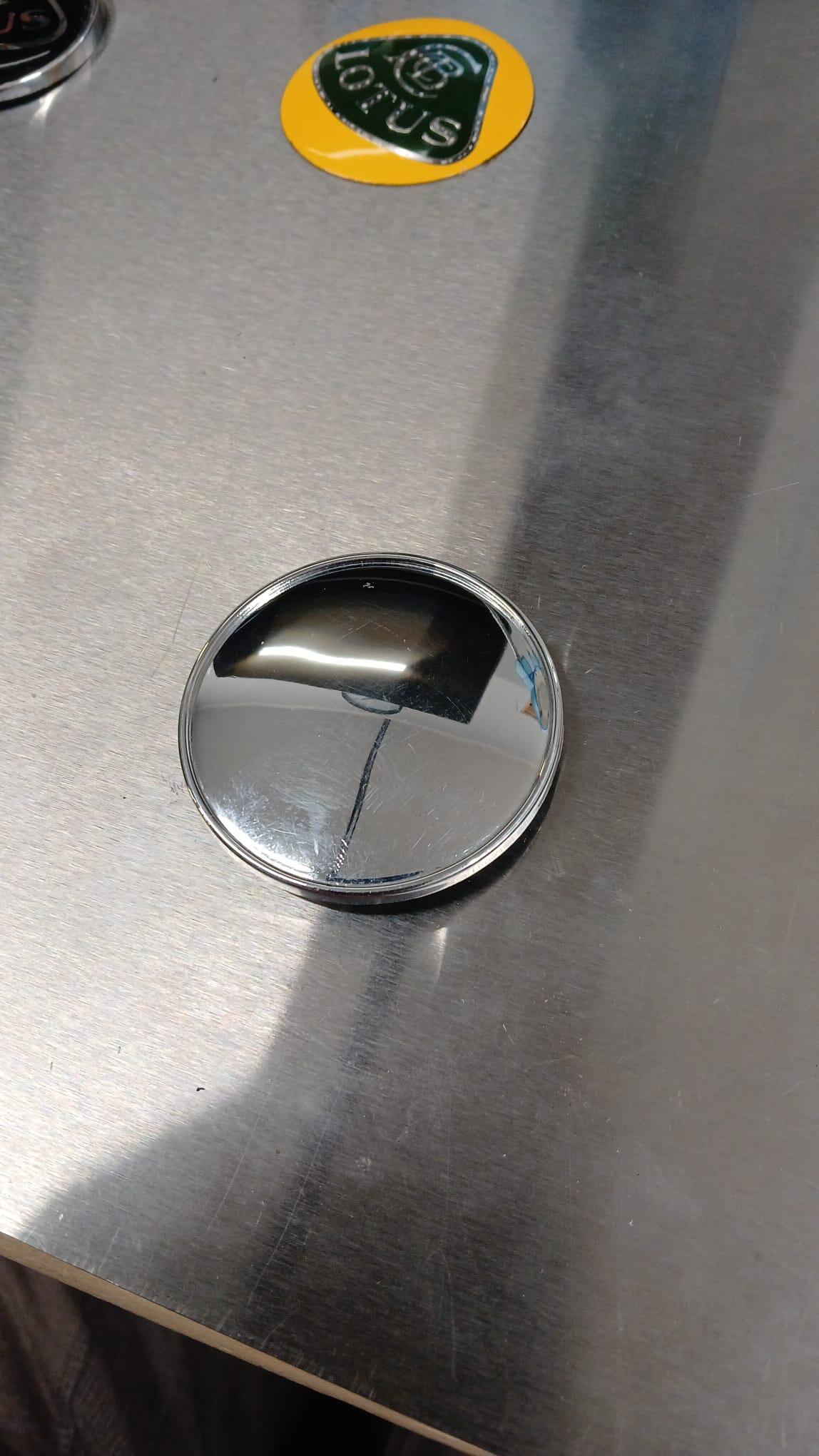

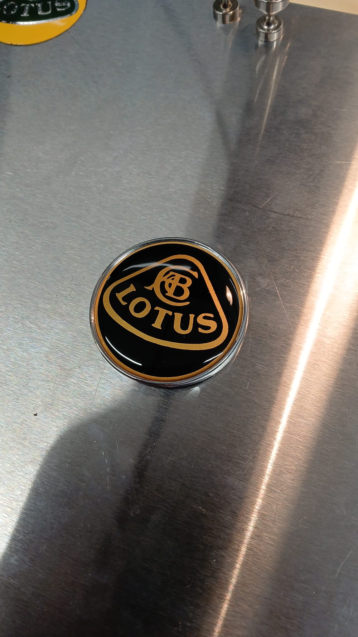

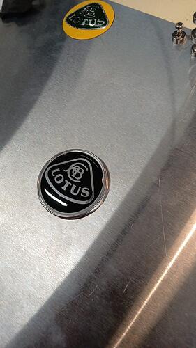

Whilst my exige is away at SeriouslyLotus I have had my badged refurbished. It appears multiple style are available! The quality looks incredible!
