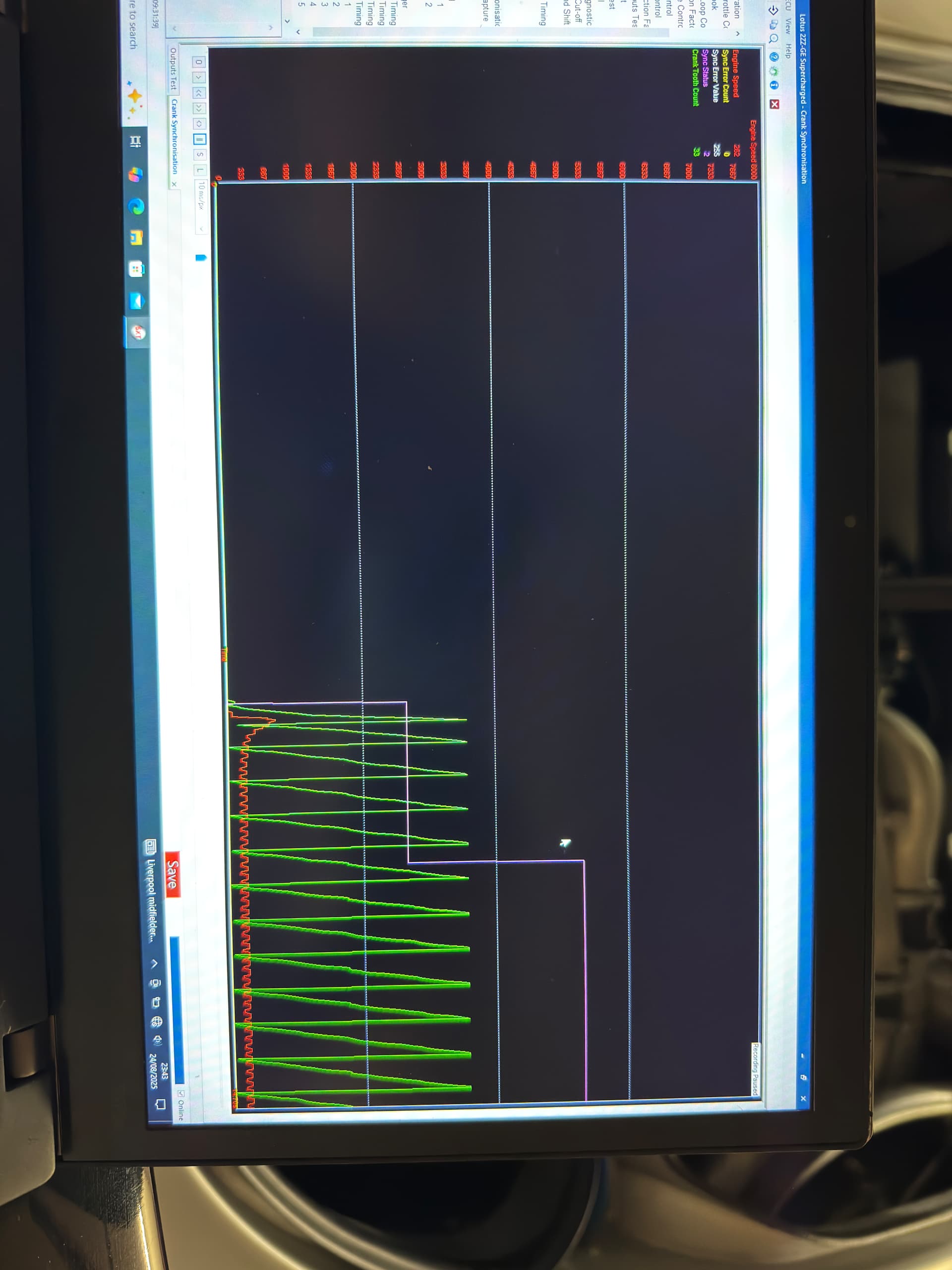

Suspicious are now pointing to MRFU/Immo. I have done a test using the crank sensor and it appears to be reading correctly in SXTune.

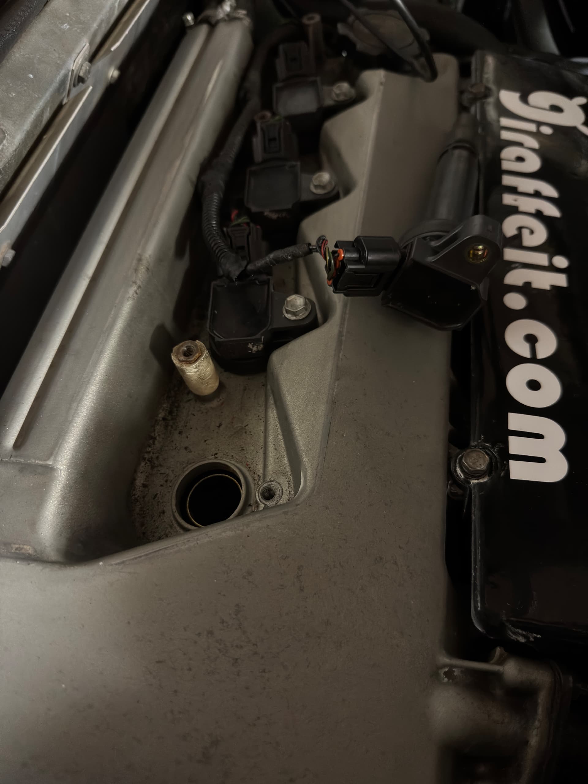

I had a 46 year old moment and decided it’s now the MAP Sensor. My idle has been bouncing a little recently. I’m car won’t start properly. Got to be that.
I unplugged it and it wanted to start. Sat in the car and gave it some throttle and voila. Started up. Ran like a bag of spanner’s , but ran all the same
​Turned off the car and repeated it. Runs.
Plug the MAP sensor back in and it runs even worse.
I’ll purchase a new genuine sensor..
Weirdly the ECU appears to be detecting the pressure. However it only runs when unplugged initially and then lumpy when plugged in.

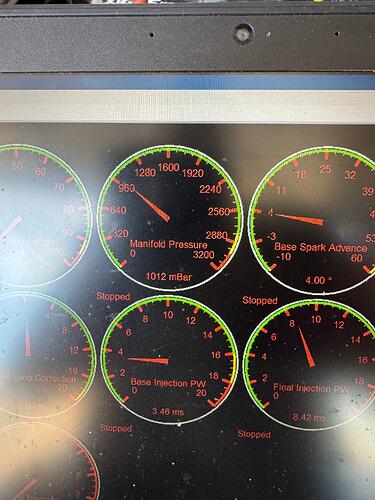

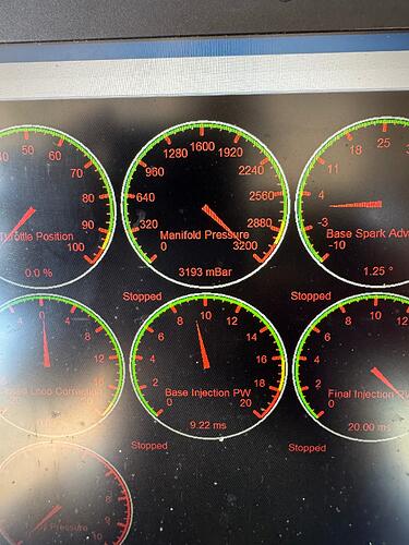

3193 mBar is very, very high. What does it read with just ignition on?
That’s unplugged my good man.
Ignition on , connected 1012mbar. Which seems about right
Makes sense, is about where it needs to be.

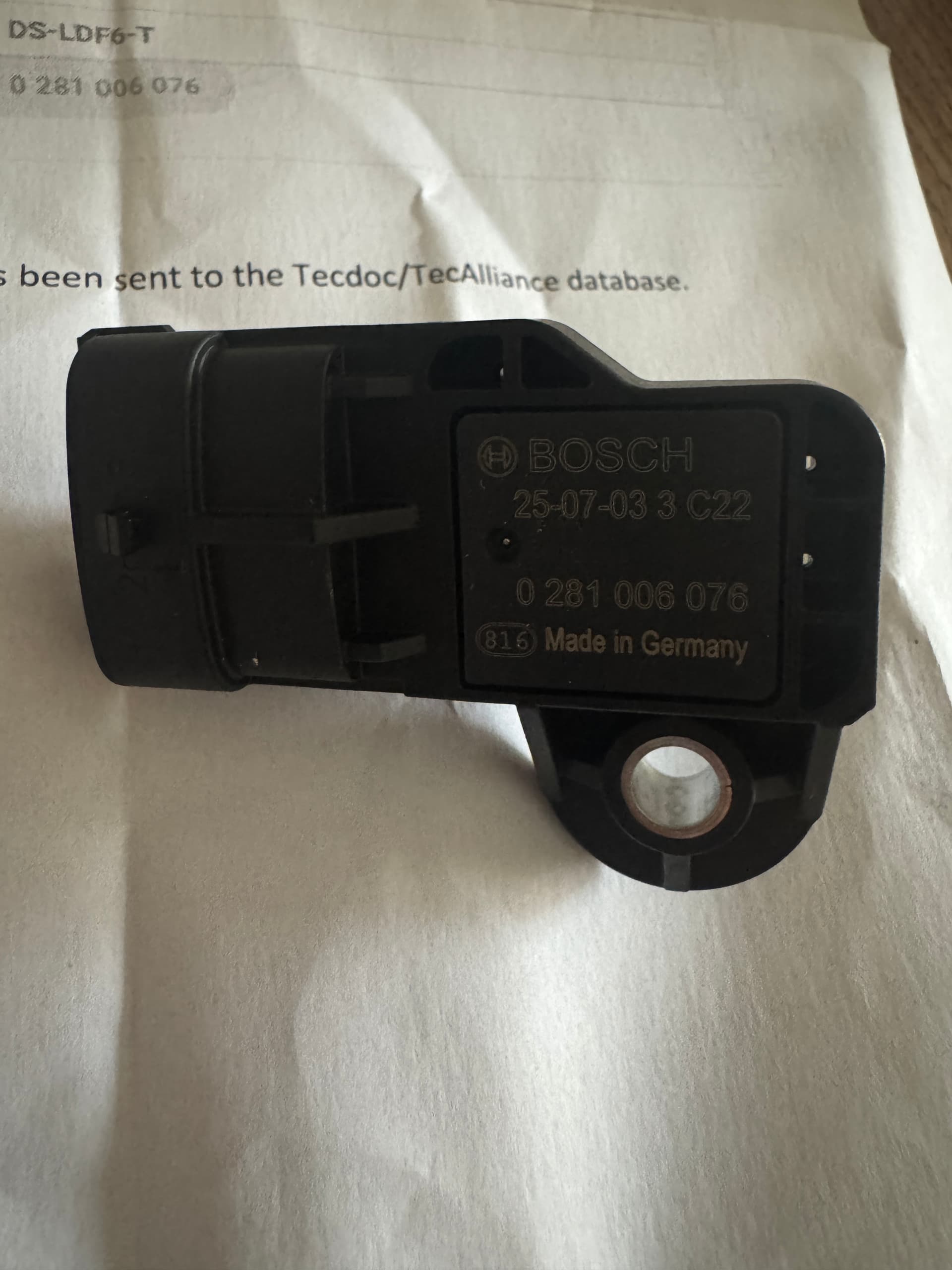

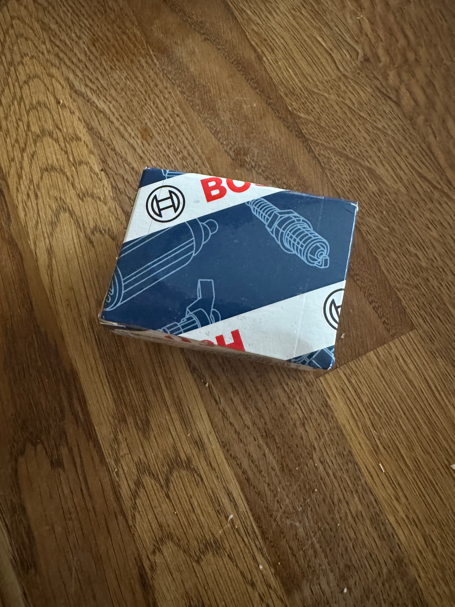

The new sensor has arrived and has been fitted.
The part number has been superseded too.
0281 006 076 for reference.
Not that it has made a blind bit of difference. The car still refuses to start.

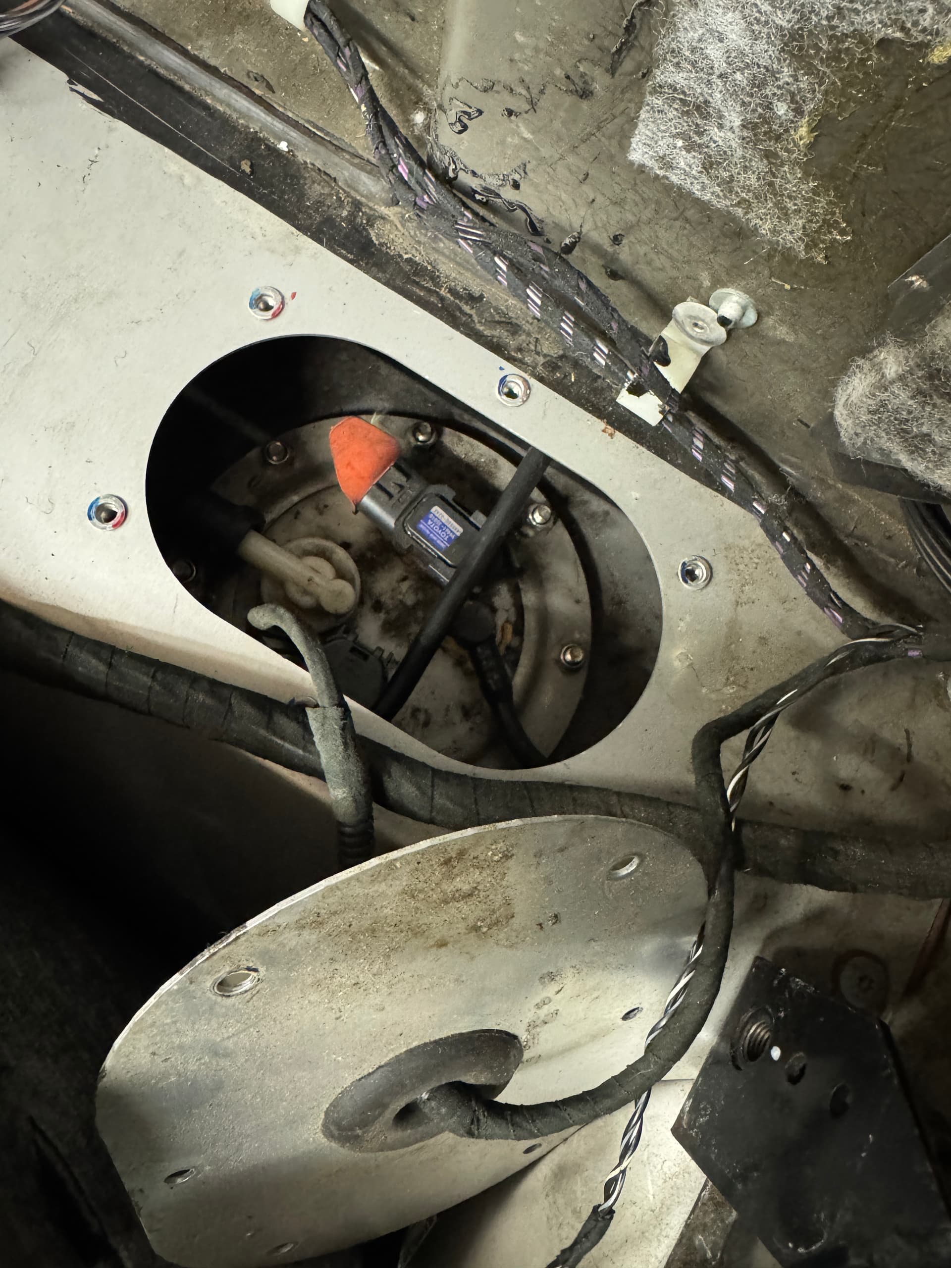

I don’t think it’s the pump.
It’s a PWM pump and found the options to trigger it.

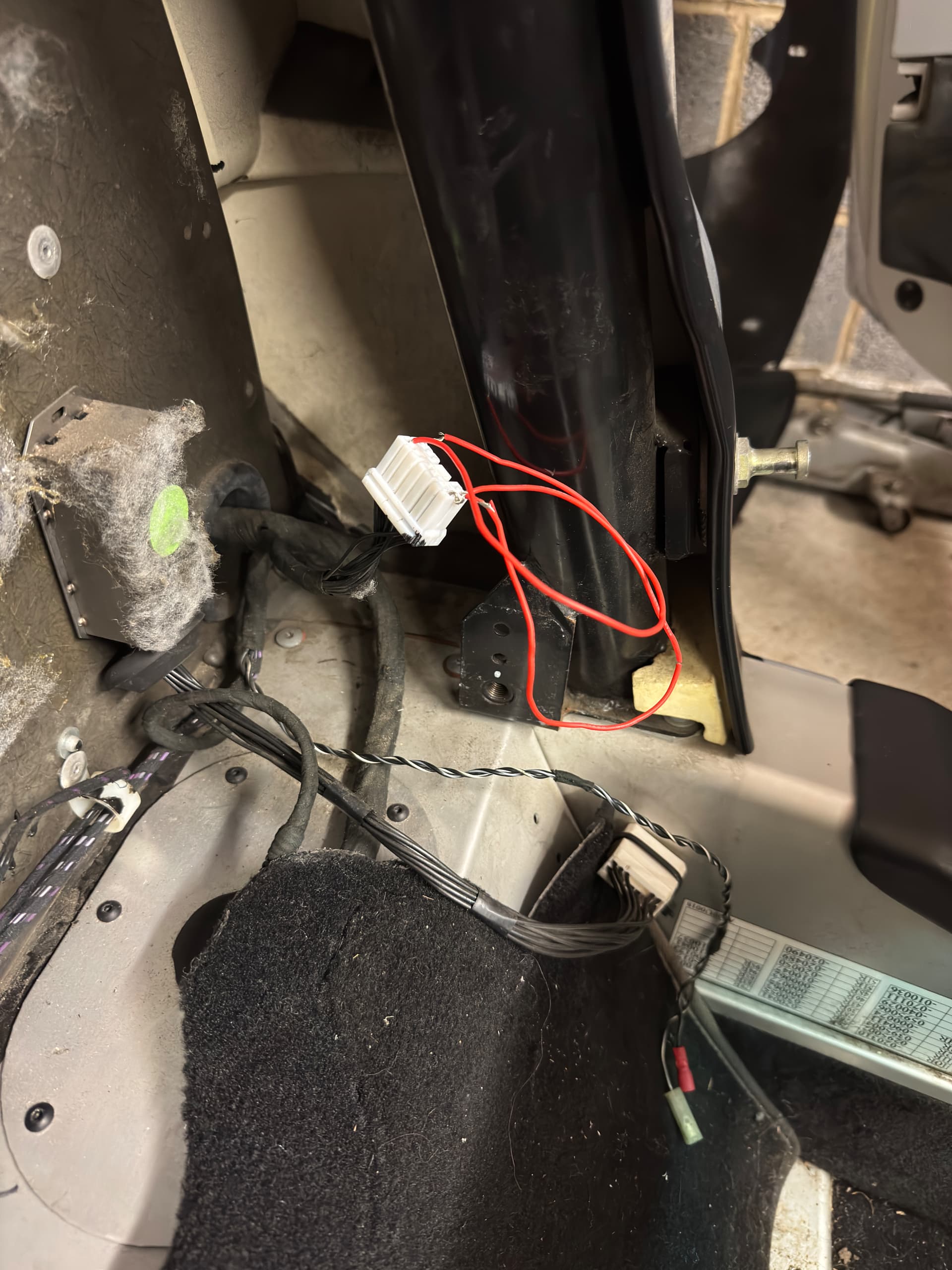

I think it wiring, and specifically relating to the MFRU.

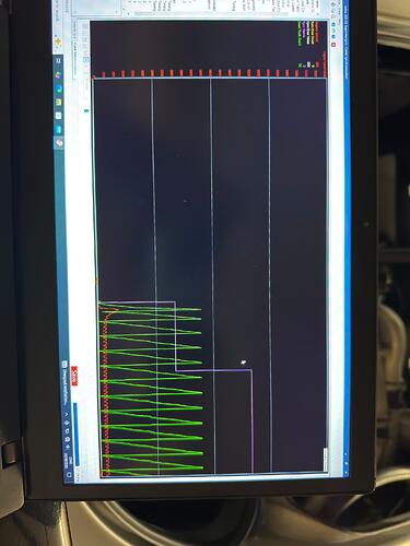

Crank sensor is detecting the crank pulses ok
Cam input 1/2/3/4 input status are being recorded

I have found the option for pulsing the fuel pump and it is a PWM pump. I can change the cycles and power. Its doing its pump thing.
Any 2ZZ car doesn’t have a PWM pump, it’s off or on. The regulator in the pump housing does the err, regulating.
