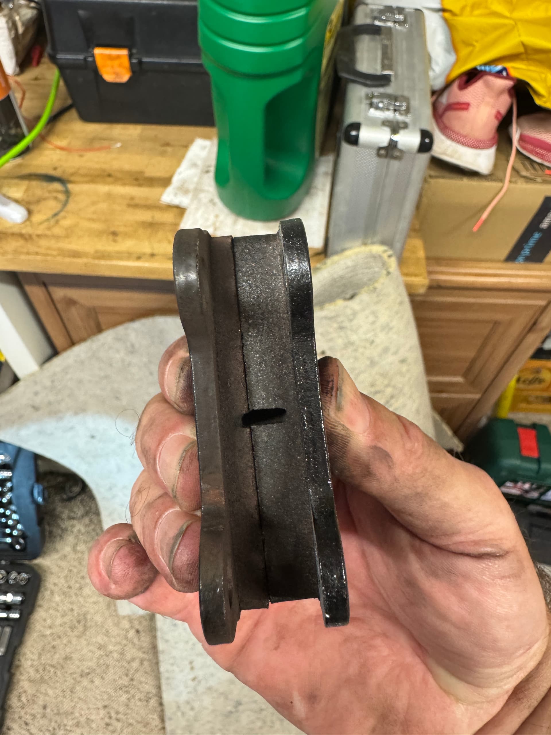

New front and rear pads ordered for the car.
I have been advised that the rears are wearing normally but the nearside front is wearing more than the offside. Looks like a dragging caliper.
I have ordered some brake cleaner, a new toothbrush and will shine the piston to within an inch of its life when changing the pads over.
If it all goes to pieces, Ill get some new front calipers. Its almost the same cost as a refurb!

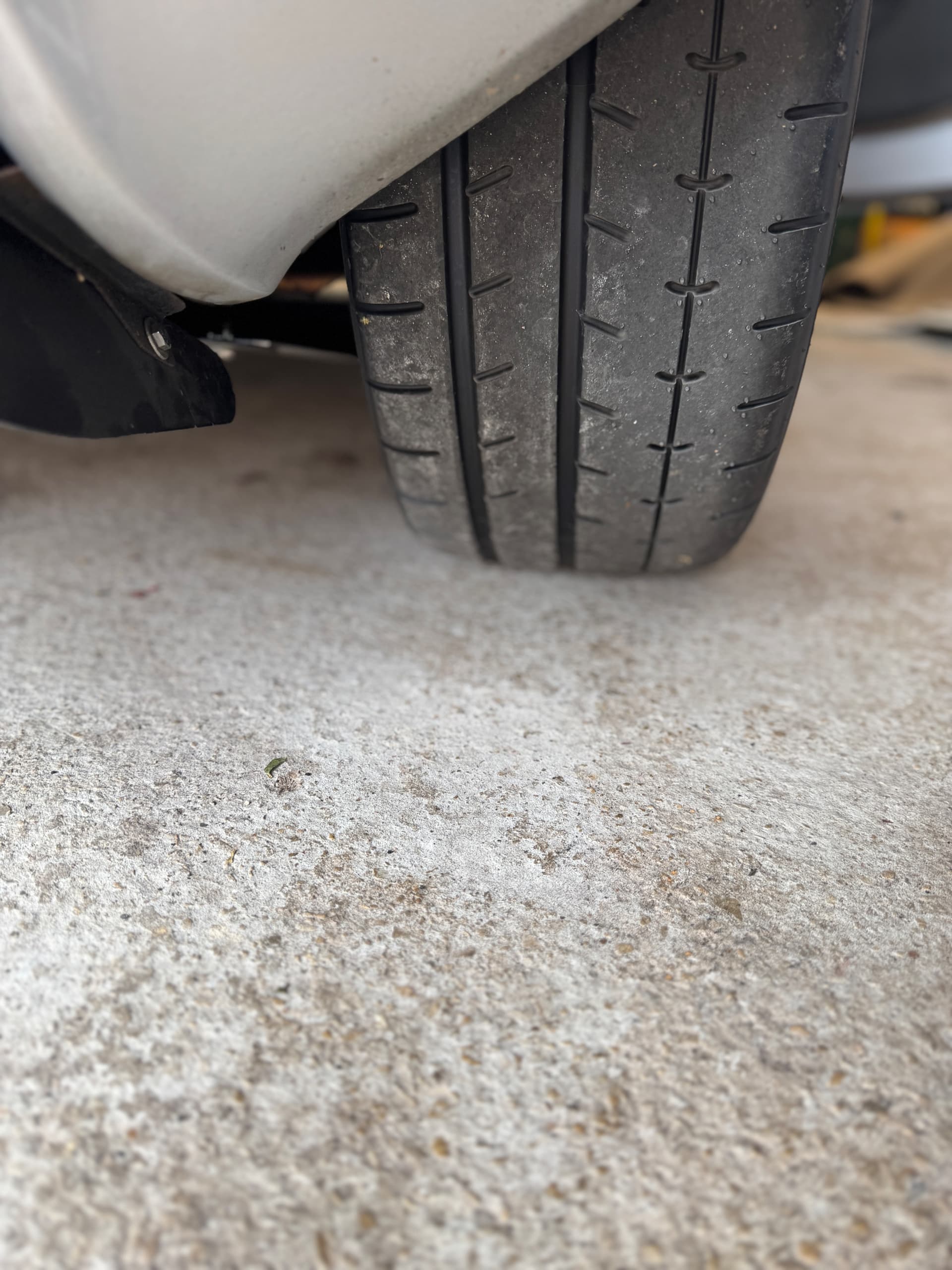

Thats a new set of boots fitted in APR 24.
I need new rear boots.
I have done approx 1500mi in that time

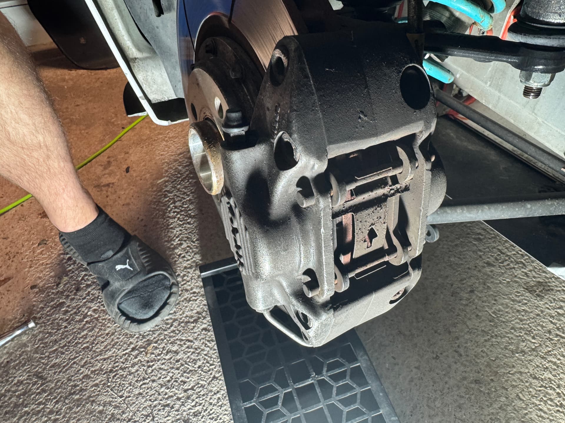

New pads for the front tonight. Not too much drama.
Everything off. Cleaned up with brake cleaner and everything back in again
Full PPE worn whilst working
Used vs New

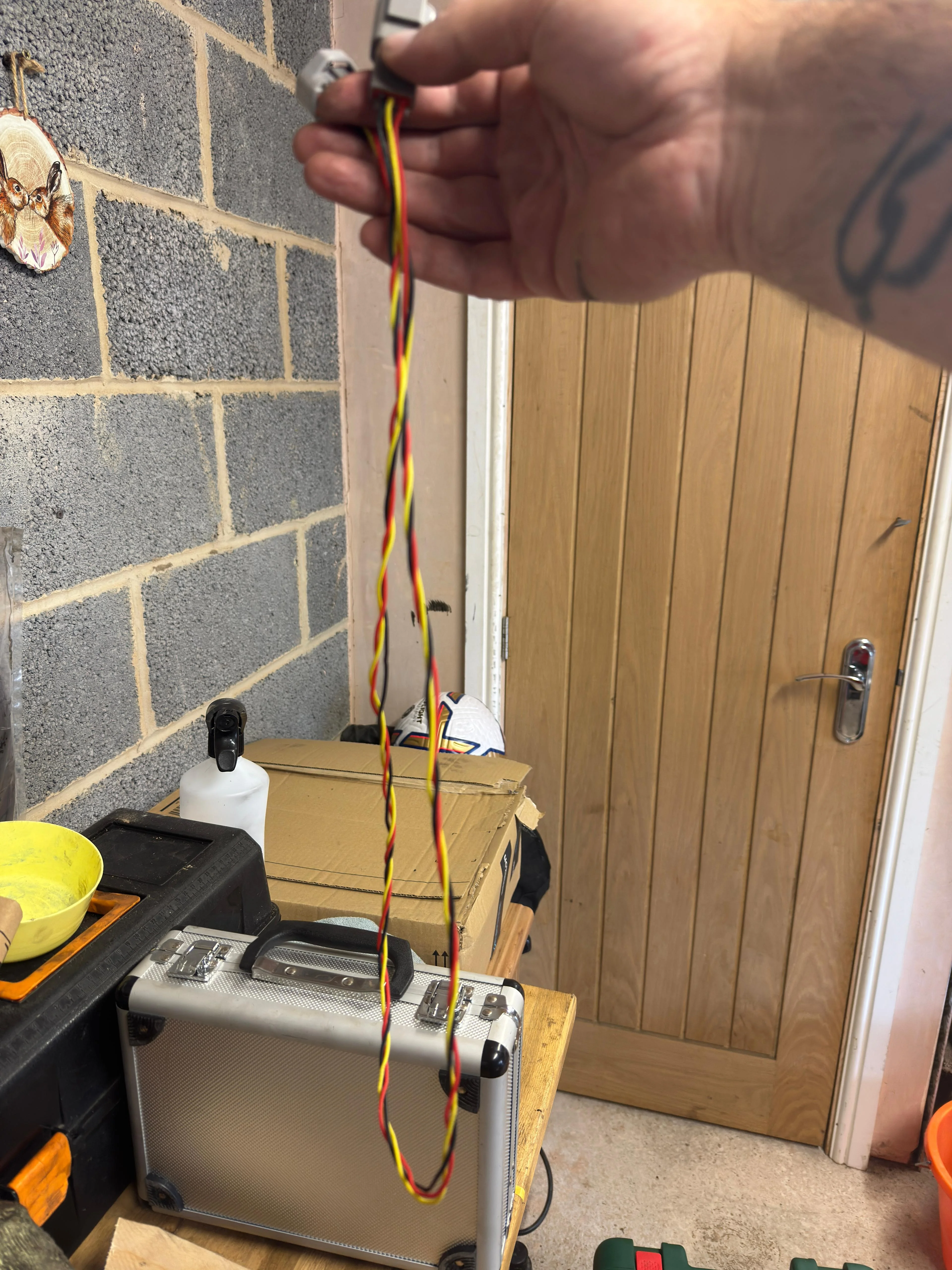

The Lotus idle issue had returned. The plastic connector that connects to the IACV has become intermittent in its ability to stay secure. This meant I had to rewire a new connector. Fairly straightforward job after I dropped about 387 connectors on the garage floor. I suspect I will find a massive stash of them right next to the 10mm sockets I have lost as well
I fitted it and promptly 2 of the 3 connector pins released their wires. FML. Fortunately I had another connector as I had no de-pin tool so made another fly wire up and lost a similar amount of pins again.
This is the remade fly cable.
I have since covered in in tesa tape post testing.
I have also enabled an option in SXTune to auto learn start-up. Sometimes when cold , think coolant below 30degC that car will start then stall. Nursing of the throttle is needed to keep it alive until >30 deg C coolant.
The option appears to have worked after several starts. Quite happy with that.

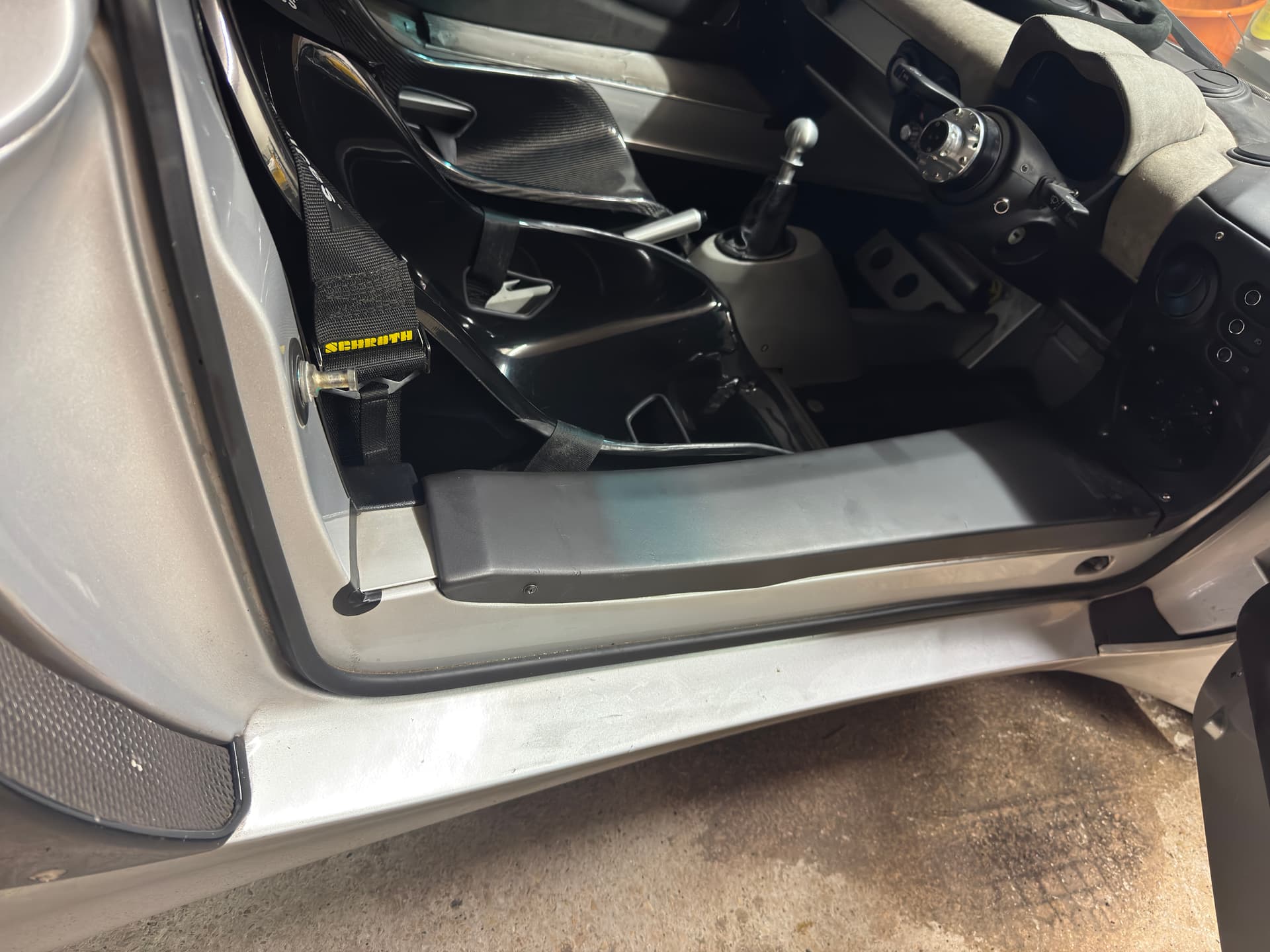

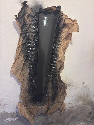

In tonight’s episode of I did a thing : Part 342 Sill covers
My drivers side sill cover had split and was threatening to nip my inner thigh with its plastic jaws everytime I got in and out.

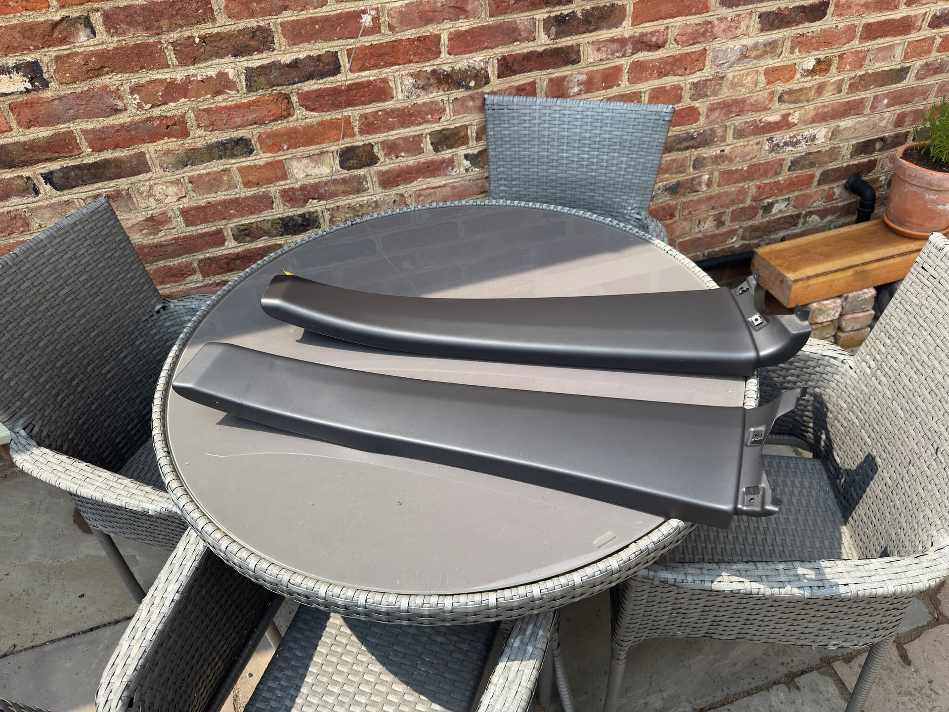

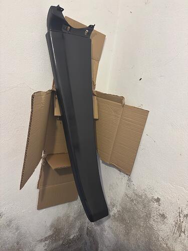

For reasons unknow I failed to get pictures of me removing this part and melting hot metal wire into the crack. Perhaps it was the toxic plastic fumes that came off the metal that caused me to forget. I also removed the wrap that was on the sill covers. It was a carbon wrap and was starting to show its age.
Anyway, the two major cracks are now held together with the metal wire and some filler made up of superglue that’s subsequently sanded down.
Tonight I took them to the spraybooth* and painted them with stove paint. I have no idea how they will turn out but as long as they look 59% as good as before, Ill be happy.
  • garden store.

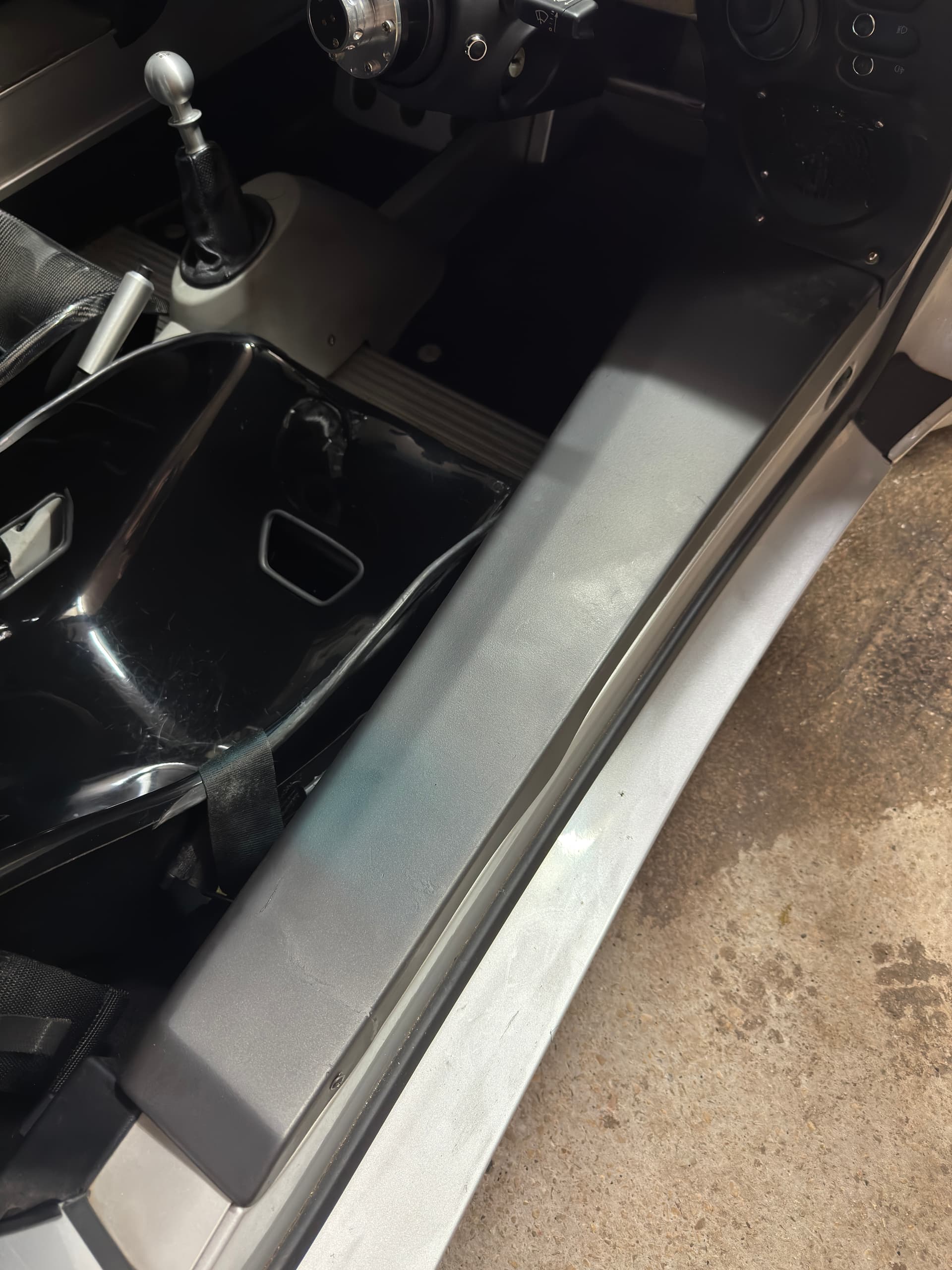

A small update.
The skirts have come out rather well. They arent perfect but they are a heck of a lot better than they were.
Big thanks to @winthattt for the paint pointer. Its almost indistinguishable from the OE colour!
You can see the slight imperfection where I have to repair the crack. I filled it with superglue and sanded it flat. It shows slightly in direct sun, but less so when in the car.

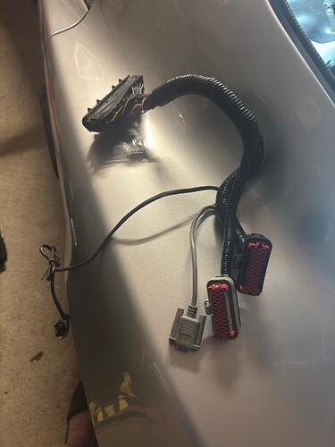

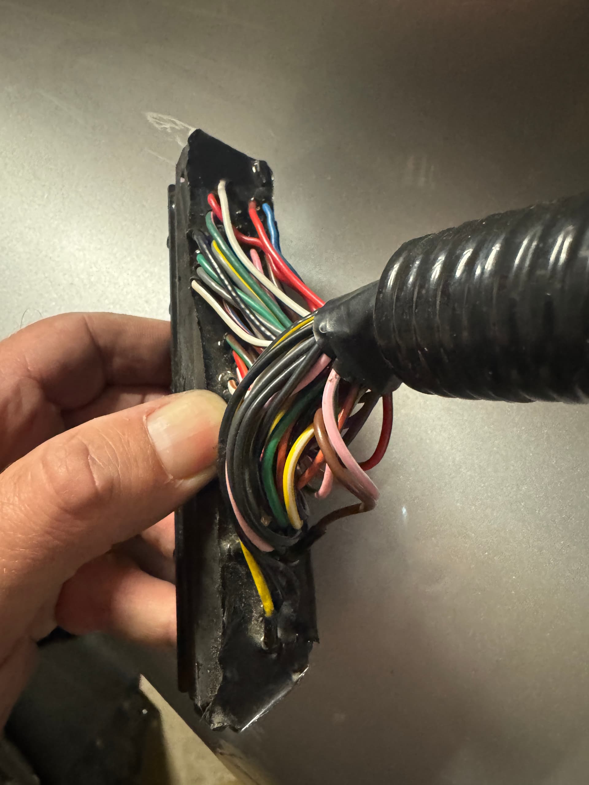

I have had a sporadic return of the car failing to start game that appears to be caused by the SCS delta loom to Lotus loom adapter moving ever so slighty. If I squeeze the adapter that goes into the ECU then car car starts first time , every time. Until it doesnt. This had been about 2 years. But then twice in 2 weeks.
I have since removed the ECU and adapter and noted a few things
  1. Its a bit rough - functional but rough
  2. A pin is missing that runs the coolant pump if temps get over X many deg C
I have been following Noon engineering on their socials for a while ( Insta : https://www.instagram.com/noon.engineering/ FB : Noon Engineering | Runcorn ) and know that Jaik also owns a Loltus ( amongst other things ). A brief chat ensued and the loom is being remade with motorsport grade Reychem wire and heatshrink, new connectors and as light and flexible as can be. I have also requested the comms connection ( RS232 ) is extended as its too short really at present as I have to fish around in the engine bay to find it
Old lead
TBC when the part arrives. No rush for it though ..
