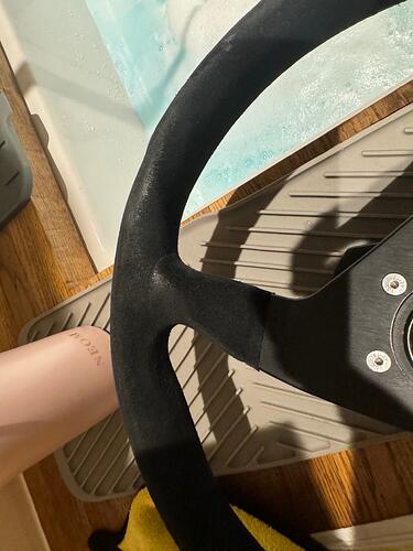

In tonights episode of " I did a thing " I cleaned my steering wheel.
It wasnt truly manky but I had noticed a few shiny spots.
As ever I did 4.3million hours of youtube research and followed a Ruskiweldfab video of simply add fairly liquid to water and use a microfibre cloth to clean. Then rinse with clean water .
Before :
and after
Whilst its not perfect, it is a heck of a lot better
Yep I do the same every year or so. Always amazes me how well they come up.
Mine currently looks like the wheel of a 40 year old outdoor gokart
I have one particular flatspot that I am ok with but it needs some, erm something.
Its shiny.
It is a case of TADTS or can I revert it somehow?
