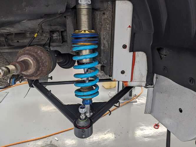

Suspension is back!

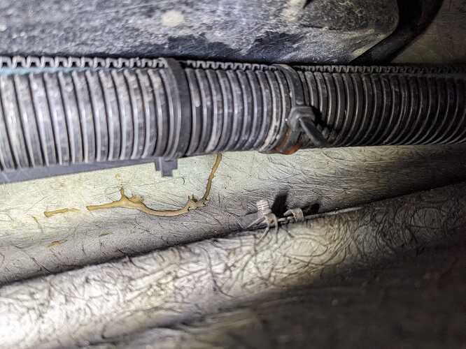

Minor leak. Best fix…
Dave has been keeping me updated on the issues.
  1. Rad is leaking at both ends
  2. Potential leaking on the chargecooler rad.
Best get these replaced :slight_smile:
Fortunately @seriouslylotus have these on the shelf ready to fit

Just had a major update from the gents over at SeriouslyLotus
Braking areas
Suspension areas
And I am now converted to the later style ARB
I am delighted with the progress and the results. I dont want to take the car out once it arrives back at Bond Towers.
