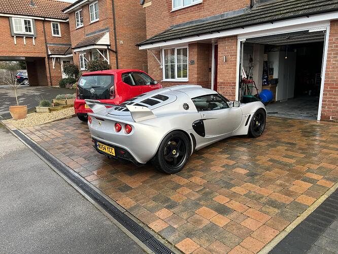

Service done :+1:
Cleaning done :+1:
I’m liking your exhaust more every time I see it! :slight_smile:

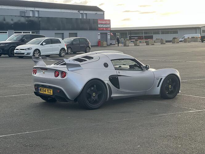

What a stupendously good day at Donington Park on a baltic weathered but dry trackday.
Did 86mi on track.
Used 56l of fuel.
Todays mileage 186mi.
By the powers that be on the internet thats a cool 15.1mpg
The new a052 are freakishly grippy. Whilst I appreciate I was running used AD08R these gripped where I had no right to grip. Follow a McLaren 650 round the track? Yep. Faster than them in the twisties? Yep …
Absolutely blown away by the cars performance. I never found it lacking in any way at all. Only the driver was the weak link.
Heard some funny grumblings from the front end - though pad deposits but it appears I have eaten a majority of my arch liners! Ooops!
