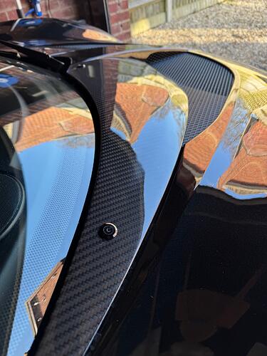

With that done, it was time to fit the carbon side pods and front access panels. I didn’t buy them for the weight saving, but am pleasantly surprised at how much lighter they are, and they pick up nicely on the carbon mirrors on the car!
