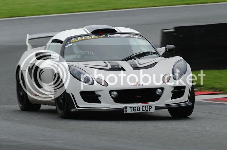

Pics - I think
If you look closely you can see my legendary shiny white race suit :smiley: :smiley: :smiley:

:sunglasses: looking good Chris…loving the stickers mate :smiley:
Sorry cany be any help with the problem but have to say your car looks superb, was gonna come down to Oulton for a watch too as was near by on a drive out, wish i had now.
