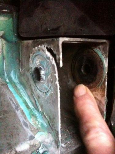

It’s a different “problem”. The latest is about corroding suspension mounts, which are glued to the chassis. Officially, not repairable, but unofficially they can be. I’ve not read the story since yesterday, when it was still on 1 page. Will try & catch up on comments later.
I think that picture is really odd, if it failed due to be corroded through then surely it would have bent the other side to match? As it hasn’t why is it bent?

Perhaps it got bent whilst the bolt was being removed :wink:
External forces at work :wink:
Blue Glue! :smiley:
That does not look too tough for someone (inclu Lotus) to arrive at a repair solution!
An inner sleeve would perhaps work?

That damage looks a bit strange to blame corrosion. I guess the idea is the blame it on corrosion creating a weak-spot for old style physical forces to take its toll. It makes sense.
A good welder should be able to fix that without frying the glue.
In 20 years when lotus makes no more elise frames it will be a fine art to repair the ones that are still around.
