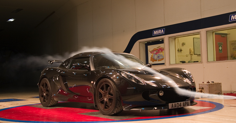

[image]> http://www.exiges.eu/pics/windtunnel3.jpg> [/image]
GREAT shot!
Looking at the airflow over the rear of the car, it is clear that whilst the rear wing is in quite ‘dirty’ and turbulent air, the relative airflow is close to parallel to the fore/aft axis of the car.
I have just got my protractor out (not too bored ) and measured the angle of the S1 rear wing to this fore/aft axis… it seems to be about 23 degrees ‘angle of attack’! This is way over the max lift angle and if so, would actually just be causing lots of induced drag! And if the airflow was modified in a downwards direction over the rear of the car before the wing (as the photo seems to also show) this would only increase this AOA!
Of course this is of the S2, which compared to the perfectly aerodynamic and beautiful S1 is probably a drag bucket
Time for a proper wind tunnel test of the S1 I think… that would be great to set up with MIRA too. I will look into this!
Noticed that EVO say the Zonda produces 2000 kg of downforce… that makes our 100kg seem pathetic really!!
