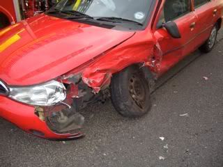

brake upgrade,then head on smash...
Head on smash after brake upgrade today…
After fitting these…
went out to bed them in,when this happened…
The silver car in front of me crossed the white line into the path of the mondeo,had been following her for about a mile and she was all over the roadso i am guessing “suspected” drink driver
Really shook me up to witness,i was going to pull over and call the police when it was safe to.
Needless to say i have’nt bedded in my brakes yet!!
marc.
