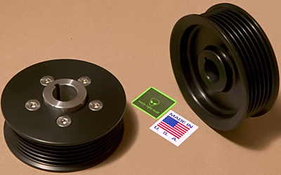

The 211, 270 (cough) map does use a new pully.
Gav
Any idea of the size of the “pulley” they might possibly add when they do the map?
Ade, strnagely enough the lotus sport pdf catalogue doesnt say!
