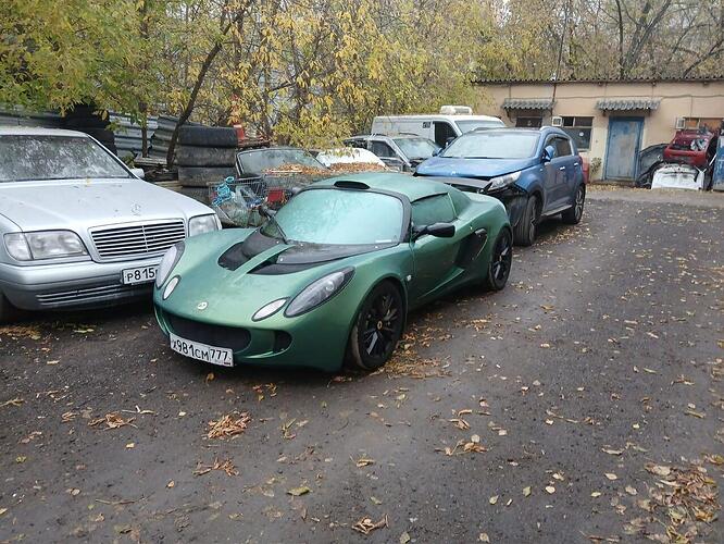

I’ve bought S240 2008, that was abandoned about 5 year, on outside
I’m fully rebuilding it now:

Congrats on your purchase, any photos?
If it’s been abandoned and not worked on for 5 years, I suspect there maybe quite a few items that will need replacing, etc as you move through it.

Some photos:
