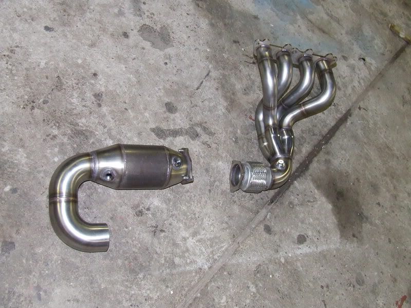

Peak figures:
Before: 216whp, 145lb/ft
After: 241whp, 157lb/ft
25whp gain and 12/ft which is fantastic. Essex Autosport did the mapping and were also surprised at the gains. Seems Jim’s new 4-1 design is worth every penny!

Big improvement - Did yoi have 2bular on before?
What size are the primaries on Jims new 4-1 manifold?
no idea on the primaries. Give Jim a call as I’m sure he’ll tell you the difference between your current and mine. He did smooth out the pipe ends alot from his previous design.
Impressive
No probs…I was just curious if he’s increase the bore size, or it a complete redesign. Mines already a one off (I think) with 4-1 manifold with 2" primaries into 3" system, but this is probably the old design now.

Any chance of some nice piccies please!

The std header/manifold is a piece of junk, barely fit for the n/a motor. For an SC install, it’s a serious block on power. When I first had an Exige S on the dyno, it showed 204bhp. I was first to design a header/manifold that would improve the exhaust flow out of the head. 12-15% gains were achieved. With various mods - re-flashes, smaller pulleys, intercoolers, etc etc the power outputs have been climbing steadily.
So, it was time to have another look at the 4-1.
Steve’s install was a good opportunity - same car, same dyno, same day, same operator. Most of the variables removed. I was interested in the CHANGE because that would have been down solely to the header/manifold.
Worked very well, very pleased.

[quote=blacktoy]piccies of it fitted will be on the way tomorrow. In the meantime:
Pic of my 2bular (2" primaries) to comapre…

Hi Jim. I’d be interested to know how much difference you think there is between your original 4-1 (as fitted to my car) and the redesigned new one - I need to work out the cost-benefit calculation!
I agree the OEM one is crap. Big improvement when I stuck your manifiold on.
