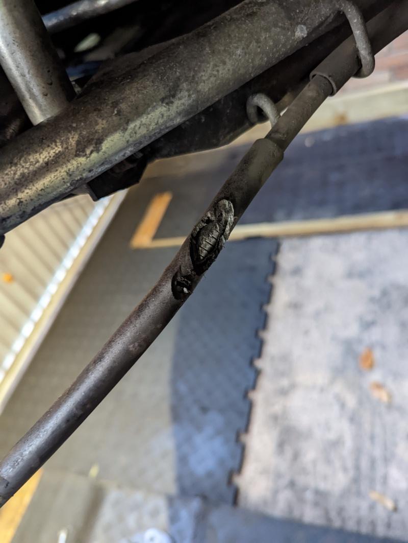

With all four bearings finally replaced, it was one last inspection under which I found a couple more issues…
  1. Handbrake cable fouling on the OSR wheel. Had this before with my Elise, just one of those things I think. They’re inexpensive to replace but for now it’s just lubed and taped up to stop it rusting.
